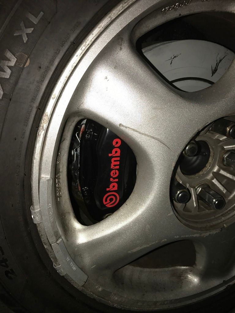

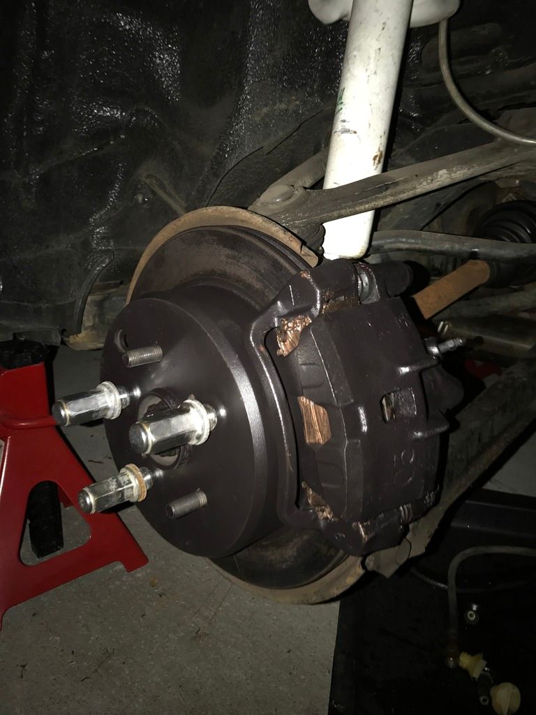

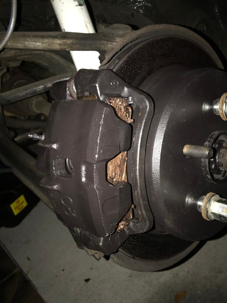

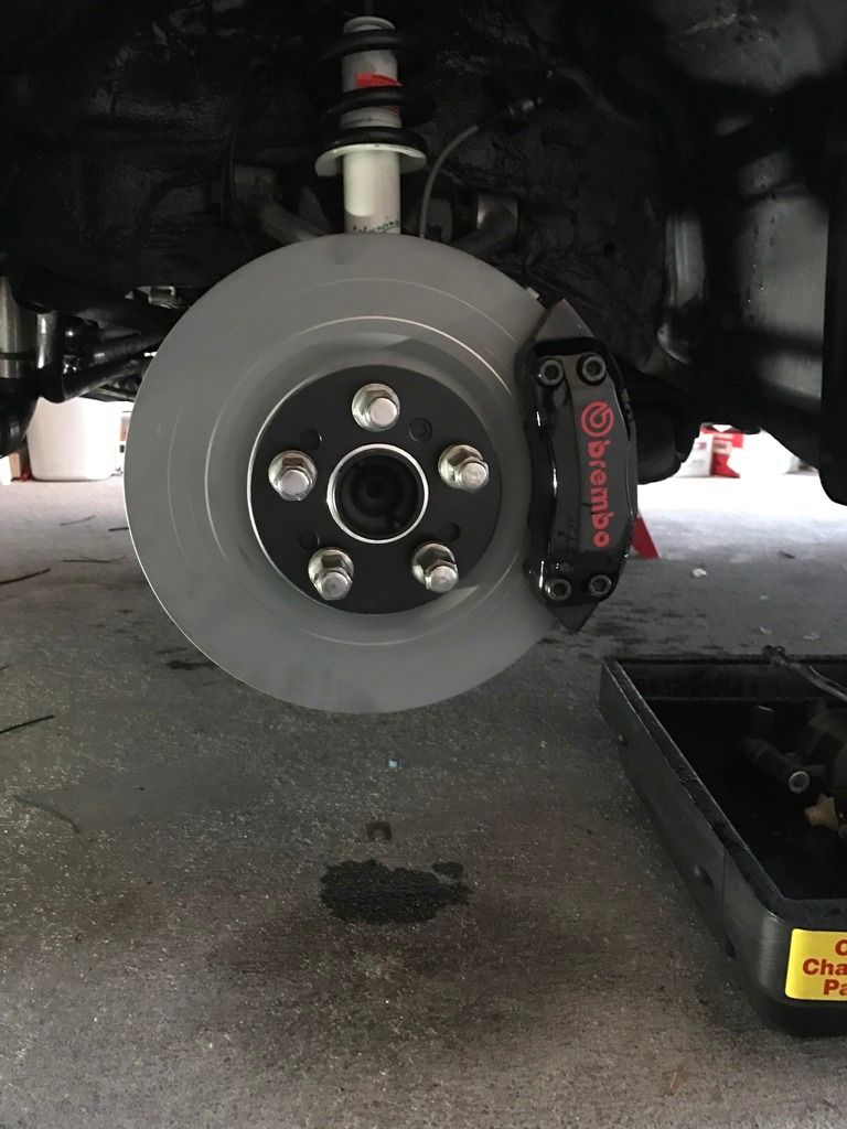

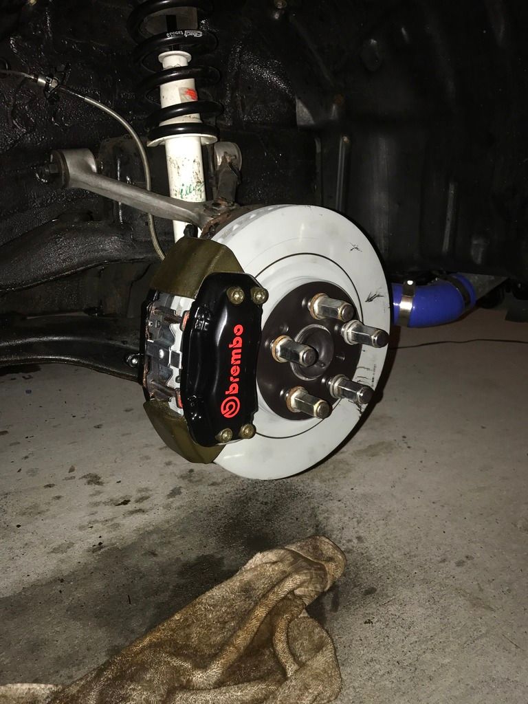

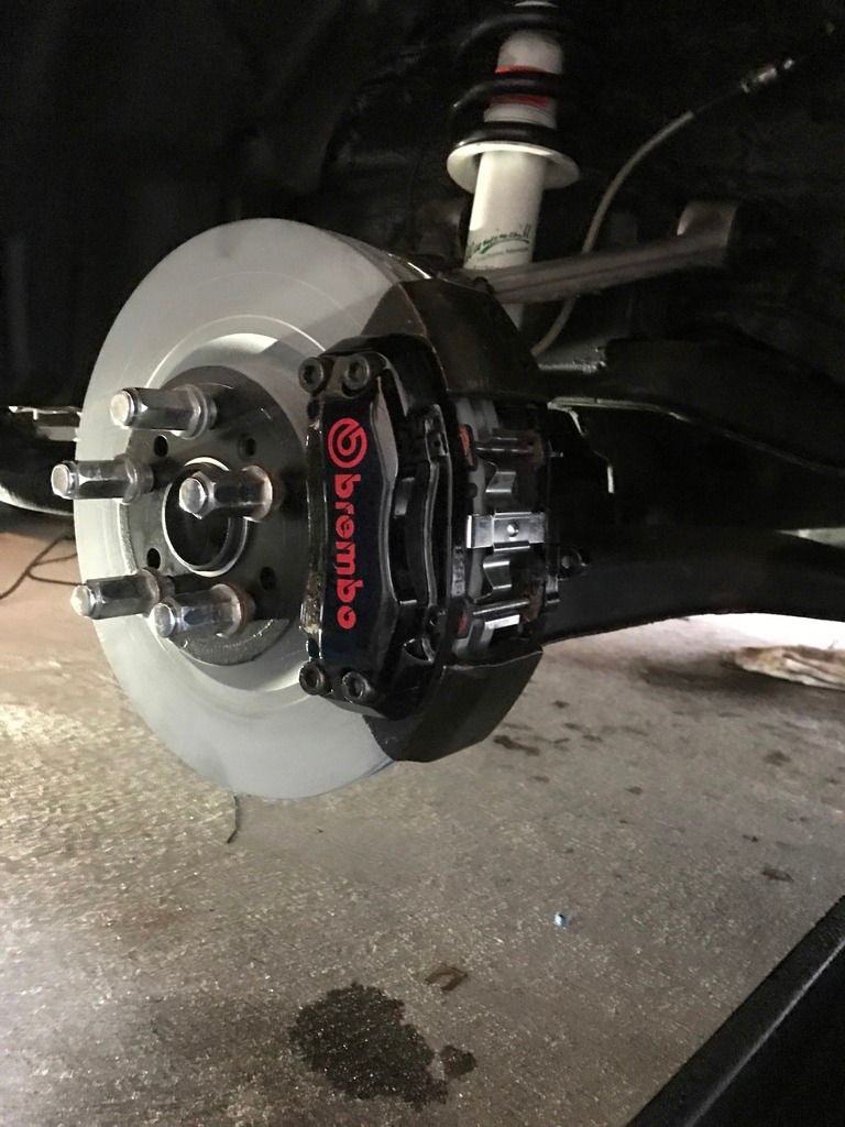

I finally finished up the brakes. I wasn't going into the New Year with the brakes still apart. They look sweet! Once I can get someone to help me bleed them, then I can actually drive and see how different it feels.
I sanded, rebuilt and painted the rears until I find a deal on the Evo calipers. Considering they were rusted and ceased when I started this, I'm very happy with the end result.
did you have to cut the dust shield?

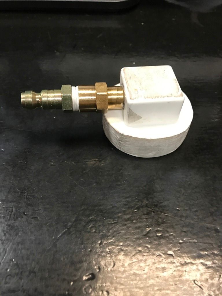

Took the Supra for a test drive after having a buddy help me bleed the brakes twice. Even after, the pedal went right to the floor once the engine turned on. I drove for a few miles. Was really hard to assess due to having such a soft pedal. The brakes appear to be working fine and not making any noise. Going to use a pressure bleeder tomorrow to get all of the air out of the system. Made this adapter for the master cylinder. Should work great. Just clamp it down and hook it up.
