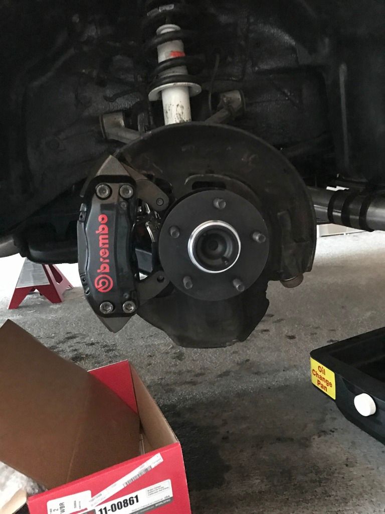

I resumed work on this upgrade over the weekend since my 2jz swap is almost complete. I ended up getting some HNBR o-rings from Harbor Freight to hold me over until I can find EPDM O-rings in the correct size. I am having a couple issues though.
Did anyone have an issue with the brake hardware rubbing on the outer edge of the rotor?
My rims ended up not clearing by a good amount. It got dark and I had to remove the caliper to put the car back on the ground. I just have a measurement from the rotor face to the inside of my wheel. Does anyone have a measurement from the rotor face to the outside of the caliper? I'll need to order some spacers but don't have access to the car at the moment. Thanks.

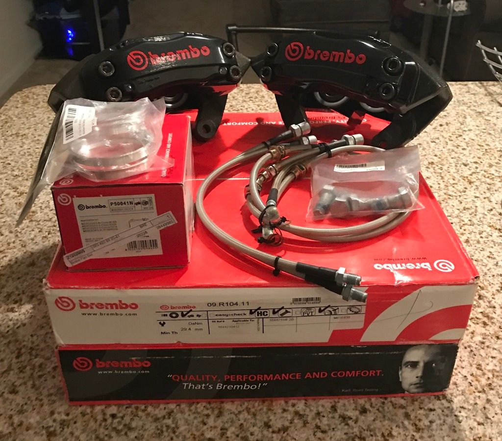

I went with Brembo pads (pictured above). Figured the calipers are Brembo, rotors are Brembo, might as well do Brembo pads are well. I haven't installed them yet, so I can't comment on noise, dust or performance.

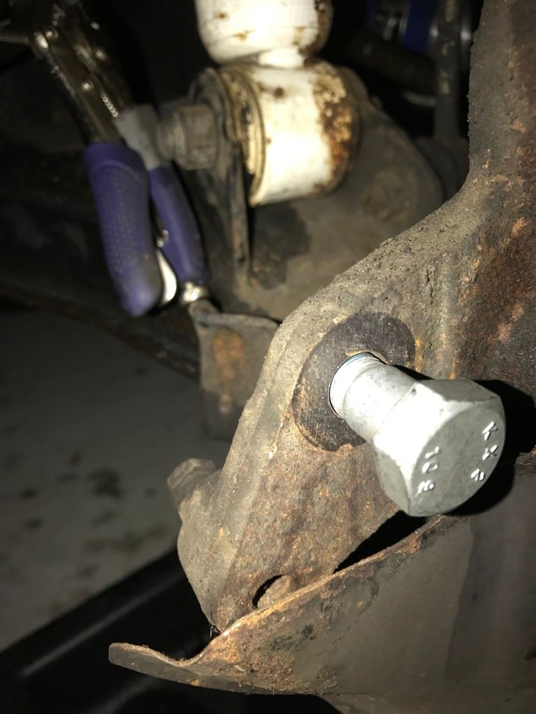

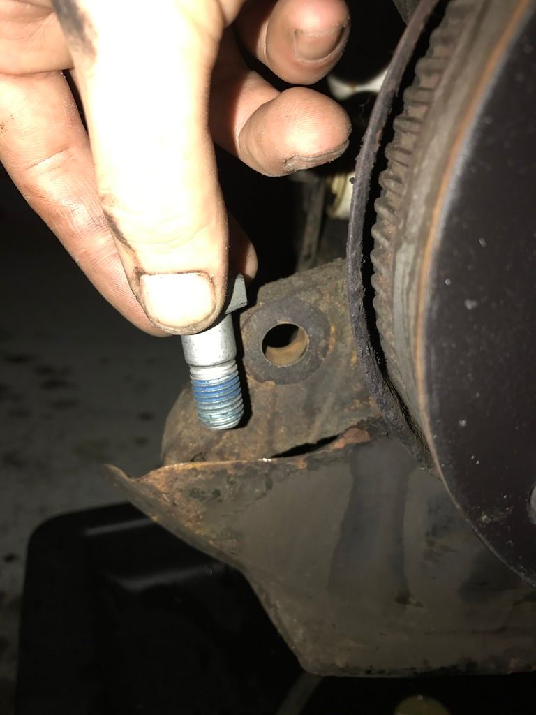

Am I the only one who is having issues with the caliper bolts? I'm trying to use Mercedes bolts 1234210271. The length and thread pitch is correct, but the base is too thick to fit through the knuckle. I'd hate to have to drill it out. Ideas?
D.J.T.
Aug 25, 2010
877
Arkansas, United States
Same. I wasted $20 for nothing when the bolts that came with the Mercedes Calipers work just fine.

MarkIII4Me;2085667 said:
Booyah! Scored everything pictured for $475. And for what's basically a new Brembo 4 pot 13" kit, that's crazy!
[URL=http://s142.photobucket.com/user/175db/media/D1B6DC0E
any chance you will tell us how you got that stuff so cheap??????
MarkIII4Me
Project OVERKILL!!!
Apr 10, 2005
1,250
Charleston, SC
I work for a company that has a monstrous account with a huge vendor so pricing on everything is peanuts and my rep said it was cool to send my old Supra calipers in as cores. Sux that they don't have any stock on reman Rear Evo calipers, or I'd be all over them too.
I do love me some quality built remans. Definitely the way to go if you have the means.

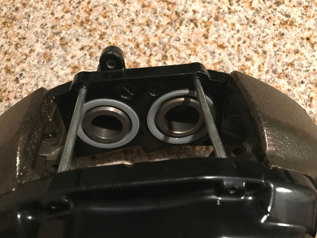

Has anyone found a source for the pad guide pins? All of the rebuild kits I have seen are just the seals and o-rings
