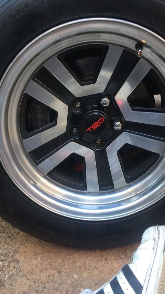

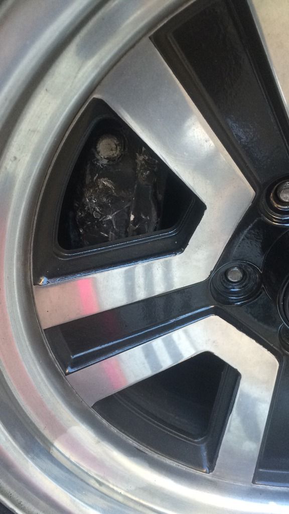

So I scored a set of caliper by accident this morning. Tried them and found out they do not fit under my Starion wheels :(
It fits under the wheel just fine, but it hits the face. If it had about 5mm of spacer it would probably fit but they already stick out under the fenders too much, so looks like I'm in the market for some new wheels

This is mine with the Starion wheels, the fronts had about an inch of spacers, but the backs did not. Just some very slight camber. Do you have spacers on yours at all? From your IG photos, yours seem to sit out much more than mine.
I should also note that the front fenders have been rolled, there are some eyelashes on the pass side that gave that away, have you considered rolling them?

Mine are rears all around
