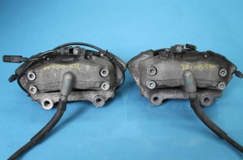

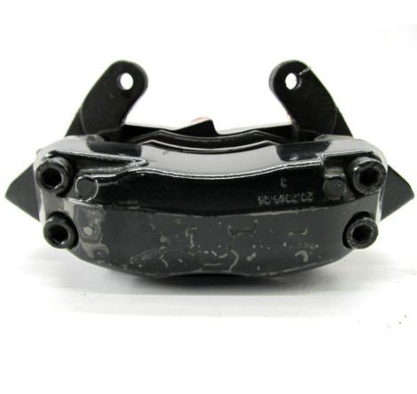

gats;2045328 said:
What exact caliper is needed, as there seem to be a few variations...
This style is listed as 00-02 S430:
However, this is also listed as 00-02 S430 with different mounting tabs:
Which style have people been using?
I have been asking around at local junkyards for these calipers and they all keep asking date of production. After some research there is a pre Production (12-3-2001) and post production (12-4-2001). Does any one know which set goes with which production date?
What are the differences between the the pre and post production date if the ones pictured above are not correct.
Sent from my iPad using Tapatalk
hvyman
Dang Dude! No Way Man.
Apr 17, 2007
12,568
Fullerton,CA
You need the top ones which should be the same as the s500. The lower ones are for a base model with smaller rotors.
