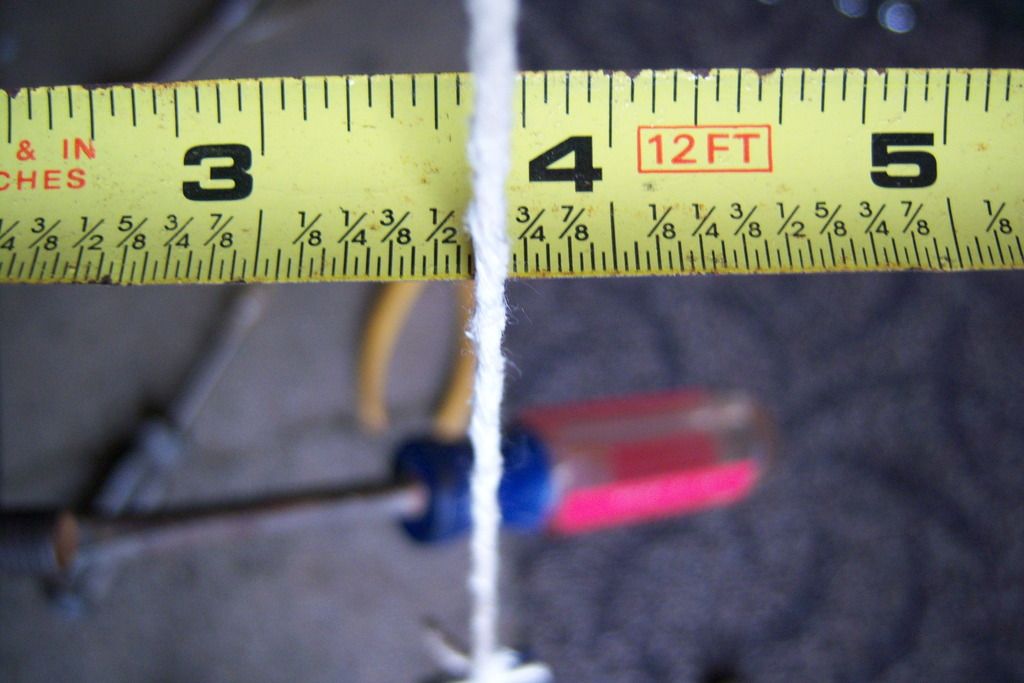

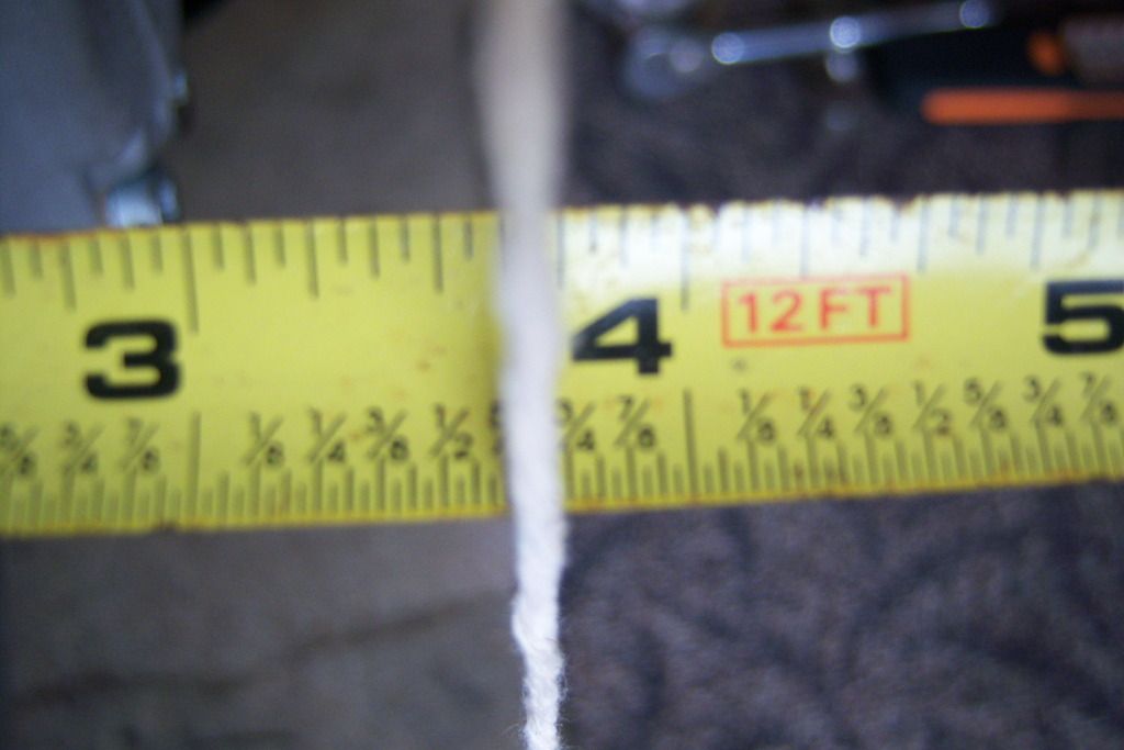

i was curious if the R350 rotor would cause the wheel to be futrher out (thicker than stock). so i hung a plumb bob off the outside of the fender. measured from the stock rotor hat to the string.
removed the stock rotor and mounted the new R350 rotor. and measured.
maybe 1/32" more shallow.
so if your rim is hitting the caliper on the mocked-up fit with the stock rotor, you're definately gonna need wheel spacers to clear your rim with this kit installed. don't even think of putting spacers behind the new rotor.
hope this is the answer to your question.

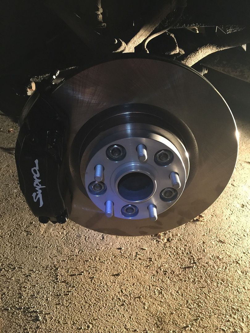

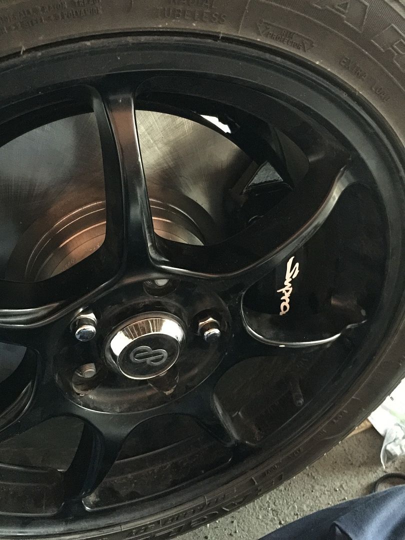

Hubcentric spacers I bought were the wrong hub size, just ordered new ones...
BUT, the picture I posted a few posts back of RX7 FD rims: I put the drivers side brakes on yesterday and I had to grind a few mm off of the top of the caliper to get it to fit. I took the picture of the passenger side...I ground down the second caliper expecting the worst but it fits with a lot of room to spare, so I guess this is the same situation that the MKIV guys have with fitting FD rims on their rear hubs. There's a few variations of FD rims and the ones with the bigger barrel style will fit with minimal grinding, the smaller barrel will take a lot more.
I'll have pictures eventually.

Hey guys, I finally got everything bolted up and working and now I am finally getting to posting my pics.
akito
Keep Laughing.You're Next
Jul 31, 2006
1,568
Springfield/Va
Looks great man! how does she stop compared to before??
Nick Squire
Aug 8, 2013
80
Montreal, Quebec, Canada
I'm super impressed, they have a better pedal feel and when I step on the brakes it really stops, I havent tried locking up the tires yet but I think my abs kicked in once and everything reacted exactly as I would have liked. I feel like the stopping power is very linear and predictable, which is awesome (y)
Thanks again hvyman, was definitely a great find.
