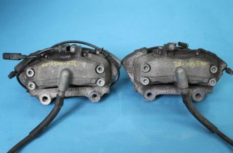

Hello
i'm trying today to mount the kit, but i have an issue.
I'm using this model,
But the rotor of 32mm don't enter inside the caliper. The space inside the caliper is 31mm. Normally for 28mm rotor.
Can I remove the 2 mm bothers me (these are the tip of internal fixation of the 3 parts of the brackets )
IMG_20150612_132243.jpg buy here
I have the clearance for new brake pad with 32mm rotor.
I can't bolt the calipers, because 330 rotor is too big
Anyone has the same problem ?
Thanks

Redskins17
Jun 29, 2013
Marsais - France
Page 16 is write that my model is good, but it's not the case.
Ref 20.7047.04 4 is different of 20.7047.04 7...
Anyone can confirm me that 20.7047.04 4 is the good model ?
Thanks.

hvyman
Dang Dude! No Way Man.
Apr 17, 2007
12,568
Fullerton,CA
The one you have is not from an s class. Needs to be from a 220 chassis s class s430 or s500.
That is for a 28mm rotor and is only around 280mm.
Blackmk3
Apr 10, 2006
142
New Zealand
Dam, so that means I've ordered the wrong type.
Right so the 220 s-class s430 s500
have the usually black calipers with the big mounting tabs on them, then you can run the 330 mm. Right?
So the ones I've ordered, same as a few posts above will still bolt on but just fit a 28 mm 280 mm rotor
Thanks!
