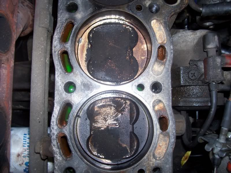

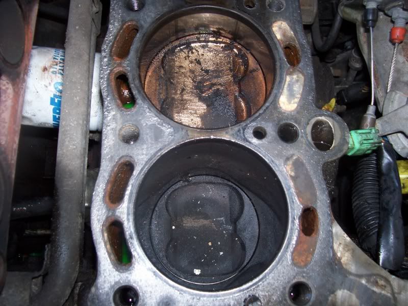

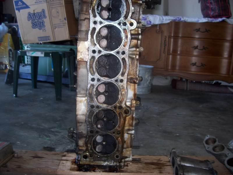

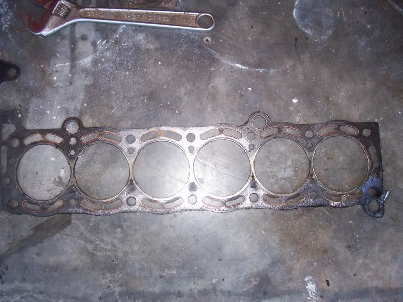

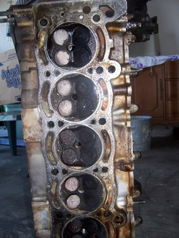

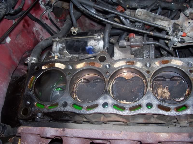

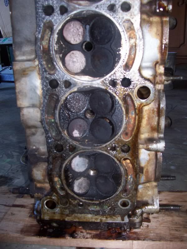

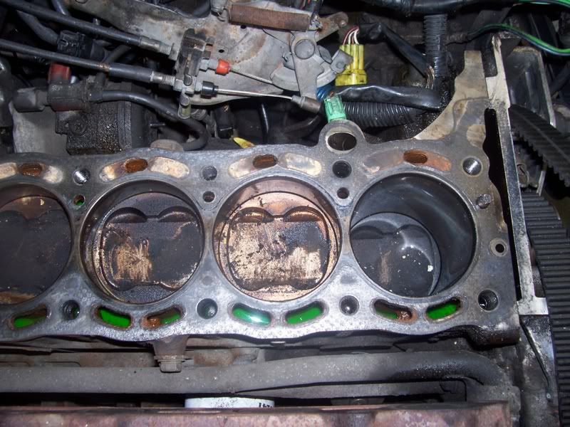

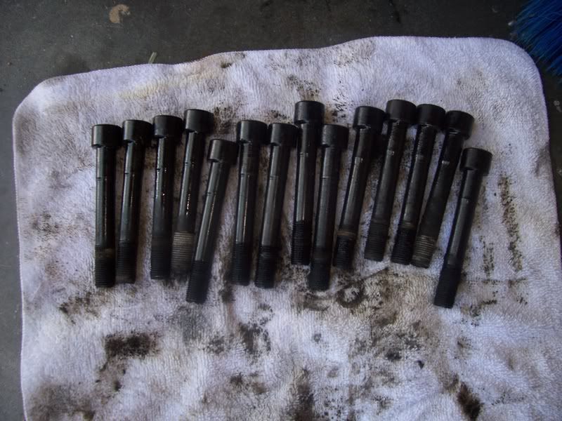

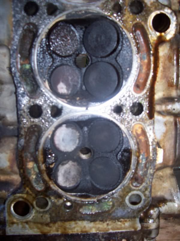

i've decided that im going to reuse the old headbolt,im on a strict budget and im going to be taking the advice from the SM experts/contributers. also should i put some sort of lube on the threads of the old bolts before putting them in again? im going to take the head to get milled and use the money i would of used on arp's to have it cleaned. as for the block im going to manually take off the old gasket material with a gasket scraper and if i run into stubborn parts i'll take your advice cuel. im also going to be using OEM headgasket that cost $98 from toyota. and FINALLY SOME PICS.

Only times I wouldn't reuse the headbolts are if I knew they've been overtorqued (if they have been there's a good chance the head is junk) or if the threads are erroded or if it's a high HP turbo build.

SB: The headbolts get a really bad rap when in reality they're quite good quality stock.
If a bolt has been pulled past it's TTY value you can usually see signs, as I said on a high HP build yep new hardware is essential but on an NA it's not really necessary (other than peace of mind).

There are very few times when you would need to replace head bolts on a stock N/A build. Replacing them as a precaution is another story. When you pull the bolts out, clean them up with a wire brush and a little carb cleaner or such. Inspect the threads. If you see signs of pitting or deformation in them then definatley replace them.
