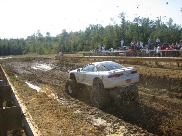

SageMoonblade;900375 said:
I am looking to use both the Supra engine and transmission and fabricate a way to mount it as it would sit in a Supra and maybe, providing there is room, retain the AWD capability redoing it to more resemble a 4X4 truck.
LOL!
This is a buddy of mine's you can see it in action at about 5:30.
http://youtube.com/watch?v=07_FEDxxXAI
Saavedro88
Jan 26, 2007
250
Richmond VA
I have yet to see it/ride in it in person, but I'm told it's the place to be on a drunken Friday night.... LOL!!!
To be honest I've never been rootin' before... Anyone ever see a lifted MKIII? That would be interesting to see...
