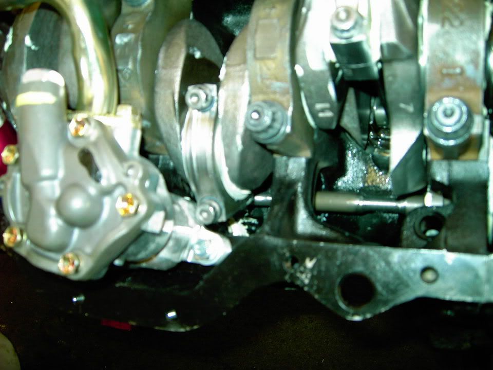

Notice the oil pump drive? It is machined down about as far as I would reccomend, and it barely clears the Pauter rod shoulders. (You might be able to get more if your rods have thinner shoulders, but weaker rods was not an option. :))

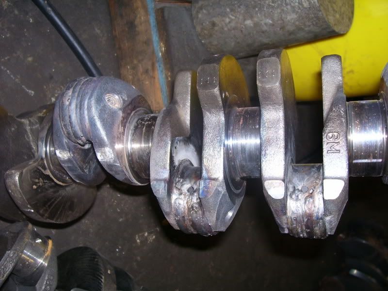

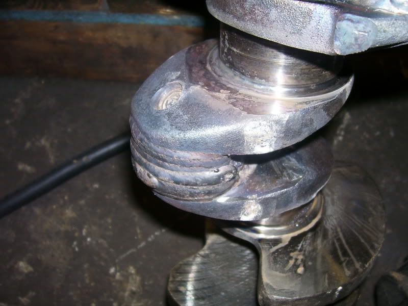

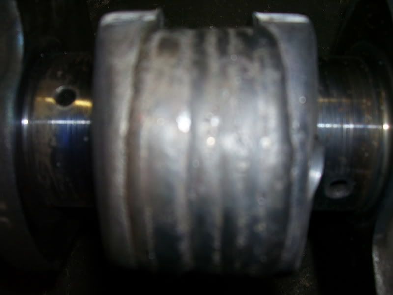

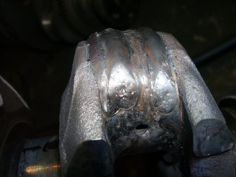

Will be done very soon, just waiting for the pauters to show up so I can grind the crank to match the rods.
All welded up except for 1 and 6, can't wait to finish this first one! Then next will go much faster.

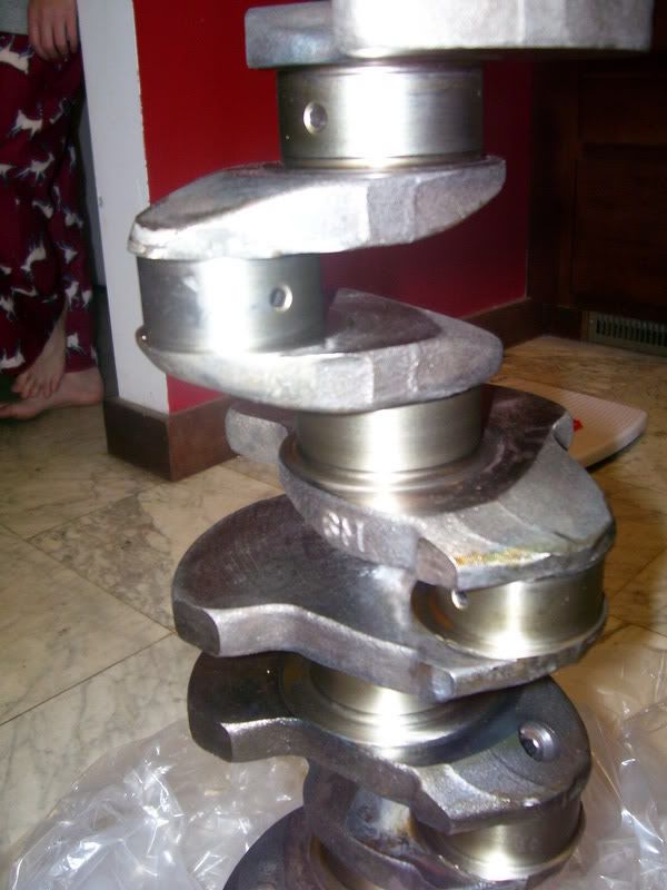

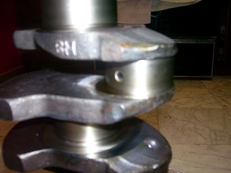

It is finished!, This one crank is ready to go. I will post some pics of it and some specs later this evening.
suprarich
Guest
Nov 9, 2005
2,187
ohio

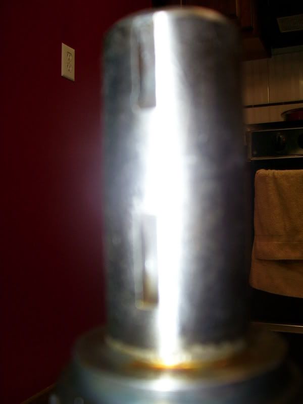

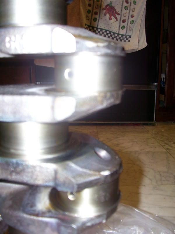

The snout is brand new on this crank, the crank pully had come loose, so the snout was welded and ground down to oem again. The key ways are fresh and brand new.
This crank is fully machined and straighter than they are when new. Rods are all std size, mains are .25m under. Had to grind them down this far to straighten the crank. This amount is nothing for the mains. Stroke is 97mm or 3.8192
The rods and mains are finished to have an oil clearance of .0015, this is very tight and will give the buyer room to polish down to their desired clearance.
Price for this crank plus the custom pistons will be in the 2200.00 range plus exchange.
