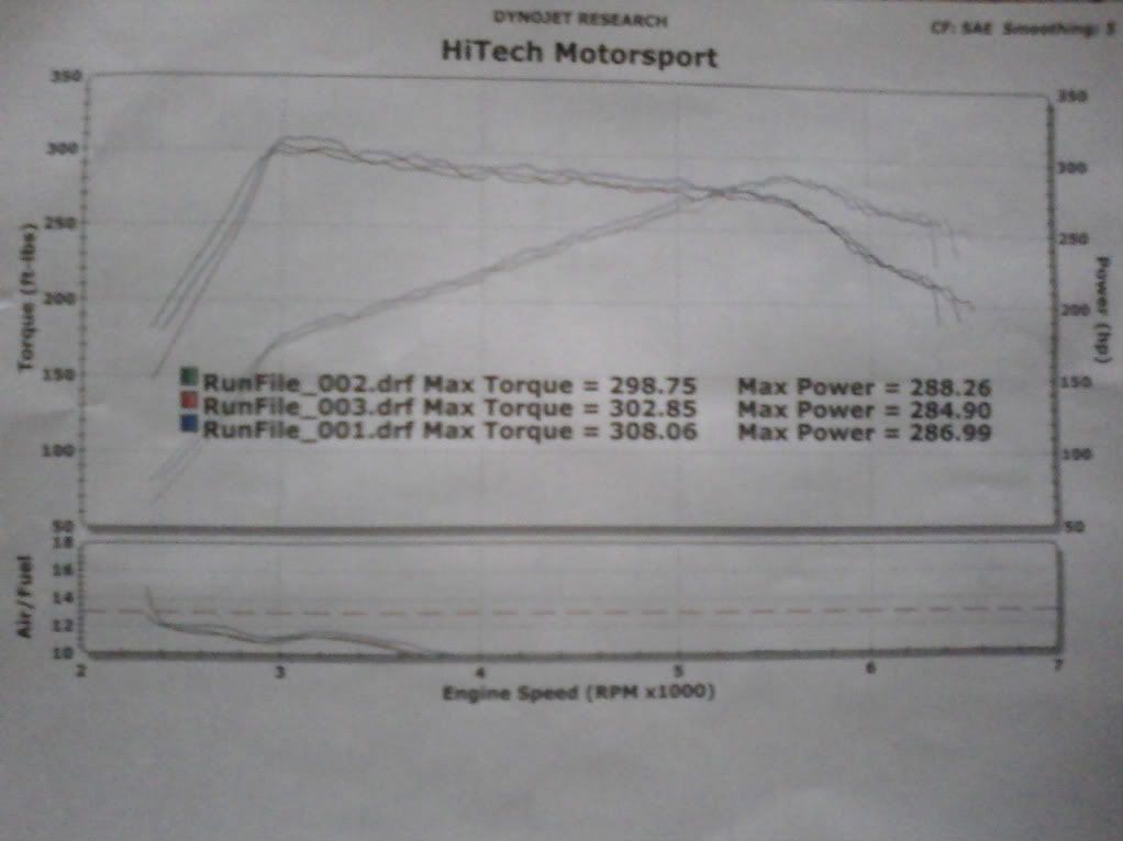

Yep the #'s are in and not to good, compaired to other members with the 7mgte and the ct 26 set to 11-12 lbs of boost
If anything the 272 cams are bring
down the #'s. But I will keep searching here for more dyno sheets.
Also I think this is the first time 272 cams have been dynoed on a 7mgte and as we can see they didnt help anything out. But I also need some tuning very bad. After 3600-3800 RPMS on the EPA dosent like me any more. It is below 10 on the A/F.
