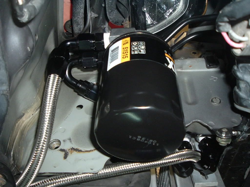

You are going to want to pre-fill that filter before firing up the engine after any oil change, Rob. But it should have great filter capacity!
Me likey.
CajunKenny;1523309 said:
^Ditto! A filter that size will take a few seconds to fill. And that's a few seconds you're without oil pressure.
I have to do that on my PowerStroke.
Yep I did, and always do on every car I change. It took just about 3/4 of a qt.!
fixitman04;1523394 said:
glad those years i spent at the ford dealers quick change bay helped! finally got my pos computer to work. looking good rob.
Thank you! Yep it was a close fit, but fit :)
Tire Shredder;1523422 said:
thanks for the details! nice work thus far, I love the fluid cooling and line work.
No prob, I was pretty surprised how well they fit. One local member ordered them and once we saw how great they fit Sean and I followed suit.

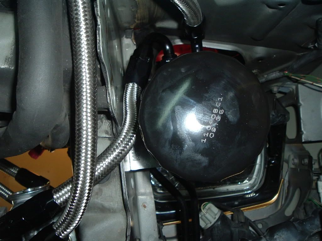

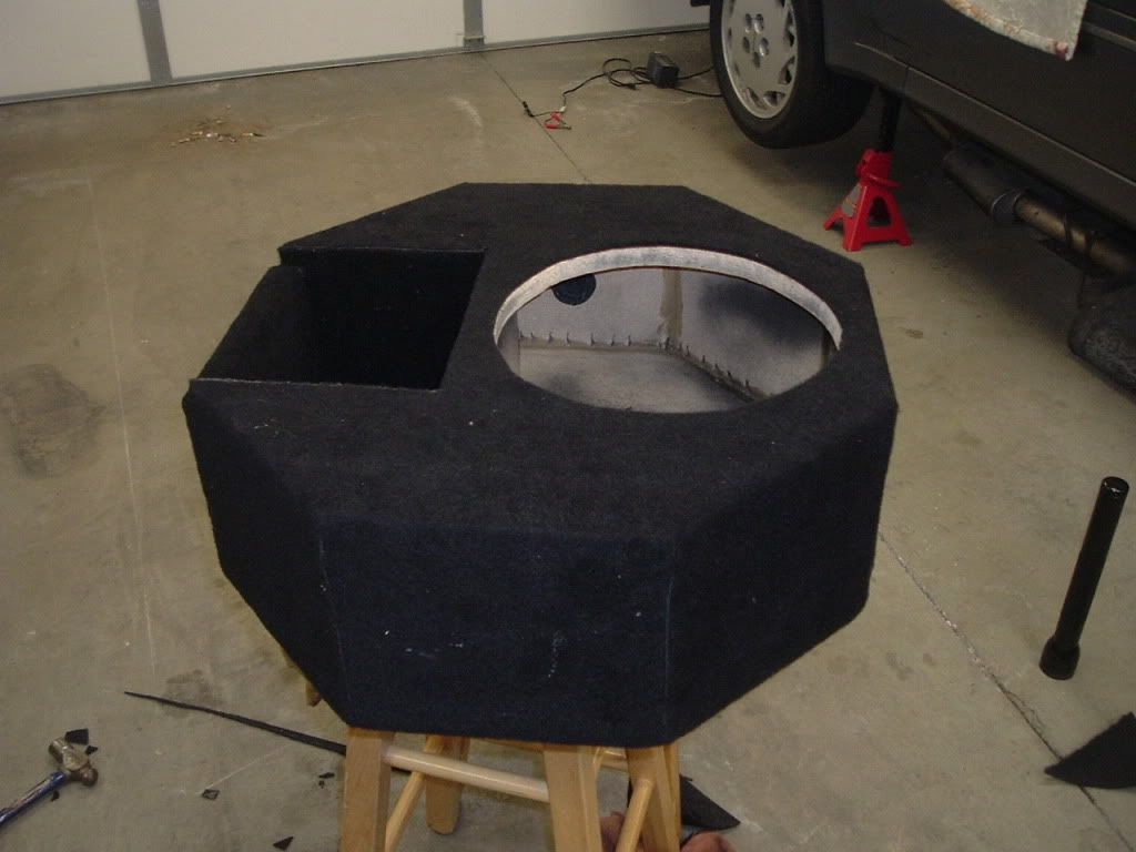

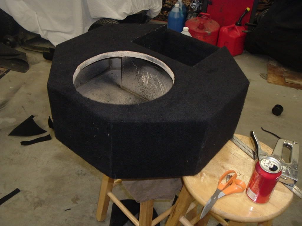

Well another quick update from yesterday. Installed the monster oil filter, and finally put come carpet on the speaker box/battery holder. Now I just need to reinstall the battery hold down strap and sub in the box, then put it all back in the supra.

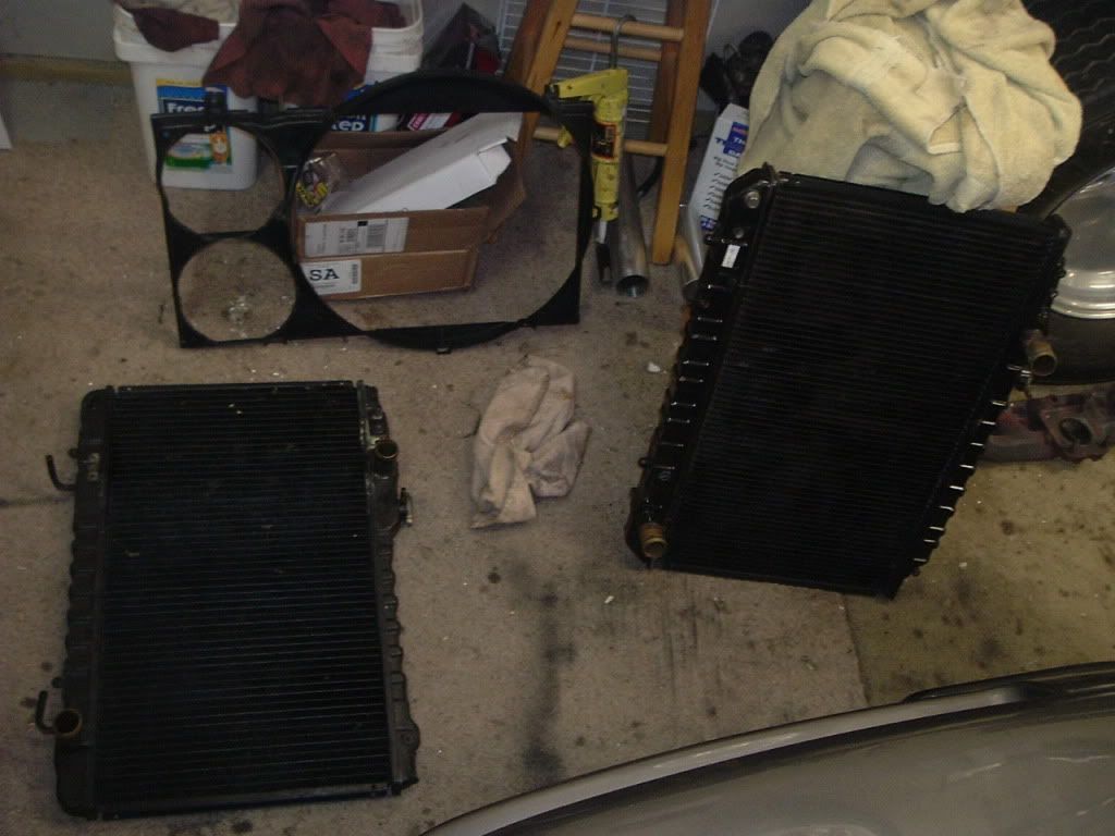

Reinstalled the sub / battery box. Then went to start filling the cooling system and my radiator now has a leak!! WTF. It is leaking from where the lower rad hose connects then goes in the end tank. So I will prob, just re solder the joint for now. Once I found that I said F it for today, and cleaned up the Caddy and garage instead.

I vote for a new aluminum radiator, Rob. You can even paint it black on the top to look more stealth... Extra cooling capacity is never a bad thing, plus the prices are close to an OEM one.

But Hundo Drew (Mr. Yuk), is coming threw, once again, to save my ass! He also has another radiator laying in his garage. So he is going to drop it off for me. He also had the manifold I needed once I busted off the stud.

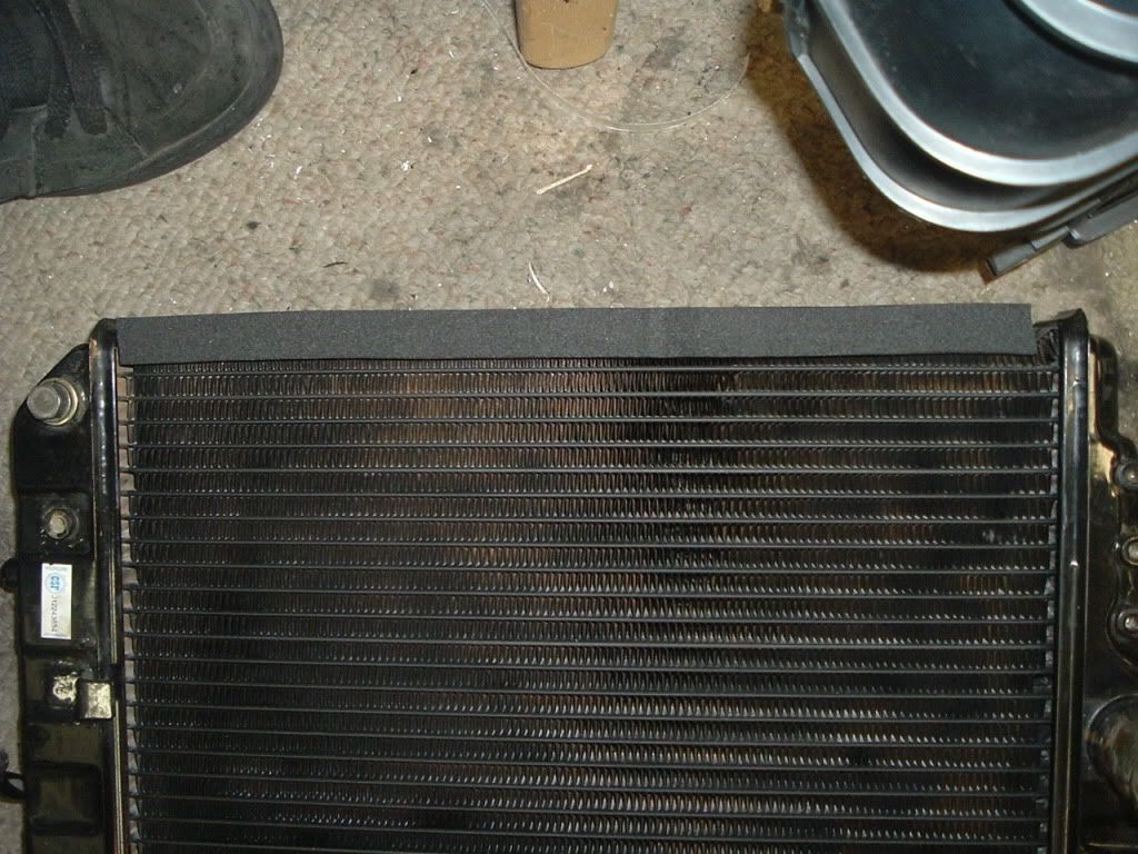

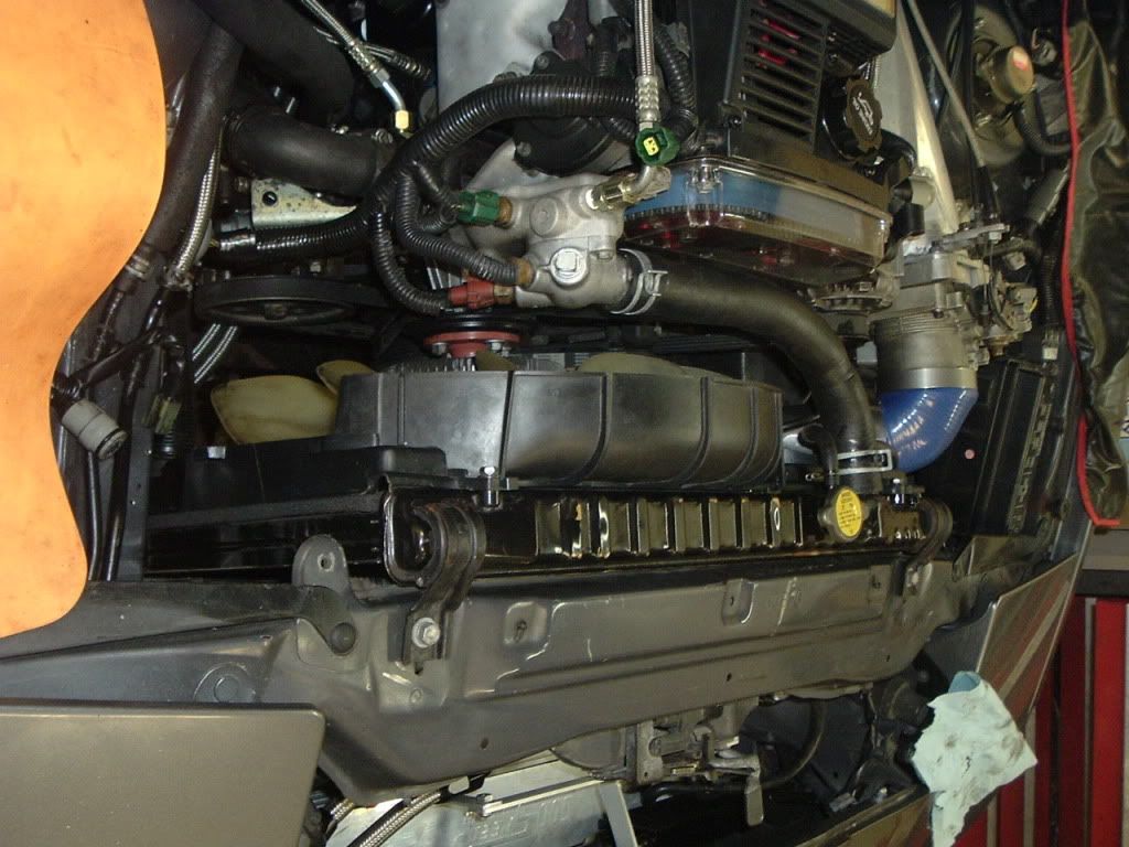

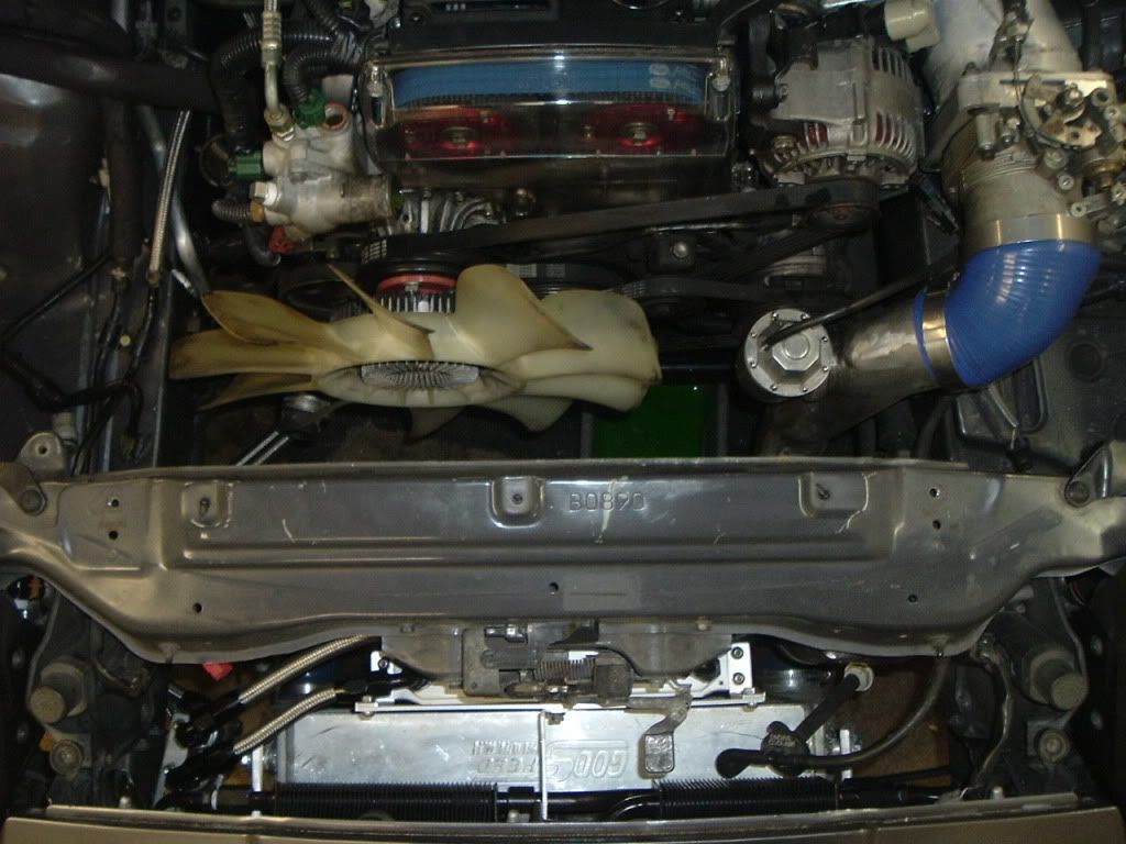

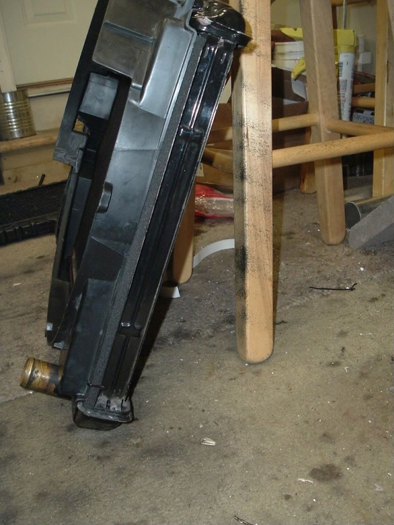

Today I just painted the core & replaced the radiator then cleaned up the area around it.
I also replaced the foam strips on the sides of the radiator so the fan shroud seals up tight.

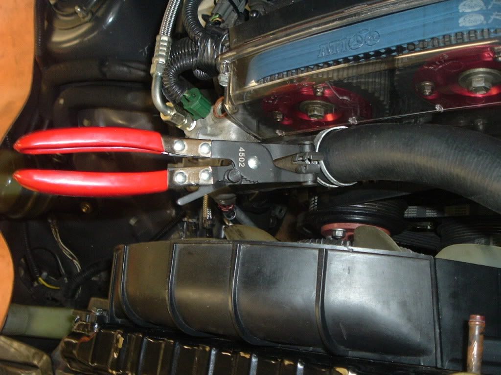

I also took out the hard pipe and reinstalled a normal hose. The hard pipe has to many places it could leak from. Plus used the OEM clamps. I have had this "pliers" for several years, and today was the first time I have ever used it, LOL
Also removed the BVSV and plugged that hole and filed up the system, WHOO no leaks, now I just need to find the correct sensor for the cold start timer and the cooling system can be wrapped up for mow. <-----:rofl:
