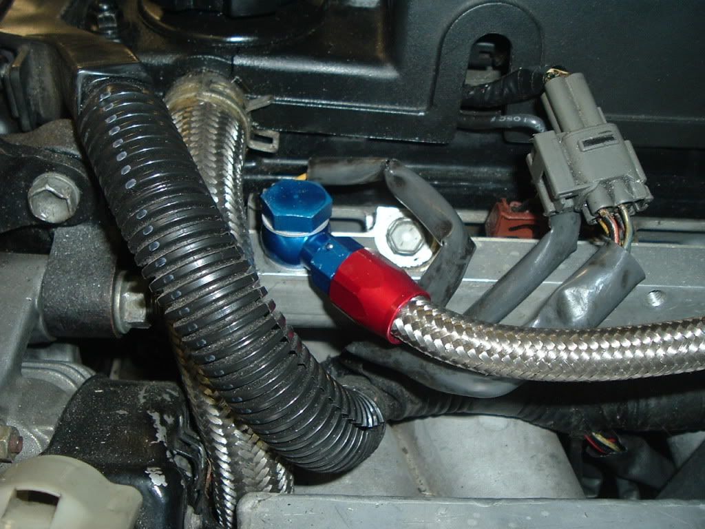

Also installed the 90 degree elbow for the vac line from the turbo to the boost controller, and finished that up.
Don't seem like much, but took a wile to do everything, planing, cutting, fabricating, ect.

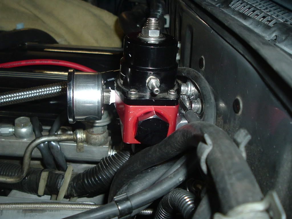

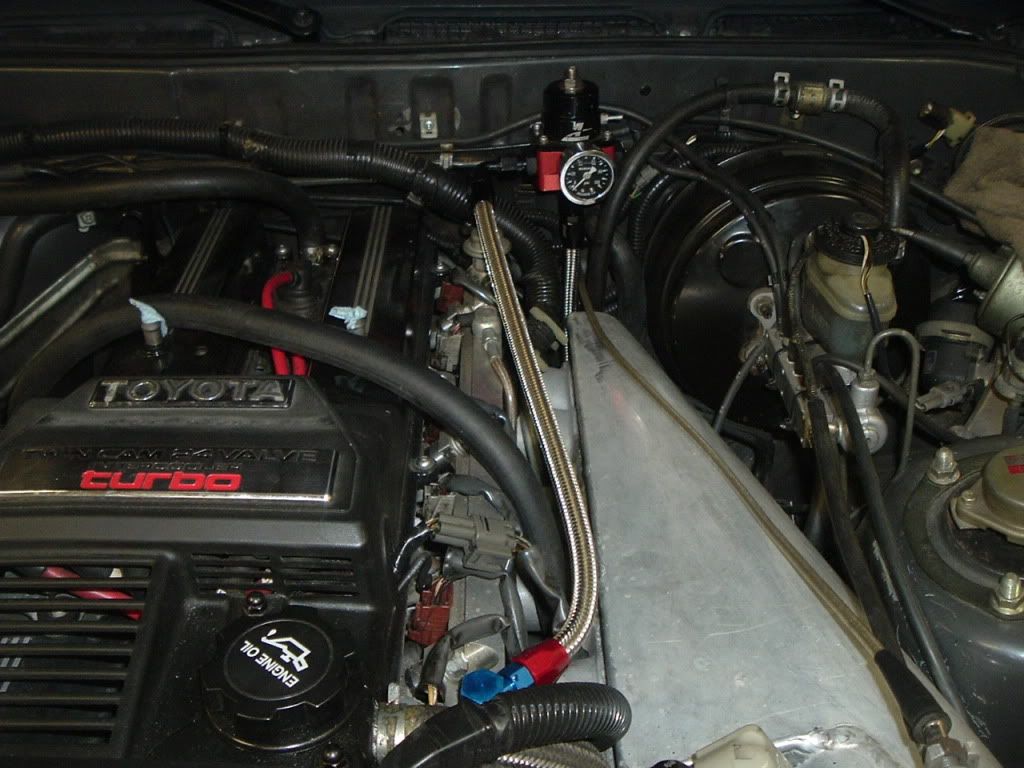

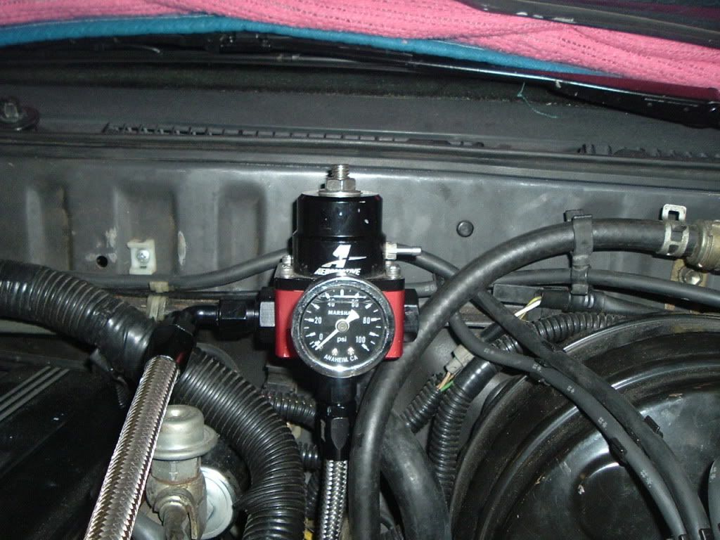

Today I finished up installing the AFPR and removed the "J" tube and installed the BBC fuel block off plate. But I just ran out of vac. tubing to hook it up. So another thing to put on the parts list.

Rob, Looking good. I like the position of the FPR. I may have to see if mine will fit on the fire wall as well.

Thank you. I chose to install it on the fire wall to keep the fuel line as far away from the alt. that I can. Don't want to a car-becue.

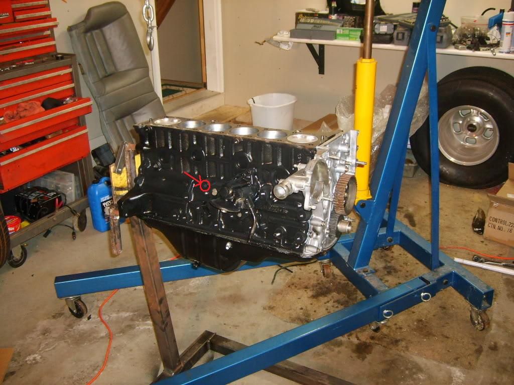

dslocal;1522230 said:
where are you taking your oil temp readings from?
From an internal oil passage in the engine block. Just under the turbo, right above where the oil drains back into the block from the turbo. Using a prosport gauge for the readings
Let me find a pic.
EDIT, I swear I took a photo of it but I can't find it. It has to be on my other laptop that crashed 3 weeks ago :( Here Is another pic I took and just circled it in red where I put the probe.

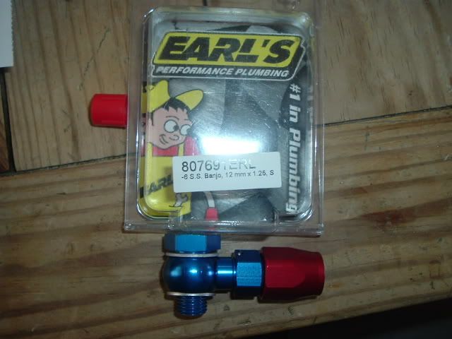

Tire Shredder;1522233 said:
can you post the details of that banjo fitting setup? it would be perfect for my situation.
Yep no prob. Earl's, 12mm x 1.25 Banjo to -6 AN, Swivel Seal, Red/Blue, Manufacturer's Part Number 807691ERL, $20.69 EA.
Link of where I bought it from http://www.summitracing.com/parts/EAR-807691ERL/

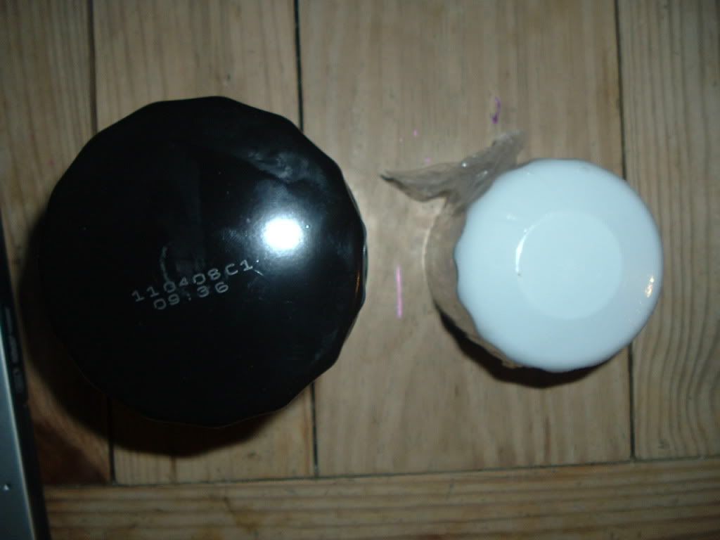

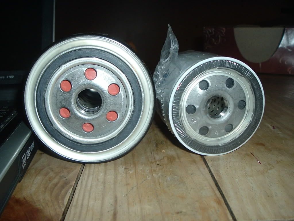

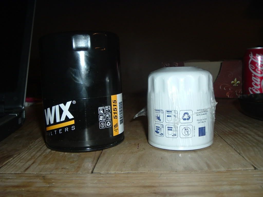

Well I got the new size oil filter I want to run. Yup, it should work just fine, that is as long as it clears the one oil line right next to the oil filter. I will check that out tater on this morning.
Like always need to have some pics of the beast. On the right is the WIX 51515 on the right is OEM size for the 7M!!!!!! You think its large enough? :rofl:

You are going to want to pre-fill that filter before firing up the engine after any oil change, Rob. But it should have great filter capacity!

^Ditto! A filter that size will take a few seconds to fill. And that's a few seconds you're without oil pressure.
I have to do that on my PowerStroke.
