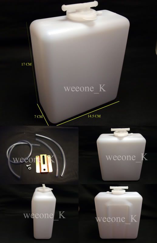

The fuse box had to be twisted 90 degrees from the OEM spot because the manifold was hitting it. This manifold has a 4" plenum! As for the coolant tank / over flow, nope I didn't order a aluminum one. There to" flashy" or "rice" for me. I want it to look as OEM as I can. So the one I ordered is white plastic, like to OEM one.
Here is a pic of it. Even the cap is just like the original (just not black), plus it the black cap fits that comes on a supra I'm going to use it.

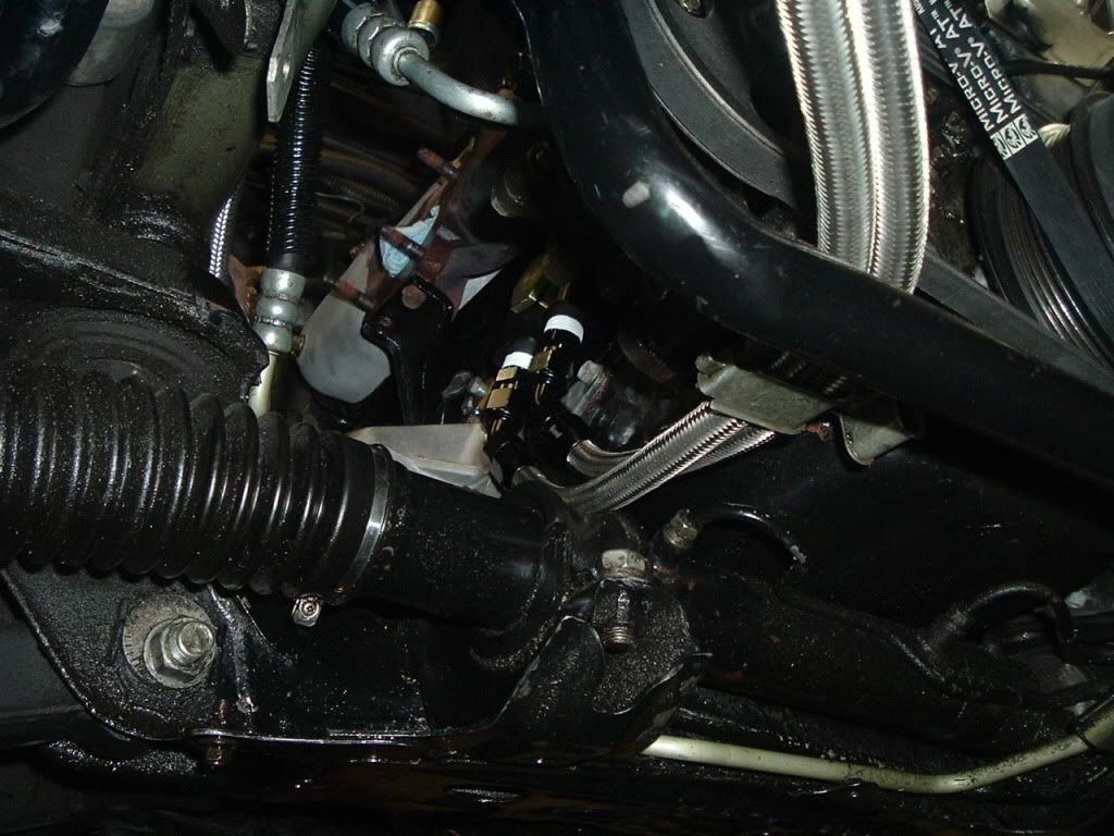

Well In the last couple days I got a few things done on her. Finished mounting the PS cooler. Had to make a 3/4" thick spacer to bolt up the center.

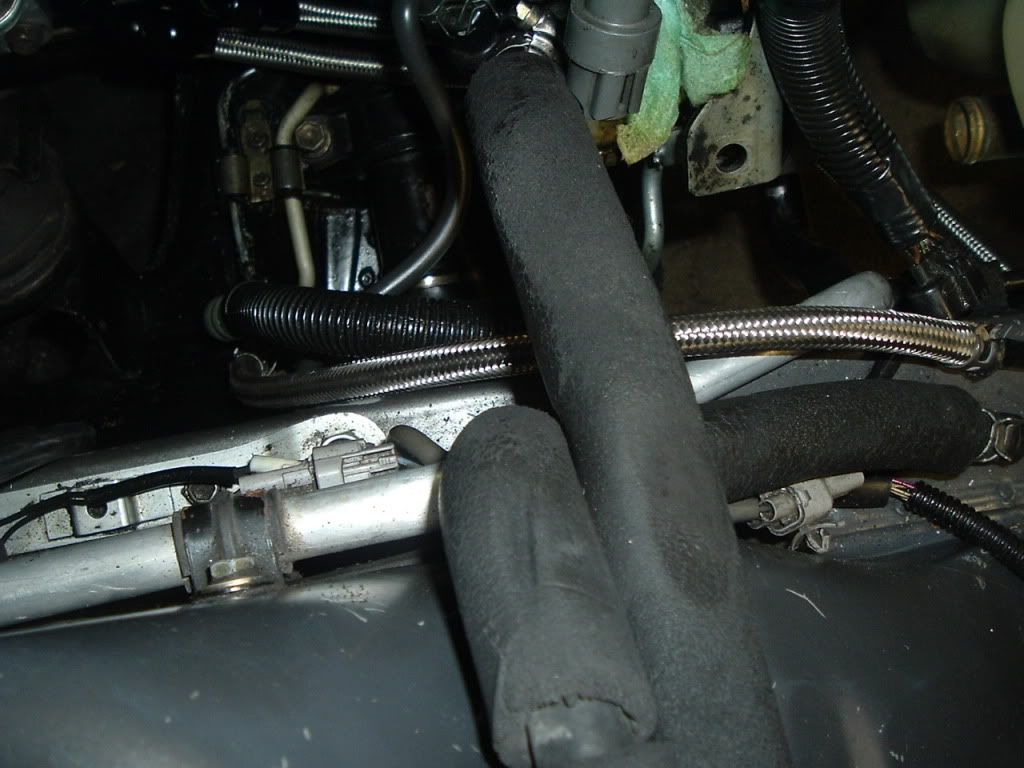

I also was able to replace one of the PS lines for the cooler. I use -6an hose. It was tight but I was able to make it work.

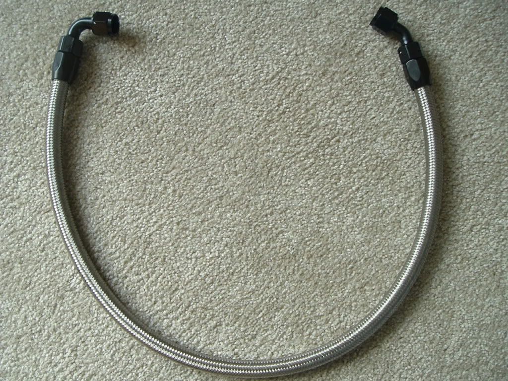

Next, I finished up to oil lines to the canton adapter. Here is a pic of what the lines look like with the black fittings. I will finish up running the oil lines once the rest of the hose ends get here. I still need to figure a way to mount the oil cooler.

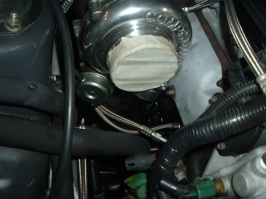

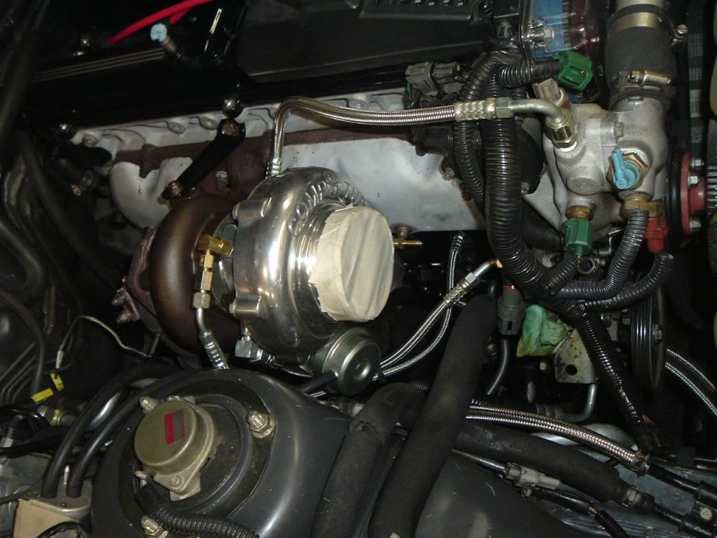

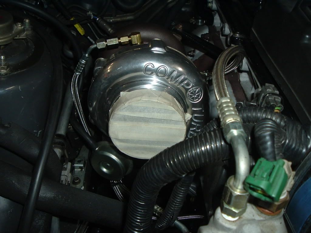

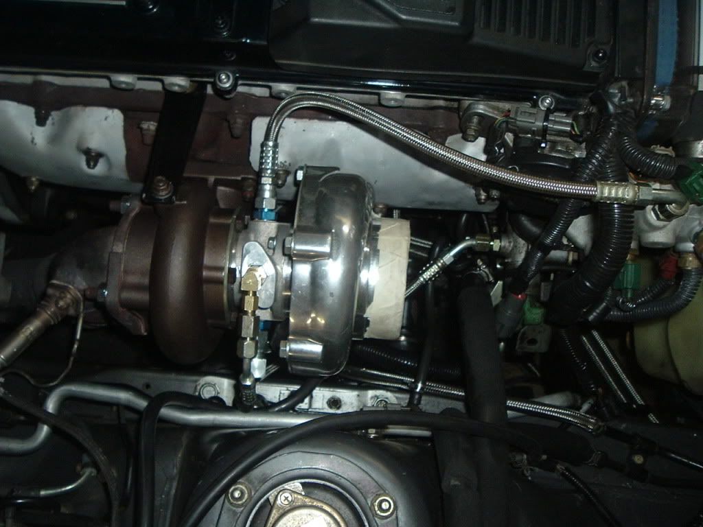

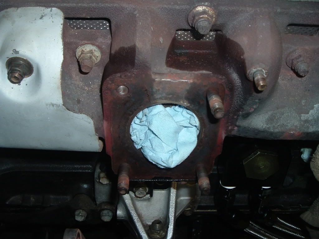

Then FINALLY I was getting ready to mount up the BOSS and the 1/2" spacer and "SNAP" went one of the studs when I tried to remove them to install the longer ones. So I scrambled to find another manifold and decided not to use the spacer. In the end I don't need it anyways. There is plenty of clearance with out it. AND SHE IS INSTALLED!!! :whoo: I just need to pick up a 90 degree fitting for the nipple to finish up the vac lines for the boost controller. Now I just need to fab up a bracket for the dip stick, and get to the hard ware store and pick up 4 nurs to bolt up the down pipe. There not metric, rather regular :(

Well last night I had a dream I blew the BOSS turbo because I left a blue shop towel in the exhaust of the turbo. It freaked me out pretty bad so I removed the turbo once I got up. Turned out I did remember to remove it but I had to triple check. So were good now.
This morning I gave Greg a quick call at suprasport and to my surprise he was in the shop cleaning stuff up and answered the phone!! On a sunday!!! I had to ask him what nut size was on the turbo for the down pipe. the stock ones were not right. It turns out there 10 X 1.5M, I also went to the hard ware store and pick up 4 of them so the down pipe is all bolted up now.

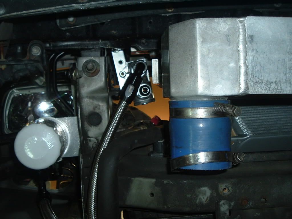

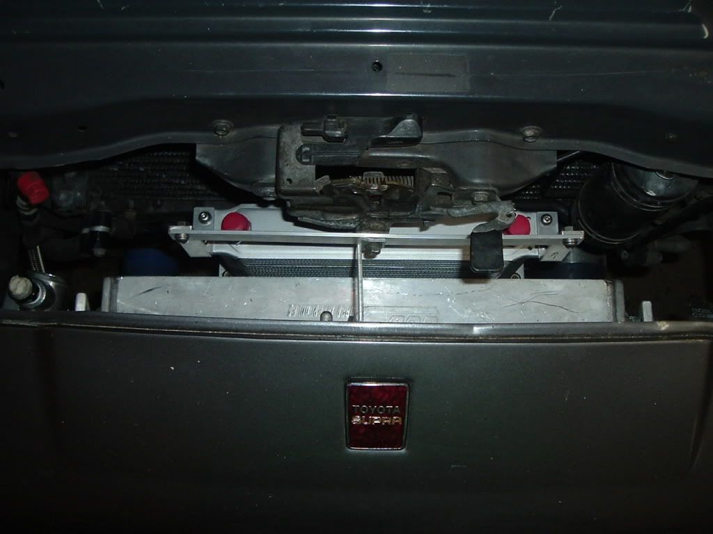

Well today I was able to mount the oil cooler. Well it's mounted but I dont think the brackets I made look to good, so Im sure some day I will re-do them with something different. Then about 30 min after I come in from the garage, the UPS guy showed up with the last of the hose ends I need to wrap up the oiling system. :( So maybe later tonight I wil go out there again and work on her, other wise there is always tomorrow. "Why do it today when I can do it tomorrow" :rofl:
Well I can update with out some quick pics.
Here are a few more with the turbo installed.
Oil cooler, dah!

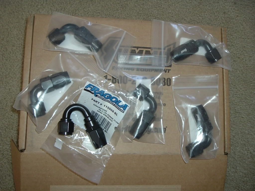

Then a pic of were the last hundo i spent went! They are proud of these fittings. But at least I can finish up the oiling system now.

IJ.;1519494 said:
Rob: Is the center bracket all that holds it in place?
(cooler)

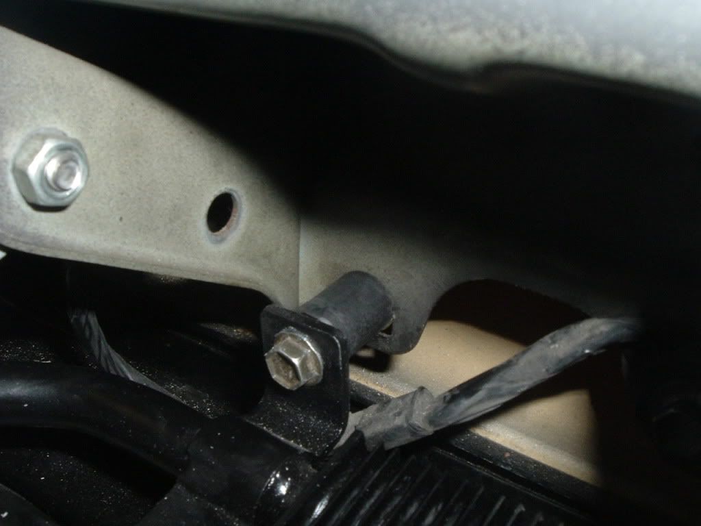

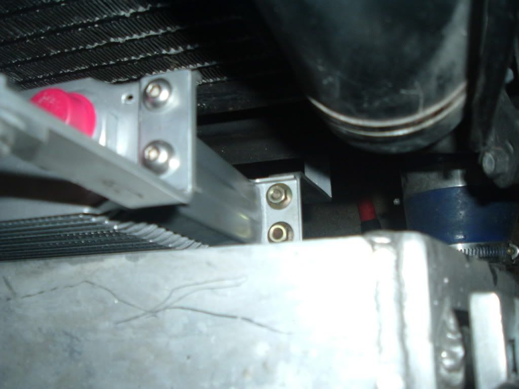

Nope there is also 2 more under the oil cooler holding it in place. I will get a pic of them when I head out to the garage later toady/this morning.

SySt;1519608 said:
Looks like he has straps going down to the radiator support as well.
Correct. I used 1/8" thick X 3/4" wide aluminum bar stock for the mounts. I was trying to stay away from having to bring them over to my buddies house to weld them up.
And for those who are wondering why I used the hose fittings I did and not pushloc ones is I feel these have a cleaner look to the install.
