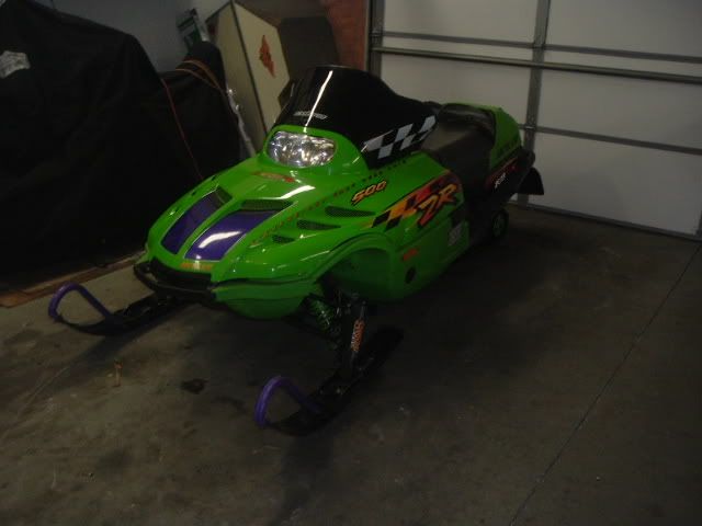

And since there is plenty of snow up here in Mn, I pick up a 1998, A/C zr500, snow machine! It has been pretty fun so far. Well it was fun right up until the recoil decided to grenade on it self :cry: I got it everything else fixed up on the sled now just waiting to find a recoil. None local at this time.

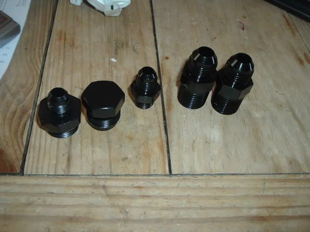

Well the parts I ordered for the oiling system and to finish up the AFPR install are starting to trickle in :)

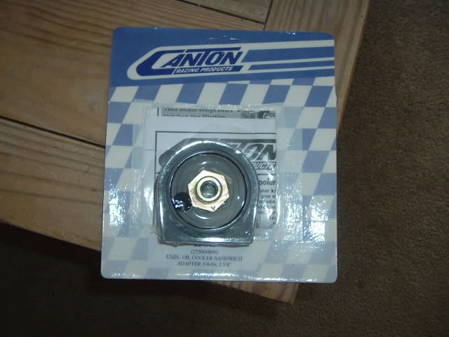

I have pretty much been on hold until I install the Canton oil filter adapter. It is just easier to get to it with the turbo off, and run the lines. Well I opened up the box I was "o-man I ordered the wrong part". F'ing A. I ordered part #22-545 (sandwich plate) when I needed 22-595( the adapter).
So I guess It will be on hold again until the new one shows up some time next week.
FAIL!

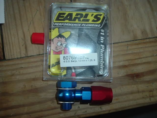

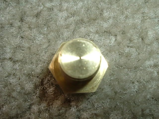

How ever I pretty stoked for the fuel system. This fitting I found cost a little more but I think it will make the install look a little cleaner plus it is a little different then what every one else uses. It is a 12 X 1.25 mm bango bolt to -6an for the fuel rail. The only bad thing is that it is blue and red, not black like all the other fittings I ordered. Also i'm hoping I wont run in to any clearance issues using this set up.

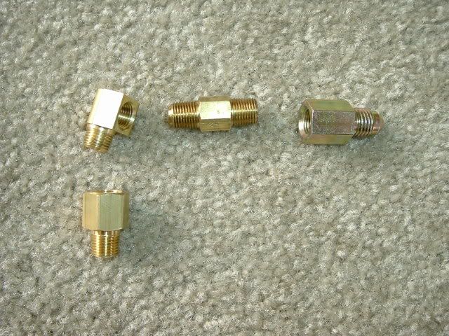

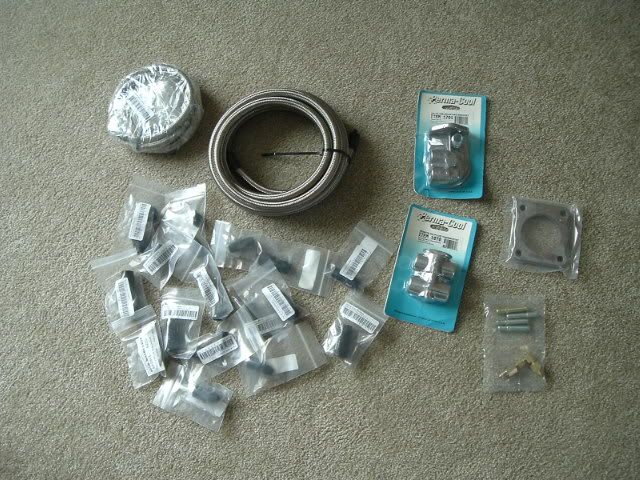

Then just a quick pic of what fittings has already showed up. Mainly there the fittings I need for my Aermotive A1000 AFPR. If you have been fallowing my thread you already know there fittings already on it, but there the blue and red ones and I want black ones. Wast of money? Maybe but everything matches and I might be able to resell the other fittings. I like the black a lot better then the normal red & blue. I'm hoping with the black fittings I have LESS of the rice look and LESS "hay, look at me I just spent $600 on hose ends".
But there is a update. Monday the rest of the oiling system should be here and the correct oil filter adapter should be here Wend, or Thurs.

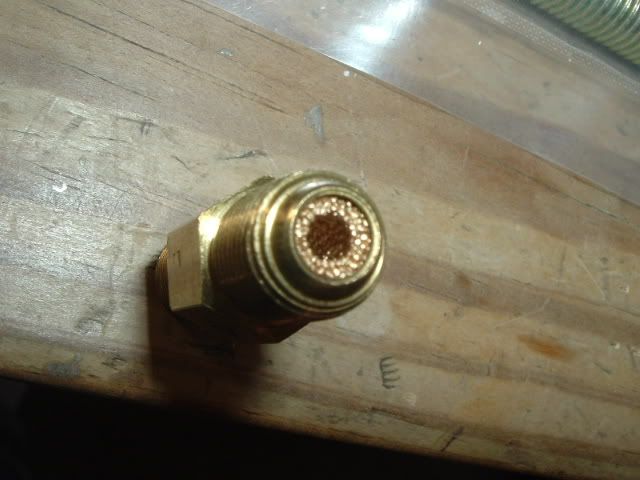

Well the UPS guy cam today and dropped off some more parts I need for the oiling and AFPR from summit racing. Plus a package from Greg at suprasport. First thought was, what am I doing spending this kind of cash on a 20 year old supra!! But o-well it is all fun. Second thought was WOW the oil thermostat is HUGE, where in the hell am I going to mount this. It is pretty big but I will find some where to mount it,............I hope.
From supra sport I picked up the 1/2" spacer I wanted, to get the turbo further away from the manifold. Plus 1/2" longer studs to bolt everything up and a new oil re-stricter for my turbo.
When I was on the Phone with Greg, He was telling me about comp turbo's some times having a smoking issue with the triple ceramic ball-bearing turbos. I guess the engineers at comp turbo found even with the oil restriction fitting of .060", it was getting way to much oil!!! And this was with the .060" fitting. They tested it and found the turbo ran 5 hours with NO OIL!!!. So now they recommend a new fitting with only a .016" fitting! Pretty much just needs a drip system for these new turbos. So I told him to send it on up here, and WOW that hole is small! Look at the pics below. Now I just want to find a fitting to replace all the extra fitting to get it up to a -an4. There is 3 extra brass fitting, And I am looking for a cleaner install, now something that looks like plumber Bob got a hold of the supra. But I dont thing I will be abe to since the center fitting also has a filter built into it.
One thing Im worried about is the fitting clogging up. I hope this new oiling system / filter dose a good job getting the shit out of the oil.
Now I'm just waiting on the other Canton oil filter adapter to get here and the oil cooler it self to come in the mail. Then It is off to the garage and time to play the install, and figure shit out game.
