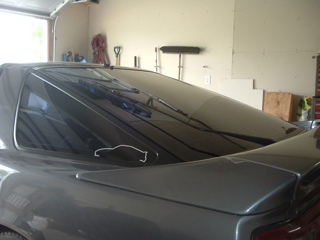

Also I finally got the rear wiper arm and blade installed. Not that big of a deal but it has been pissing me off because I knew it was missing/ not installed and there should be one there.

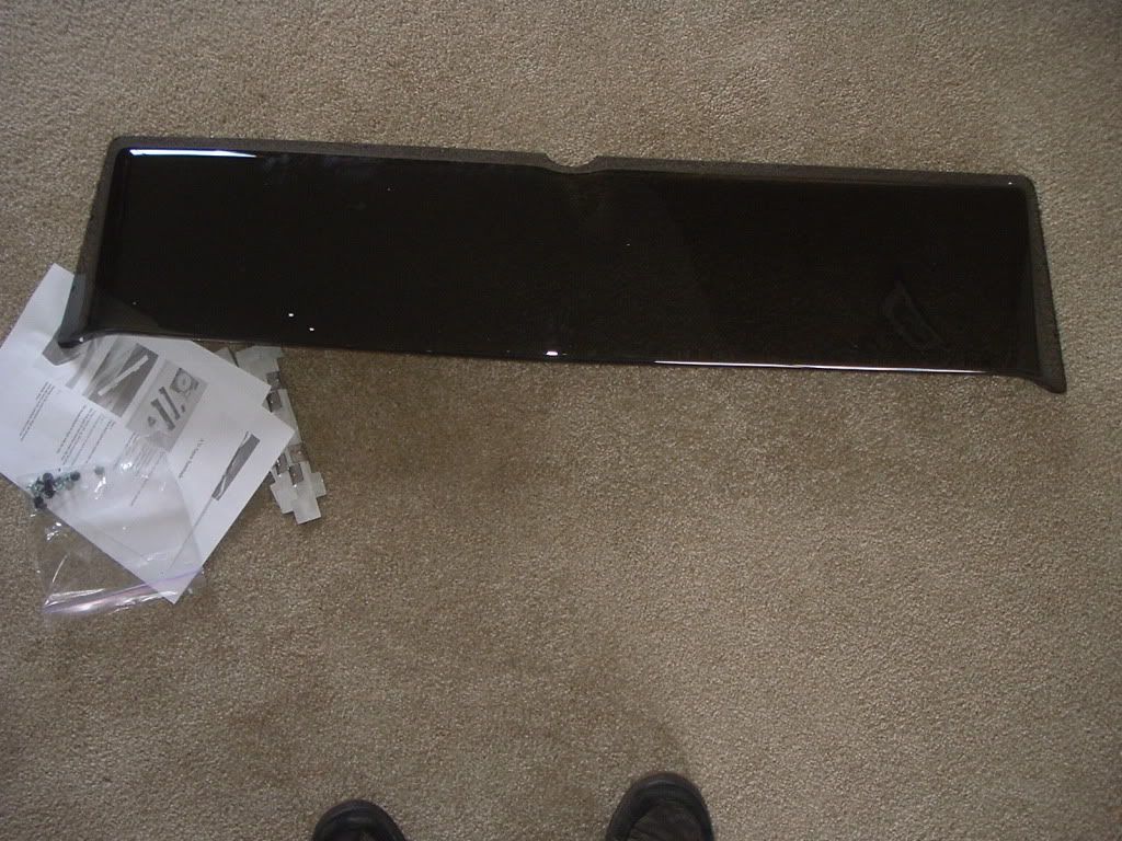

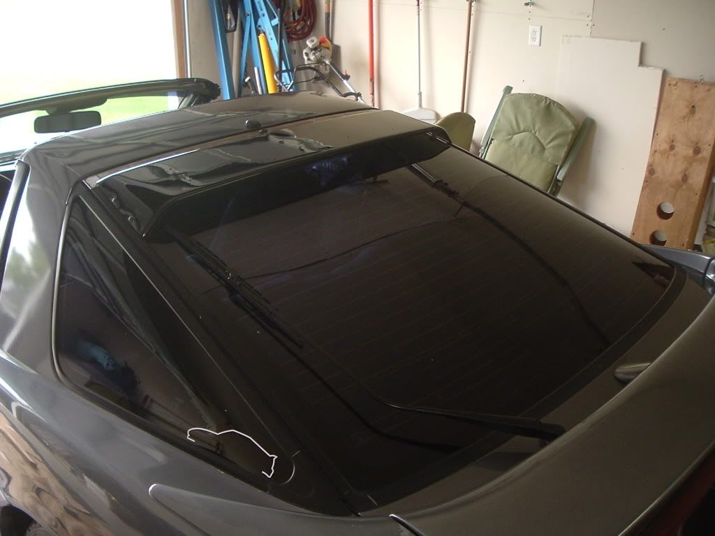

Sunshade arrived in the mail today!! So had to head out to the garage.
Pretty simple so I will let the pics to the talking

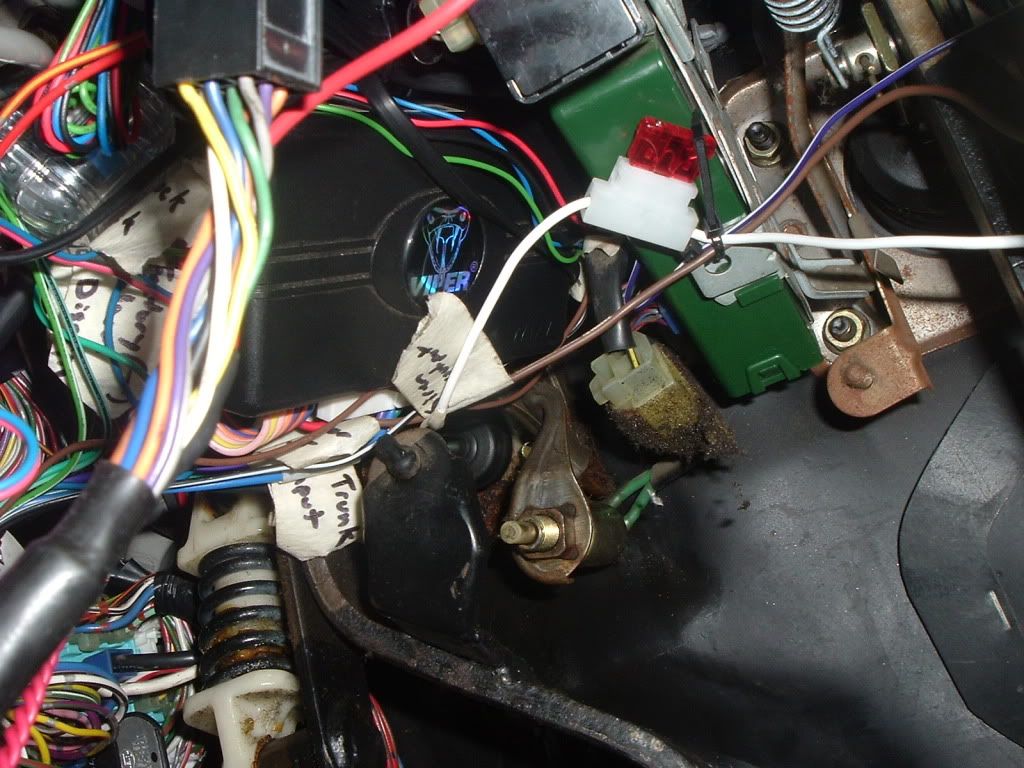

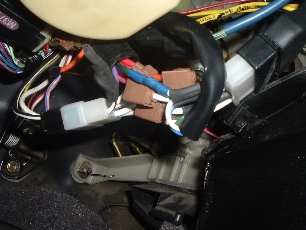

Here is a couple pics. I haven't zip tiedup up the wires yet (running short on time & dont drive the supra much anyways) but here is it in its mess. They will get cleaned up in good time.
Yep I had to by-pass the clutch switch
*****I DO NOT RECOMMEND DOING IT DUE TO SAFETY REASONS*****

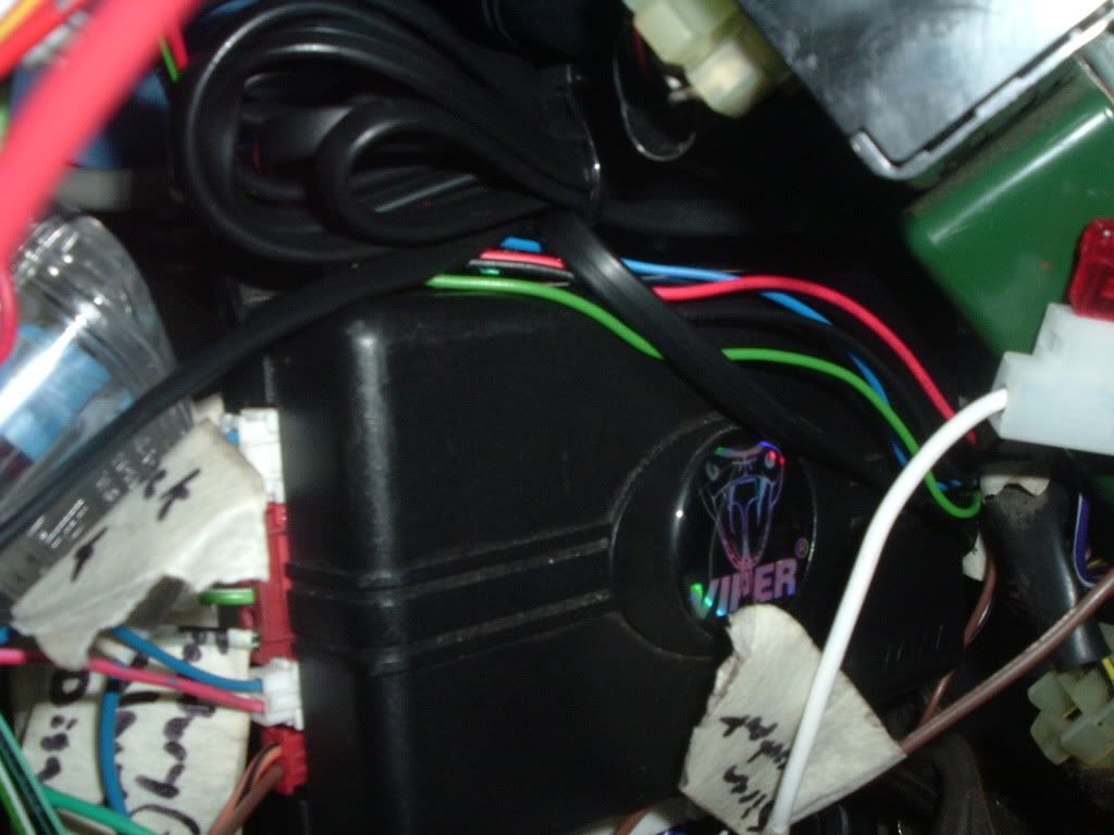

A couple pics of the "brain"

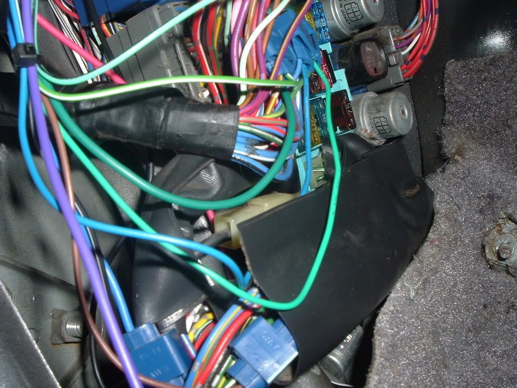

Turbo timer harness used so no ing. wires had to be cut
The mess of wires for the locks, brake, factory alarm, ect.
