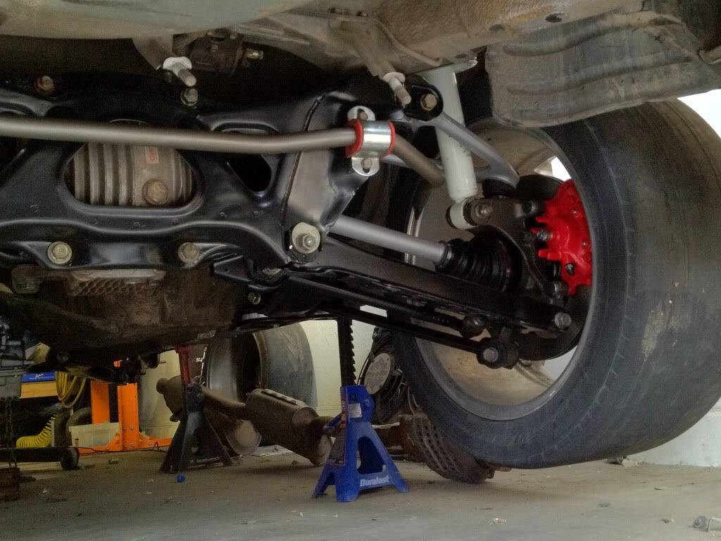

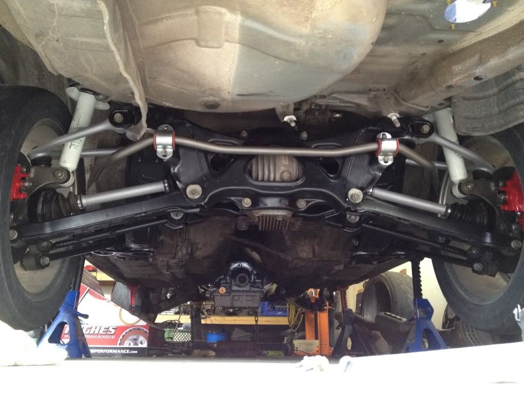

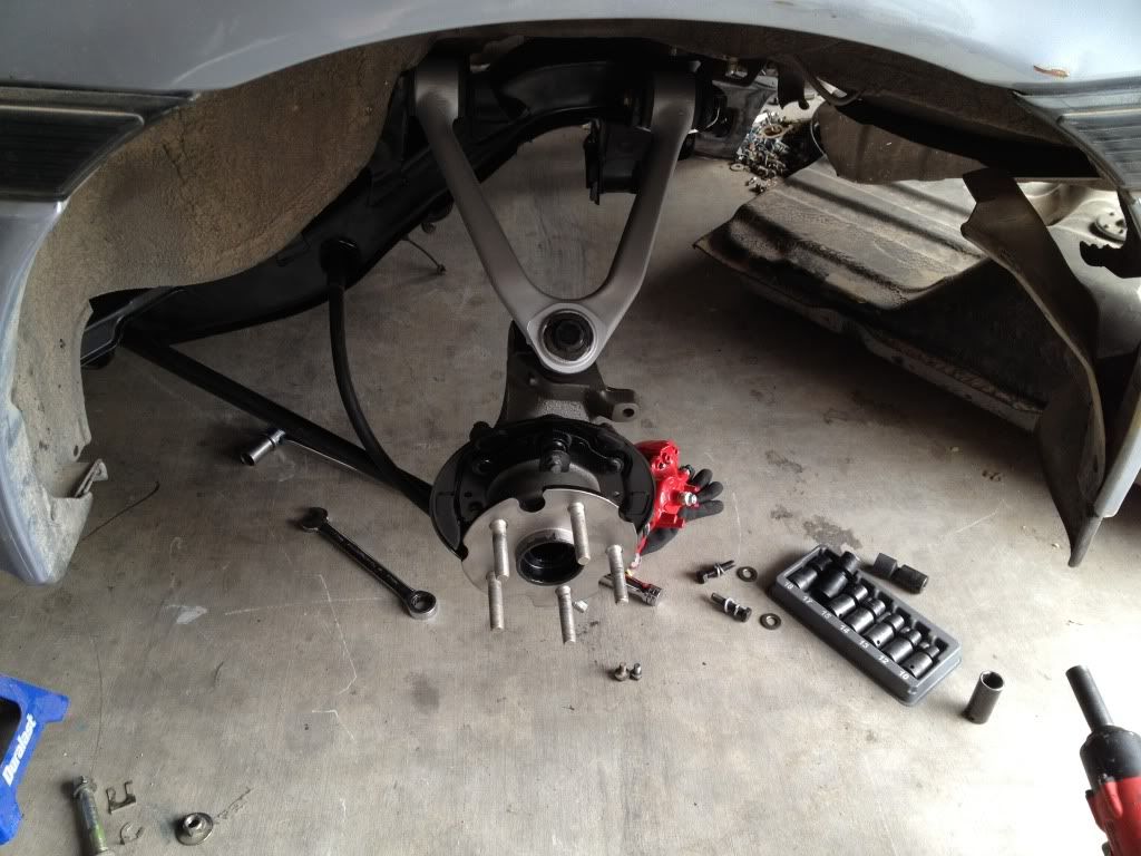

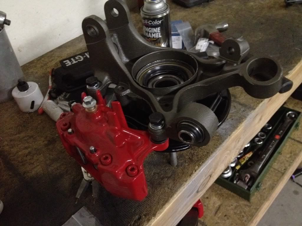

Been busy with work and buying a house and moving. Got the car on the ground ready to move aswell as some other stuff. Solid bushings in.
Rear spindles together. New spherical bearings, wheel bearings & seals, poly trac bar, Evo/sti setup.

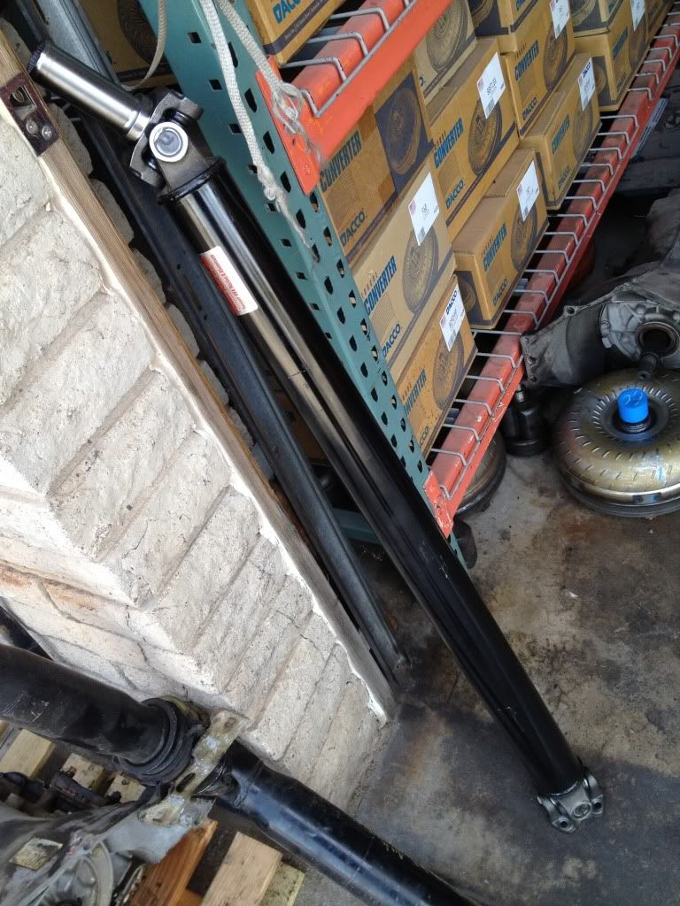

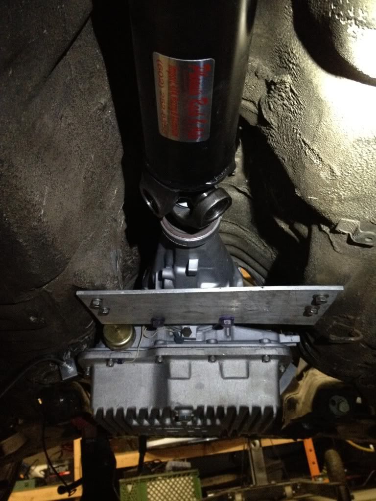

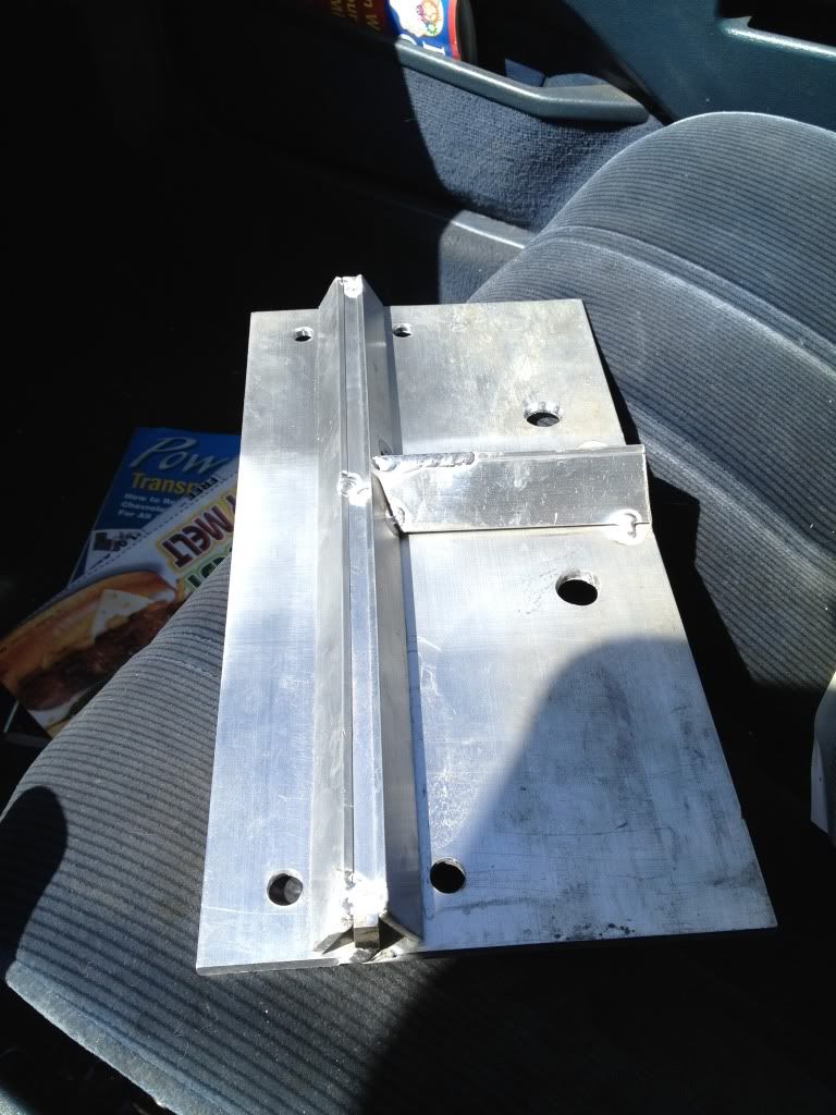

Got my tranny tunnel hammered out, tranny mount made aswell as my driveshaft
Steel, 2.5" DOM, 1310 ujoints, only 4.5lbs heavier then aluminum.
Tranny mount tacked up

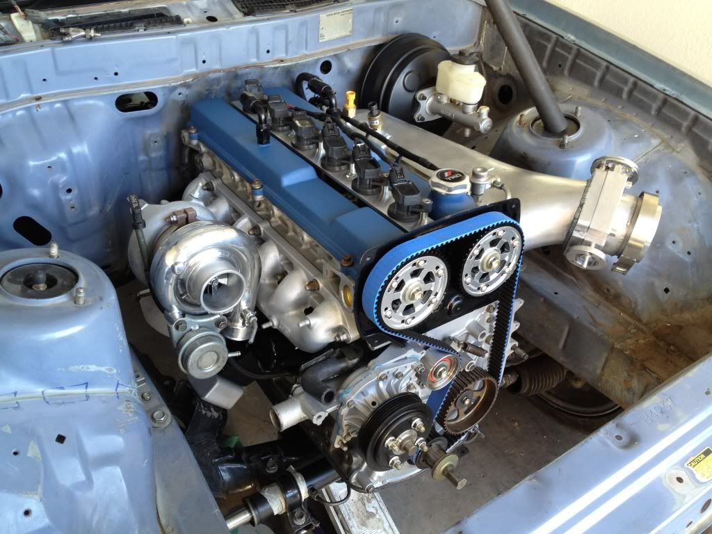

Looks awesome!! Coming together nicely.
When is the manifold gonna be made so you can mount on the turbo!?!
Weld up your FFIM!!!!

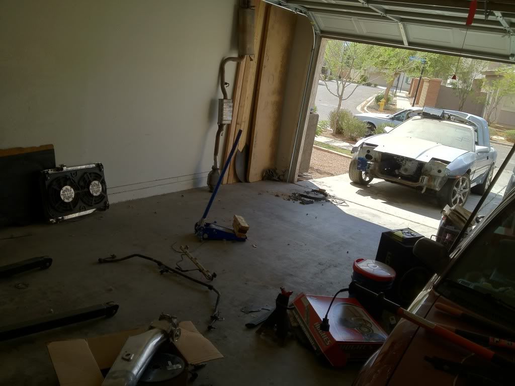

All that stuff will be after the move.

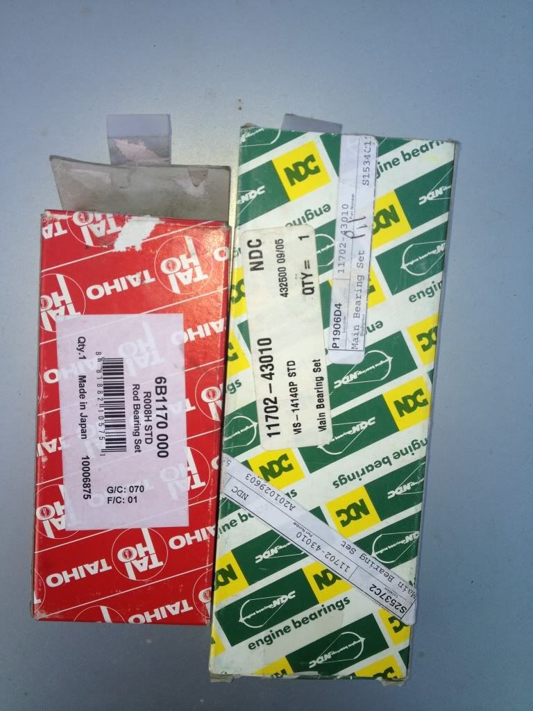

Everything's ordered to start the engine once we move. Got some NDC bearings, brad penn break in oil.
Just need to put it all together and finish wiring.

YES Dude. I've never even seen that car sitting on it's own weight before. That tranny mount looks sweet, did you make two? :naughty:

There's a distributor here local called world pak. That's the sticker on them, though I did not personally order these.
All the clevite bearings I've ordered in the last month have all been NDCs
IanC
Jul 13, 2012
101
Maryville, TN
WorldPac is owned by CarQuest. They deal in OES (original equipment suppliers) parts. You can go to any CQ and get original parts for most imports. Pretty cool setup.

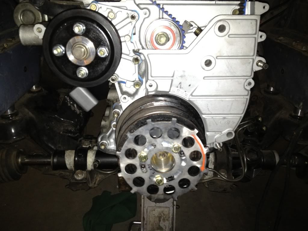

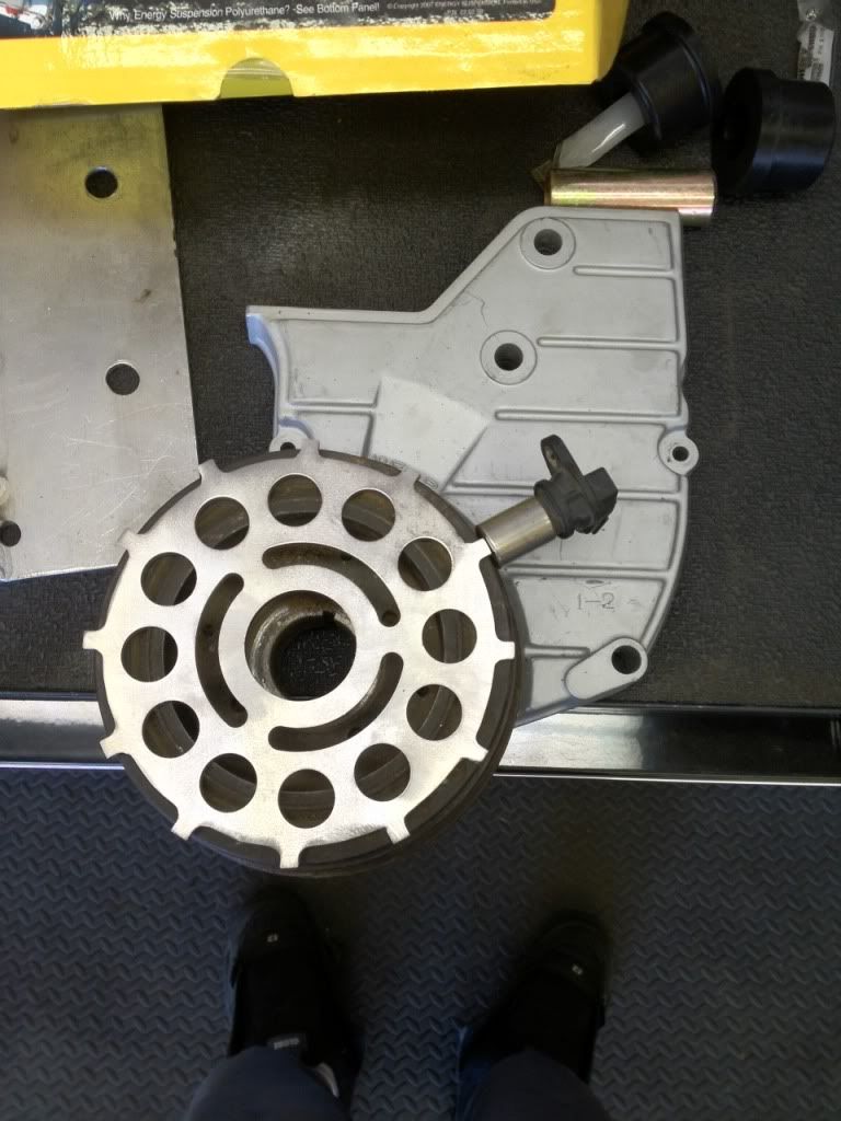

After making Alberts exhaust, he made this for me. Got the trigger wheel from trigger-wheels.com. Was a 36 tooth and had to cut 24 off to make it a 12 tooth.
It is adjustable if needed to help dial timing in outside of the ProEfi.
Will get a pic of the actual bracket tomorrow.
