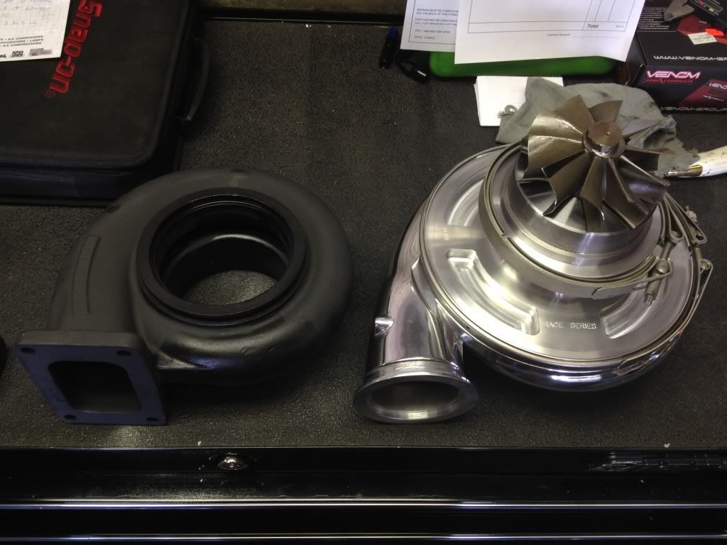

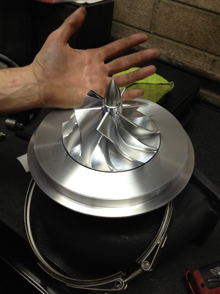

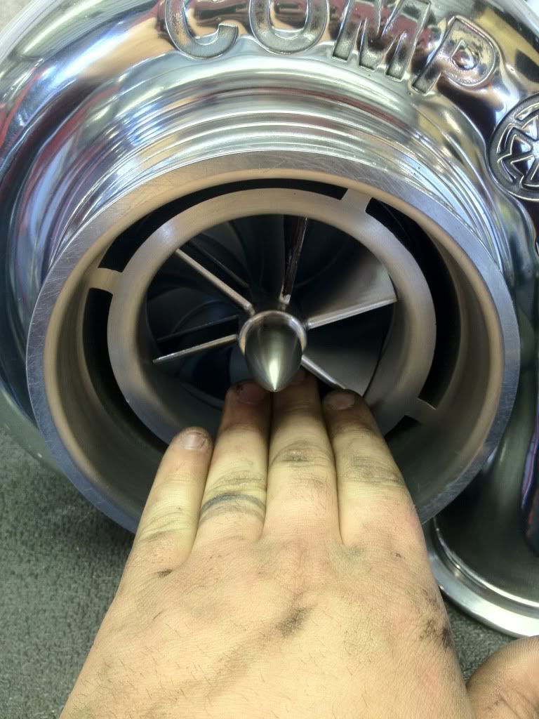

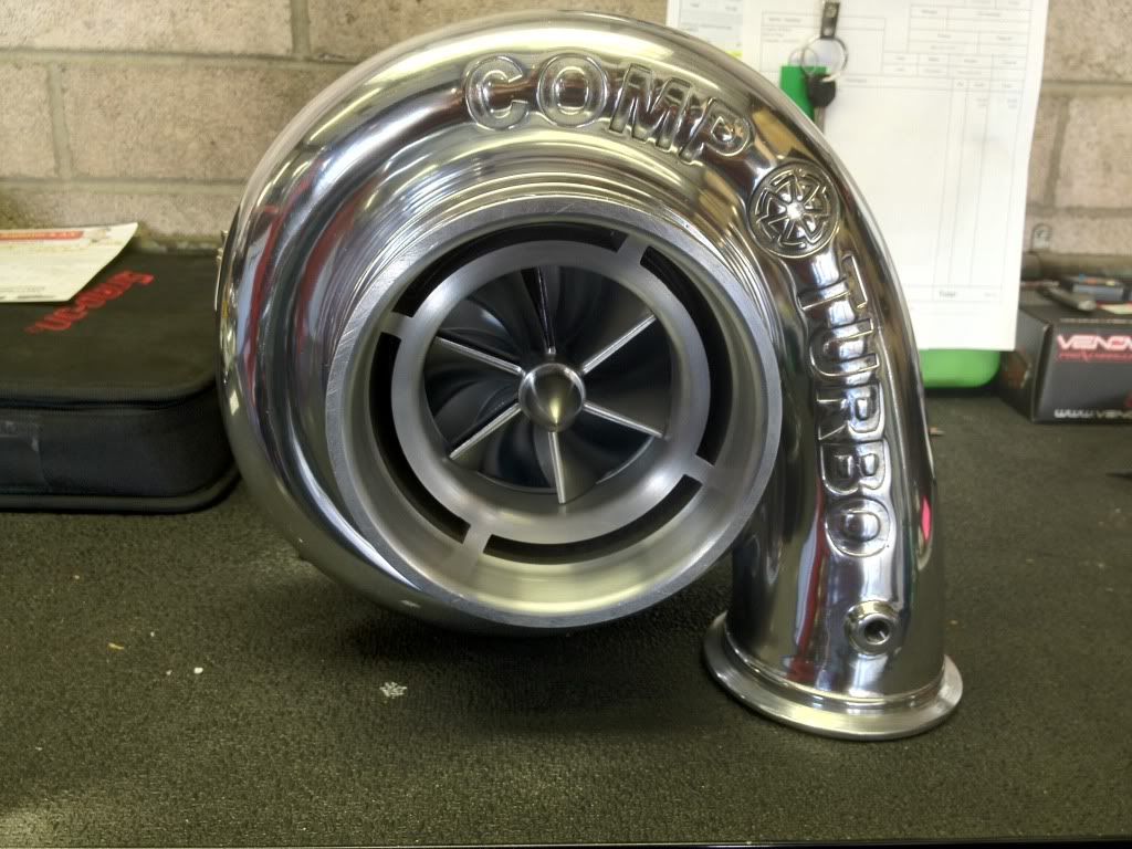

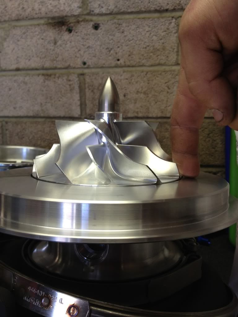

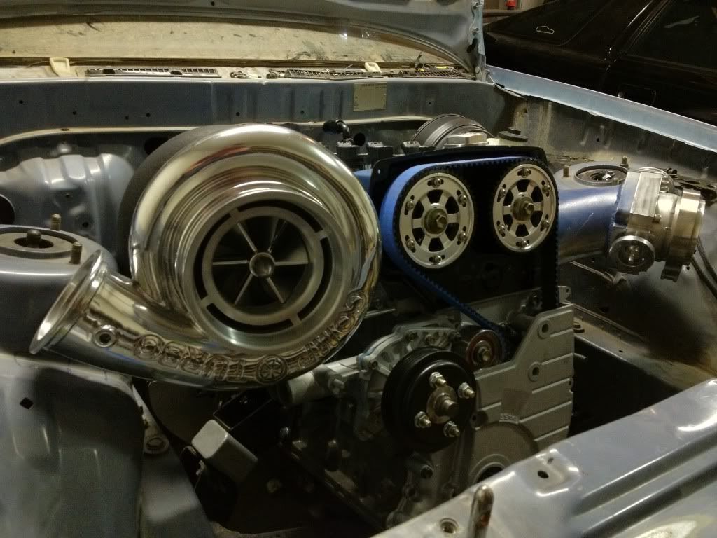

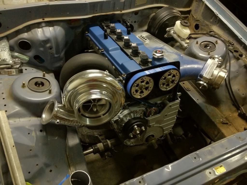

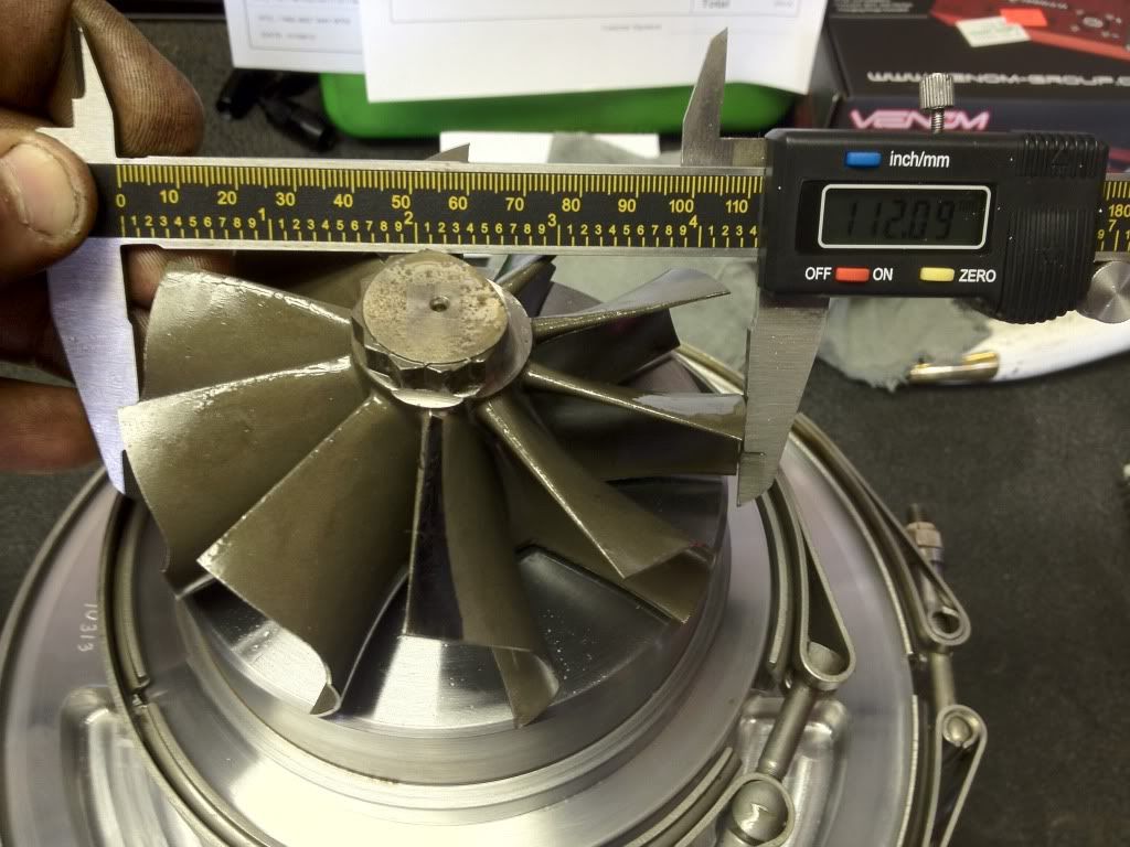

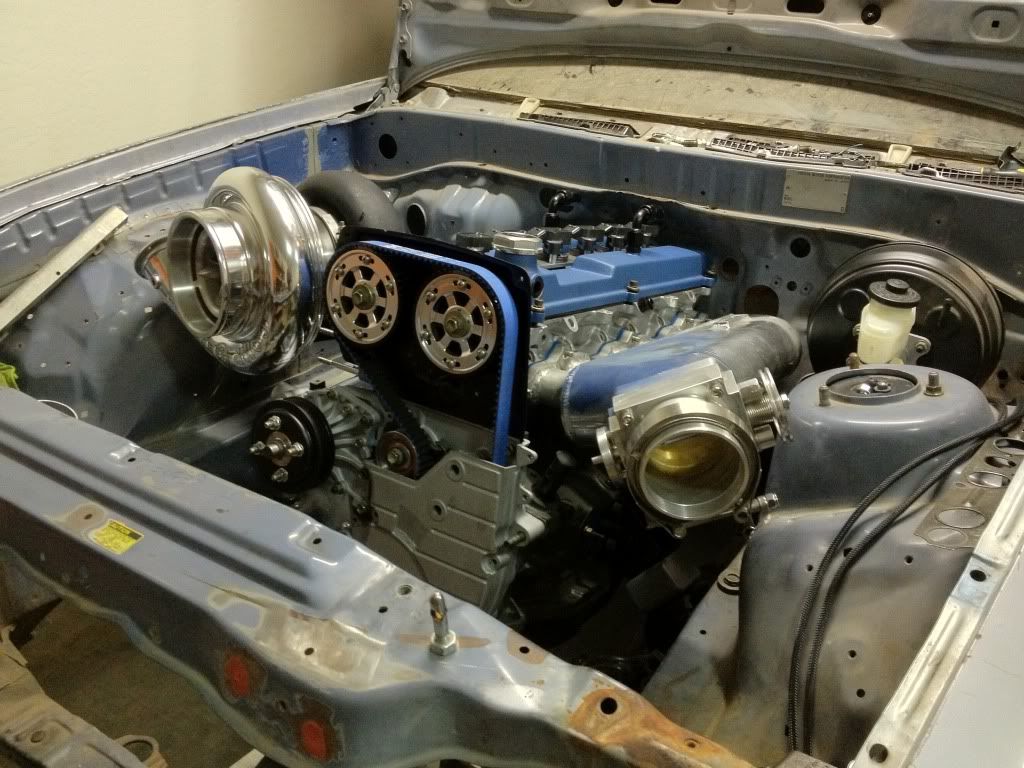

Finally have an update
Brand new Comp Turbo CT6X 94106
-Triple ball bearing
-Aluminum bearing housing
-Billet X-HF Wheel
-Bullet nose
-T6 Divided 1.25 A/R

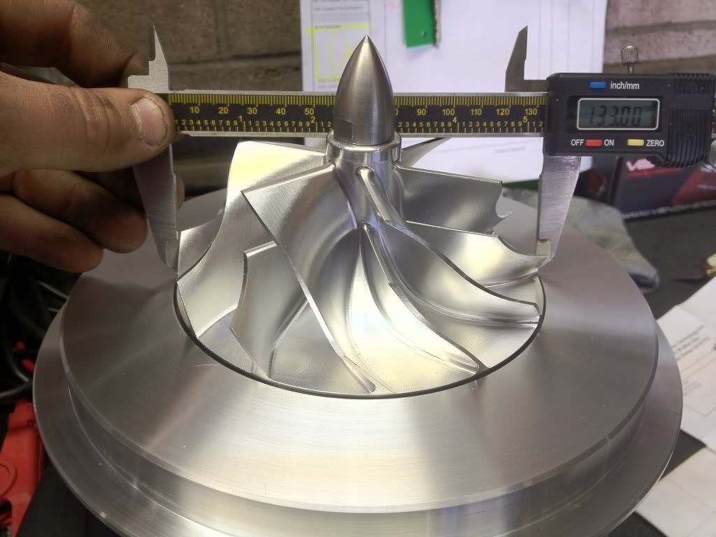

-94mm compressor inducer
-133mm compressor exducer

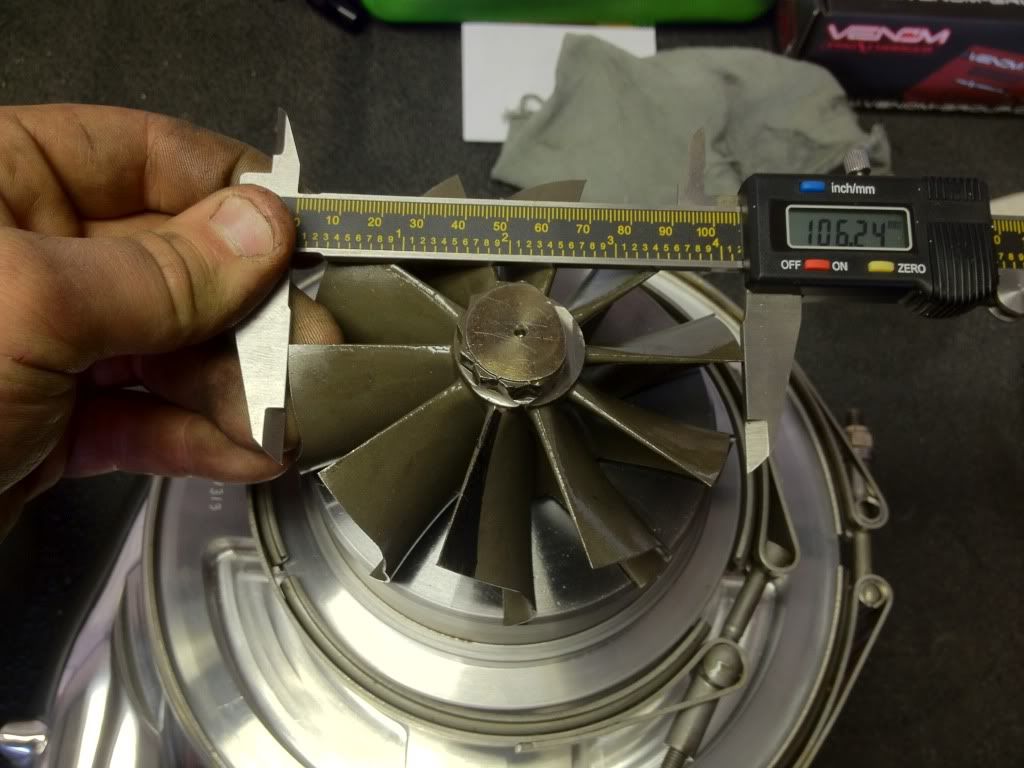

-106mm turbine exducer
-112mm turbine inducer
-6" inlet. 3.5" outlet, 5" exhaust
