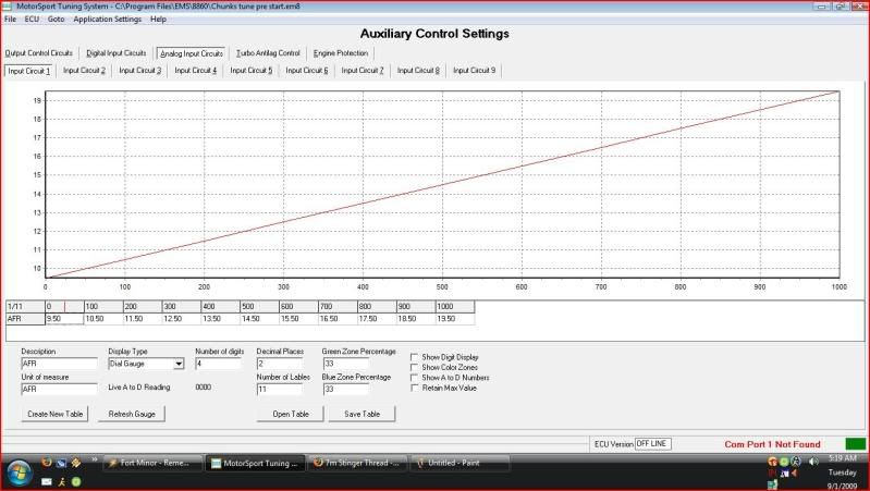

Anyone make any tables for auxiliary inputs yet? I went with the 8860 but for some reason when i try to enter a number into the auxiliary input table it has to be a whole number or else when saved and reopened it will have rounded the number to a whole number.
For instance i made this table for the linear zeitronix output:

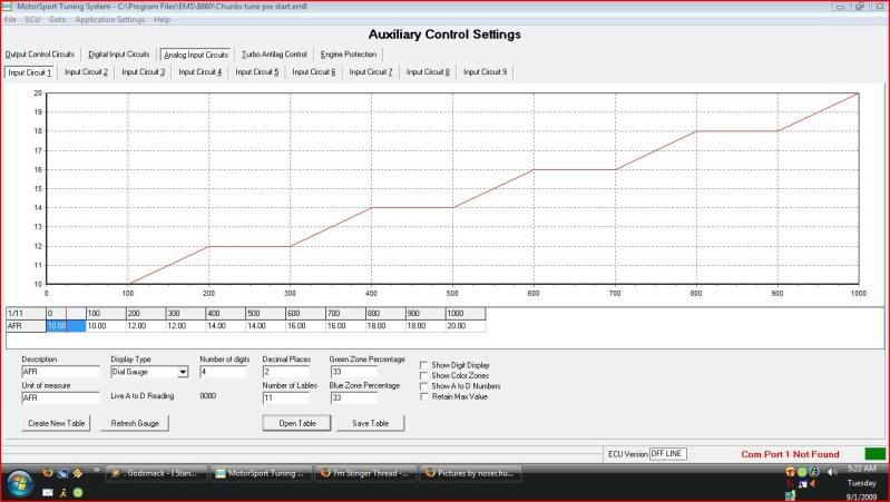

But when i reload the table it looks like this:
It does this if i reload the table or if i save the tune and reload the tune itself
It rounds the .5's either up or down and ruins the table.
Anyone else notice this or have this problem?
