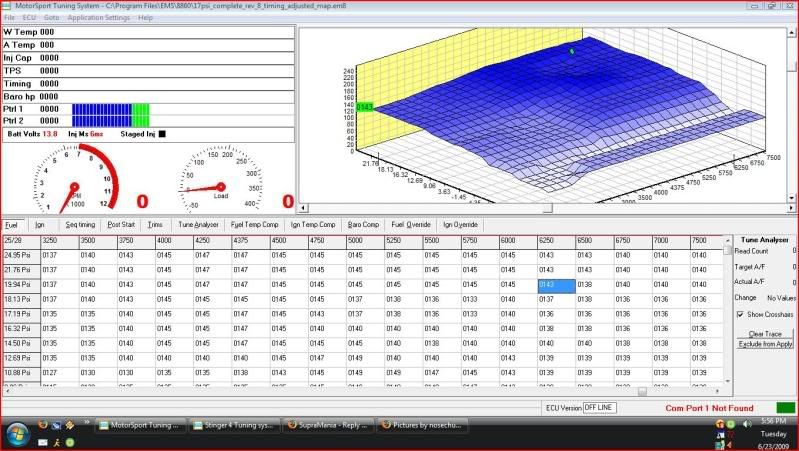

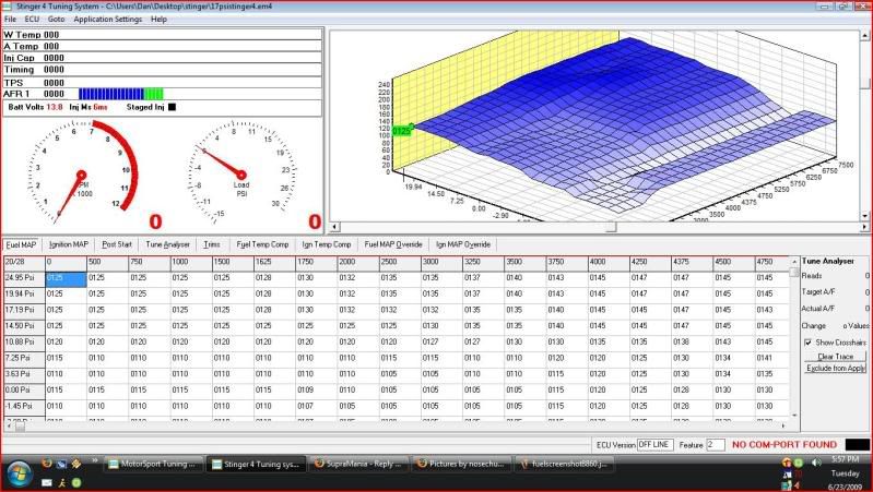

Disturbed figured out the difference between loading it in version 4 and the 8860 software. the version 4 software cant plot enough load points so it cuts it off at -10psi. thats why they look different. Otherwise besides the added features and larger maps i think the 8860 and version 4 software are the same.
Is the 8860 (6860) worth the extra cost? i like the extra in/outputs but i dont know if i can justify the cost just for that.

I changed your save file around to suit the stinger 4 software. the issue was you have more load points then the stinger 4 can use so it was cutting off the bottom of the chart.
8860 screen shot
stinger 4 screen shot
you can see the stinger 4 doesn't have the same resolution while in boost but the load points i removed were within 1-2 psi of each other and the points are still interpolated smoothly automatically by the software so shouldn't be much of a difference at all. i didn't remove any of the vacuum load points because thats where the driveability is tuned and that resolution could make a difference.
And if you want to use this file in stinger 4 heres the file everything is the same just some of the on boost load points that were very close together are removed everything else including options are the same as disturbed's original file. To use file download and change file extension from TXT to EM4.
