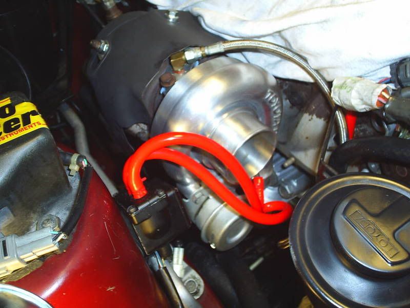

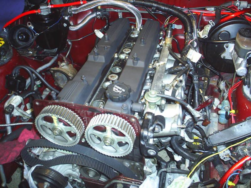

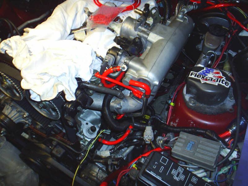

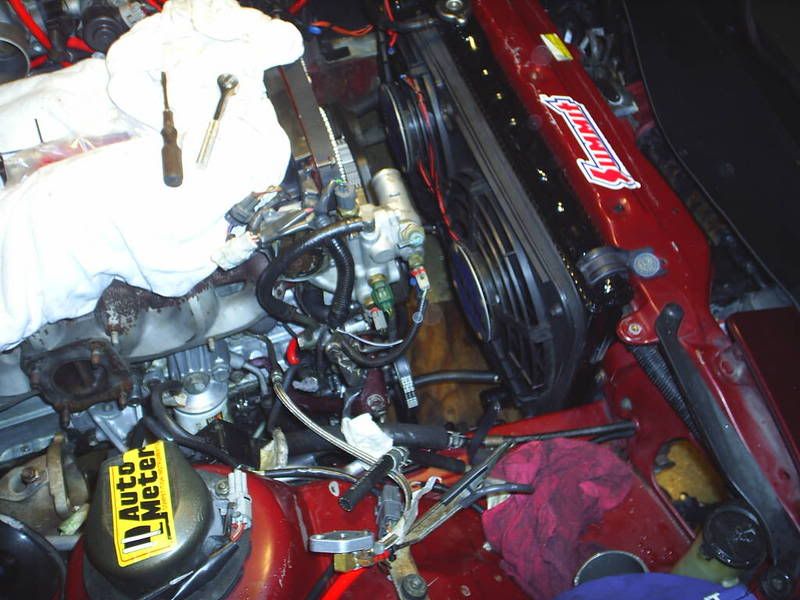

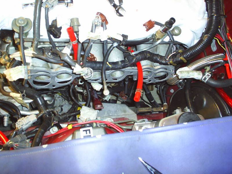

more progress
the beggining of the finishing touches
cleaning and prepping the intake side

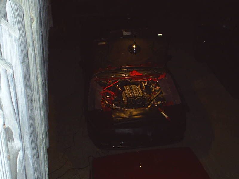

this is my workspace. i need a garage BAD.

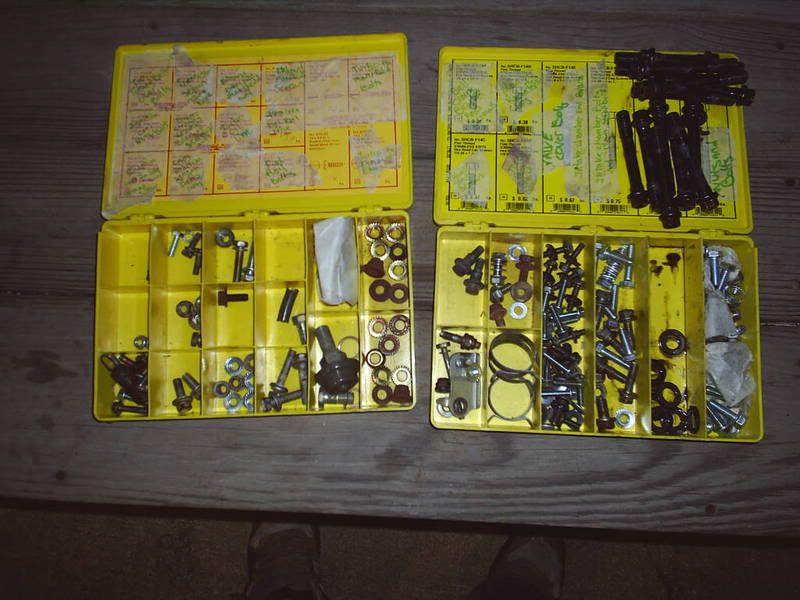

all the old and new hardware for the motor. aith the ARP bolts
intake manifold on
sneak peak at the valve colors and the 2nd paint color theme along with the red and steel braided hoses
prepping the intake manifold and wiring harness for the intake chamber
and thats all the pics as of right meow

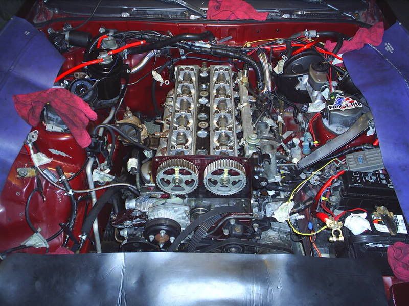

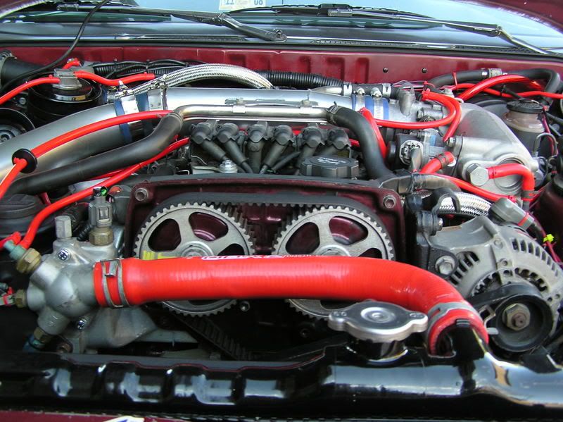

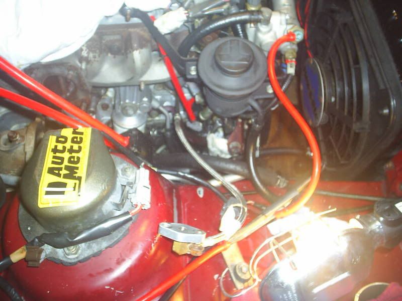

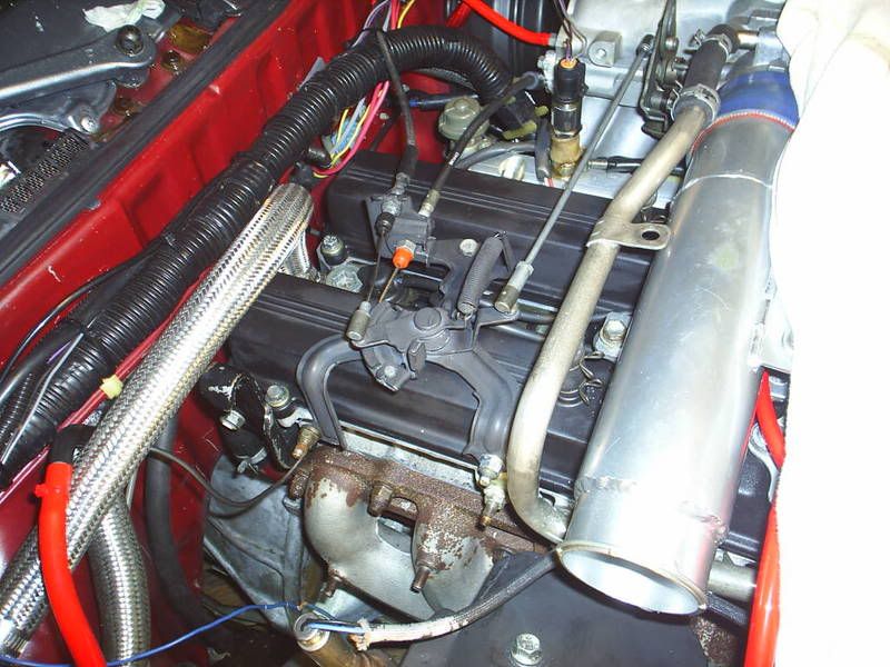

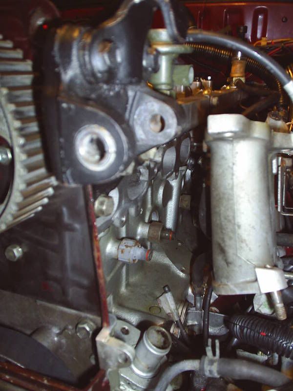

intake chamber installed, and all new hoses.

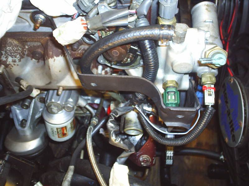

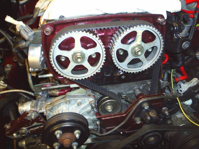

timing belt
thermostat and cam position sensor all wired back up with the power steering reesivoir bracket in place
final product of that

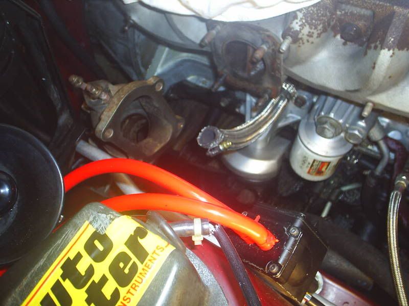

new turbo oil return line.
and omg its so pretty

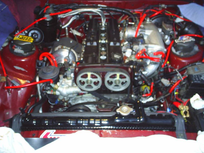

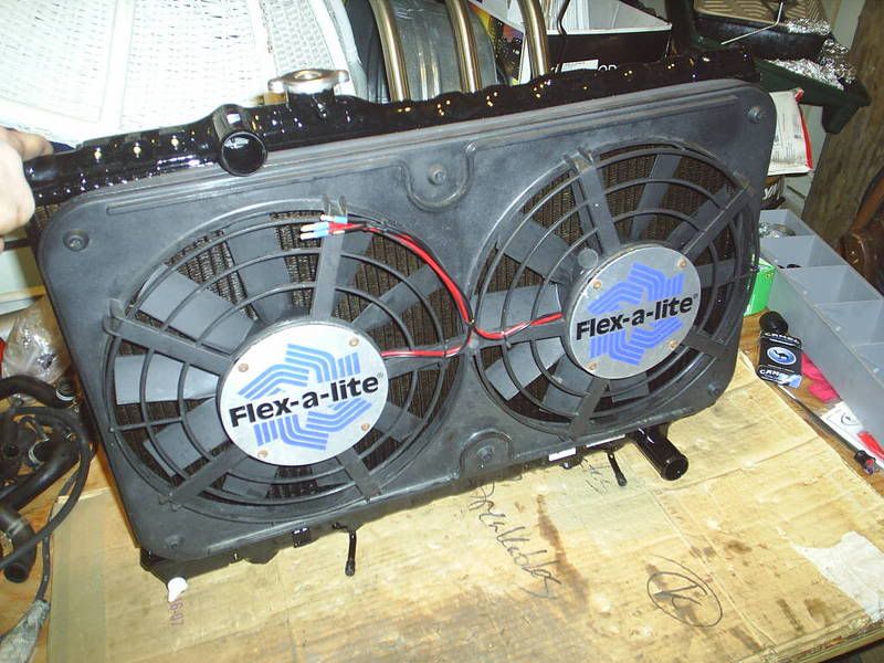

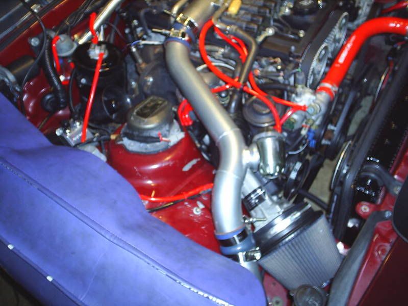

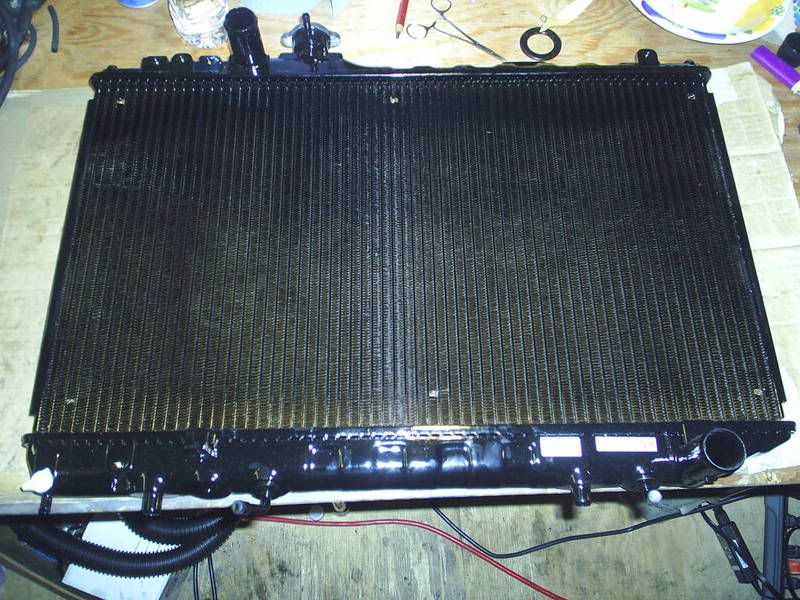

now for the rest of the pics in the early hours of the morning which by the way had a dense fog everywhere
new rad
the setup
the product

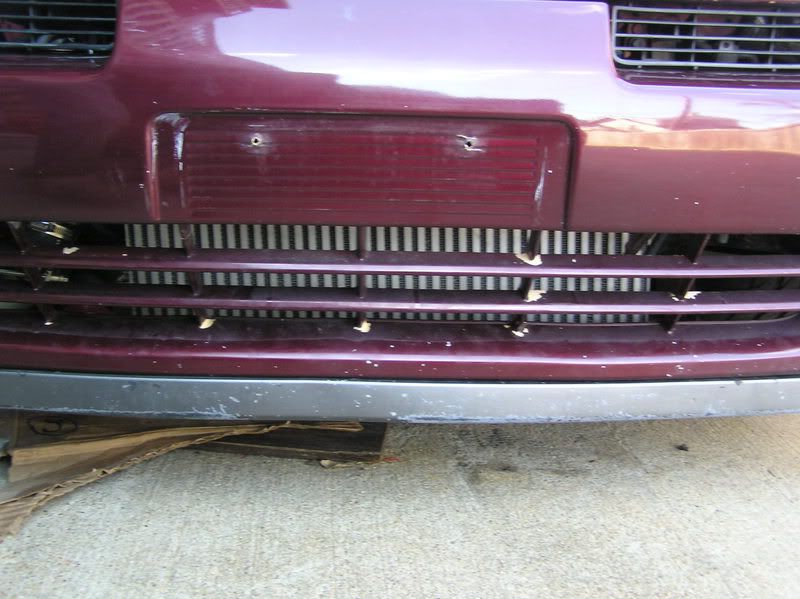

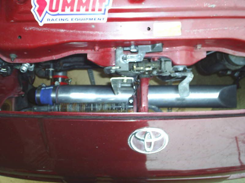

the intercooler setup, which i have to go back tonight and tweak because its rubbing on the axle boot
looks pretty good though. i have to order more parts for the system including dif hose clamps and boots
progress
and more progress
i think i have been infected by the supra:1zhelp:
i can't stop
sorry for the slight pictures fuzziness, coulda been fog or oil........ or anything in or aroun d the vehicle

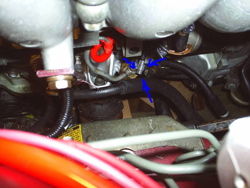

Q. what is the purpose of this wire? it wasn't hooked up before the headgasket blew either. it is in the same place its been. i can't find anything it would go to.
its below the intake manifold.

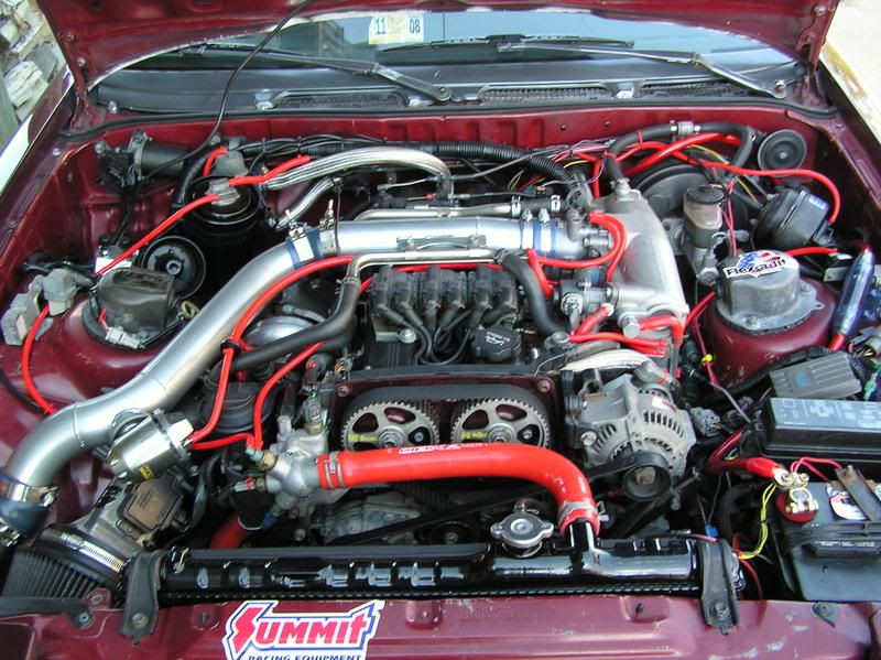

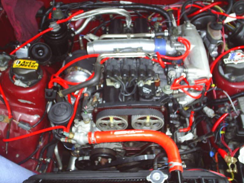

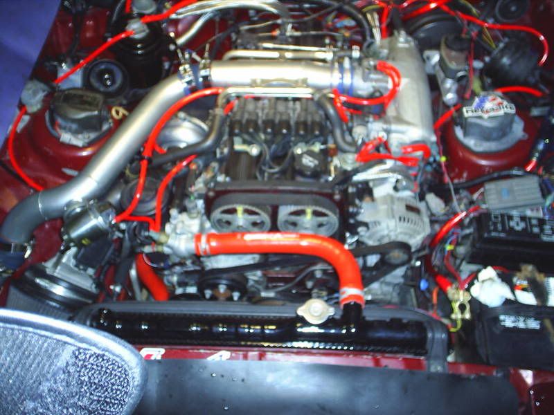

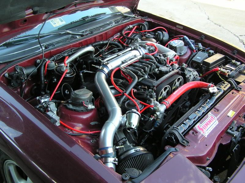

the final phase.
everything just got put into the motor, all the lines, hoses, and wires were conneted. intercooler pipes were being a bitch, i need like 4 45 degree angle ones and its a little tight, but it will work for a week. filled the coolant, oil, and powersteering.

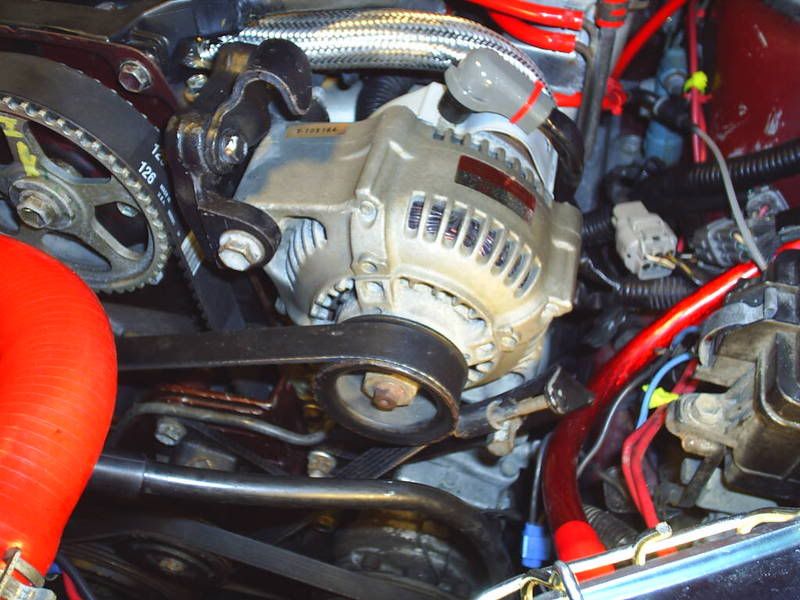

alternator, and hose behind it
intake and intercooler piping hooked up
sorry about the blurry pic again, but i will have a way better camera for tommorow and will have really good pics
then i hooked up the battery cable, went through everything to make sure that its all hooked up right and whatnot. then i proceded to start it. it took a couple cranks, then slowly picked up. then through the crack in the hood being up, i saw fuel spraying upwards by the intake. one hose on the fuel rail wasn't tight enough, and on the cold start injector. then started it again. it was running a little rough on the low side, i had to give it slight amount of gas too keep running. that might just be the idle though. i know i have to go back and adjust the timing a little bit. then i shut it off and noticed that the only thing leaking was the oil hose at the oil cooler spigit. i will tinker with it tommorow.

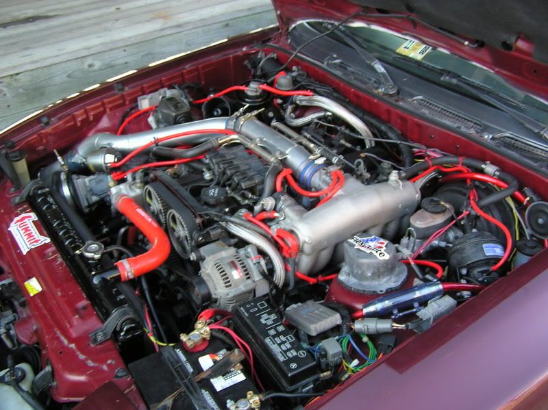

okay guys. shit just hit the fan again. today, i got the call from the shop. decided to go pick it up. they pulled a code 51 from the ecu, determined that the CPS was pretty much shot, got the timing correct with(get this 20% retardation):3d_frown: then a couple little nicknacs. car was running fine and i was driving it about 30 miles from there to home. it had a slight knocking sound at idle, but i kept a VERY close ear to it, started driving it home, and amongst the most awesome feeling in the world driving it again, i stop at a gas station and put more coolant in, and check the oil. oil was Low so put more in, then proceeded, turned out of the gas station and down the next street where i started hearing a more or less NOT COOL NOISE and then the car completely dies. i opened the hood and saw that the timing was thrown off again with the exhaust cam being at 50 degrees from tdc and the intake being about 20 from tdc. i checked the crank pulley and found that the mark was on the bottom right looking at it from the top. i beleive that the keyway or the "pin" that is in the crank pulley broke and thus therefore made the timing belt jump. or the cam pin broke. making me go more time without my car. i really am starting to get frustrated with this motor. anyways, it was directly towed back to the shop.
