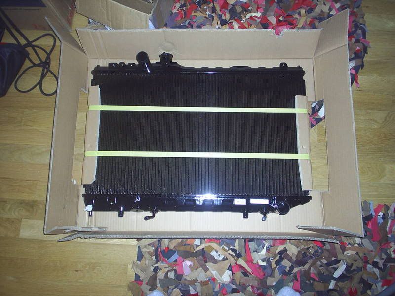

i ordered the headgasket kit, radiator, and other parts from partstrain like a week ago, anfd i just found out that they declined my order due to improper CC information. so thats fixed and now its gonna be another 5-7 business days.
fak
they anger me.

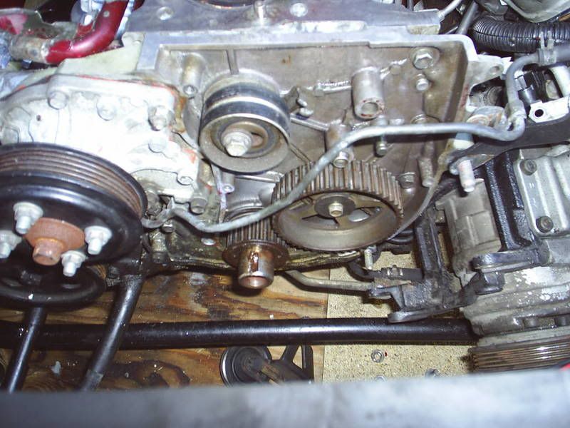

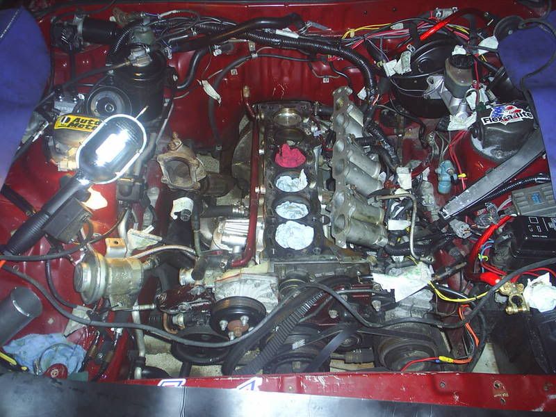

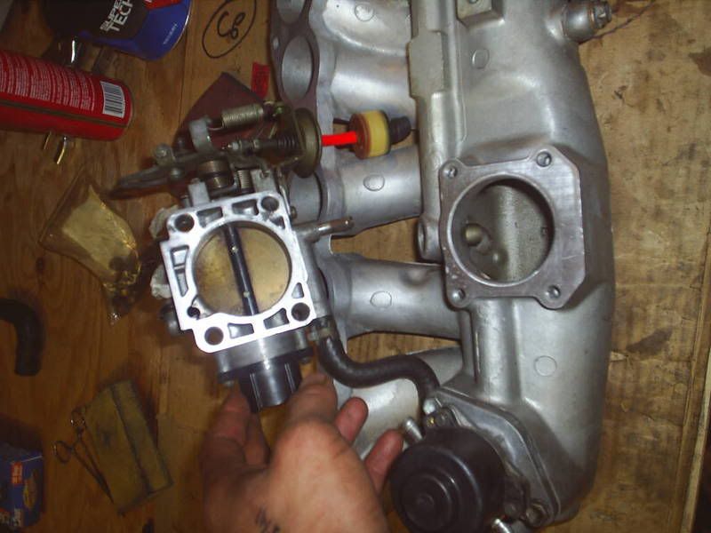

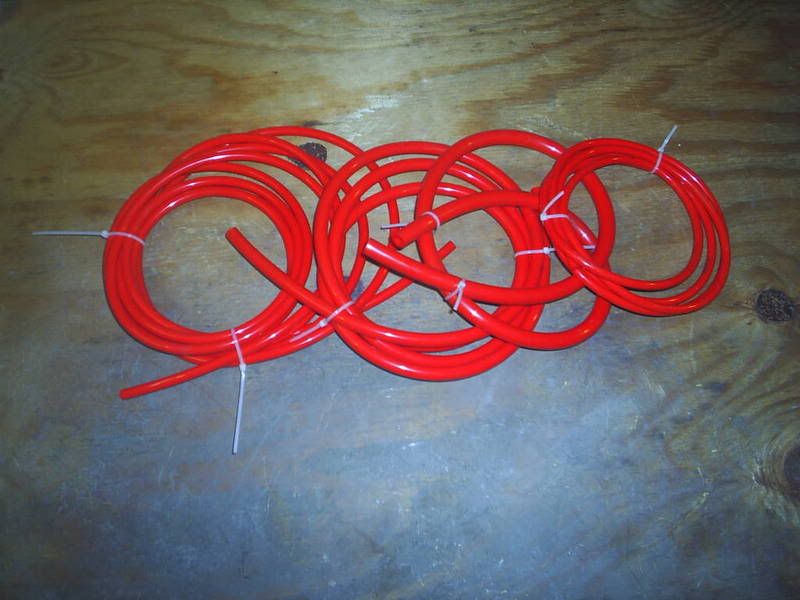

alright, been out doin things and just collecting parts. these are some, i have the other parts downstairs and the radiator, HG kit, timing belt, and various other things are still in transit.
here ya go
i think you guys will like the red theme.
when i get more paychecks, the red intercooler couplers, the red hoses, and red strut bar will add a nice touch.
and yet again, i need more knowledge on the cam position sensor. the haynes manual only vaguely does the job.
this has to be perfect
input?
besides destroying my brain with 195 proof grain alcohol:)

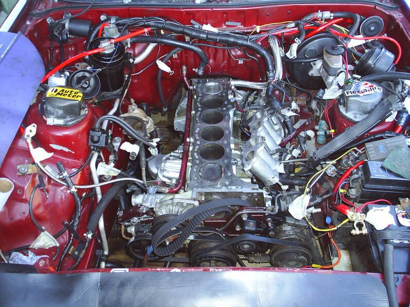

also, installing the new intercooler, i made a bracket or two but i have to move the oil cooler around.
good place to put it? because the new intercooler takes up the whole front pretty much.

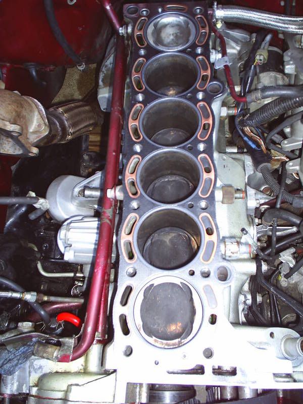

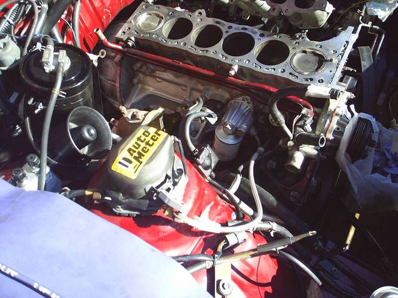

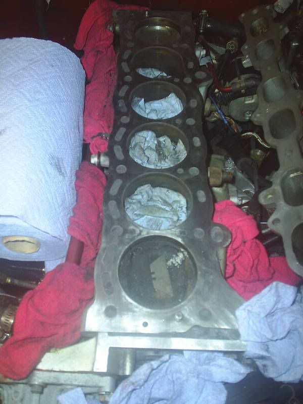

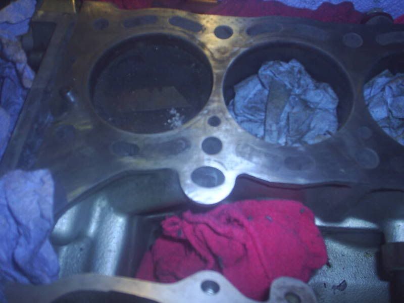

alright, i started prepping the block, and finishing up a couple of parts prepping.
at 2 am.
no more stock chipped paint. nice and shiny
before
precautionary steps

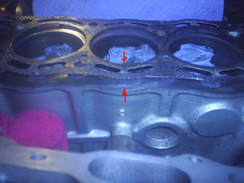

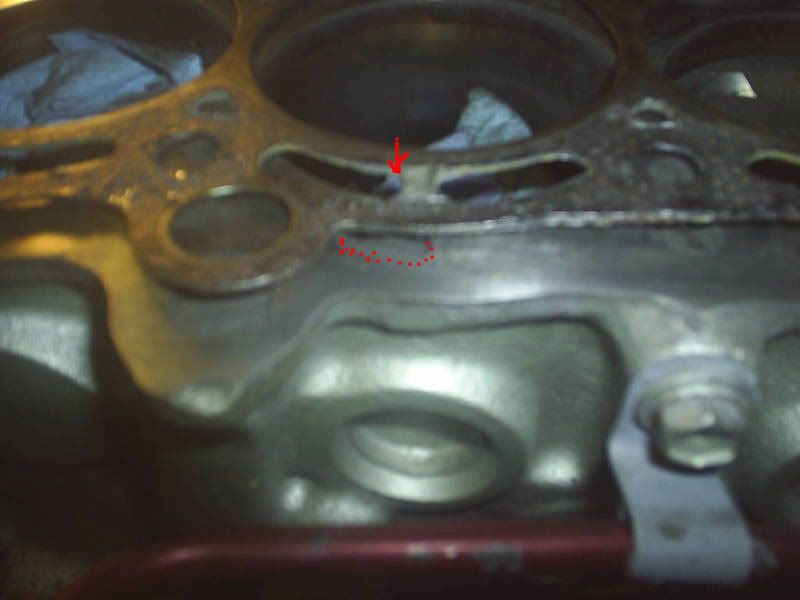

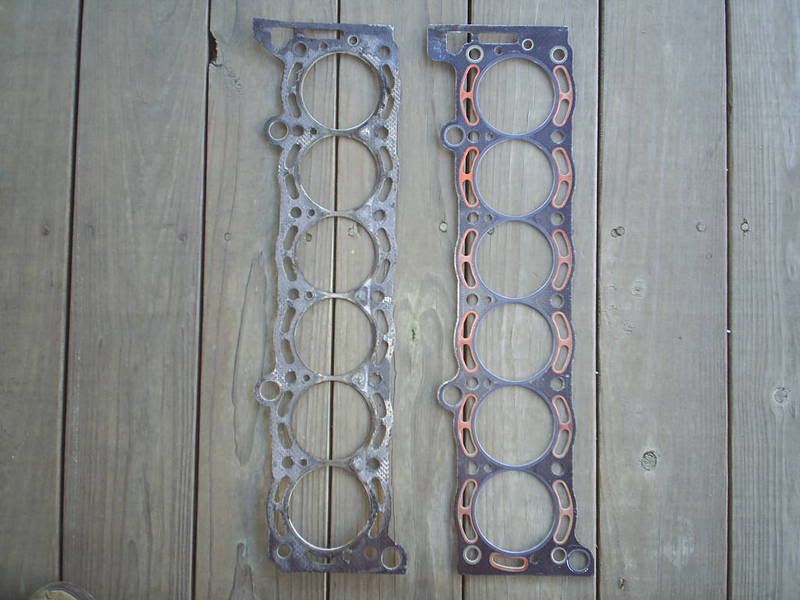

i'm pretty sure i found the culprit for the overheating and why the HG blew
on the exhaust side of the top o de block, there is two ports. on the intake side there is one port. this is per cylinder. the intake side port is a little off center on either side.
the headgasket has 2 ports per the intake and exhaust. what i found out was the little chunk of headgasket between the ports halfway blocks the ports on the intake side.
am i correct on this? or is that standard? because i just got the HG set and it has four ports per cylinder and it has reinforced ports with rings around the edge
as you can see the imprints on the block by the HG.
this is where i stopped. i am not even close to being done with it yet.

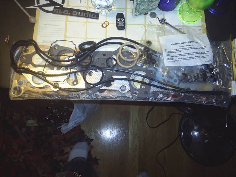

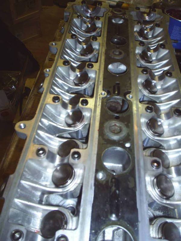

alright, i got alot of progress done. this build is almost done.
got some more parts in..... YEA!

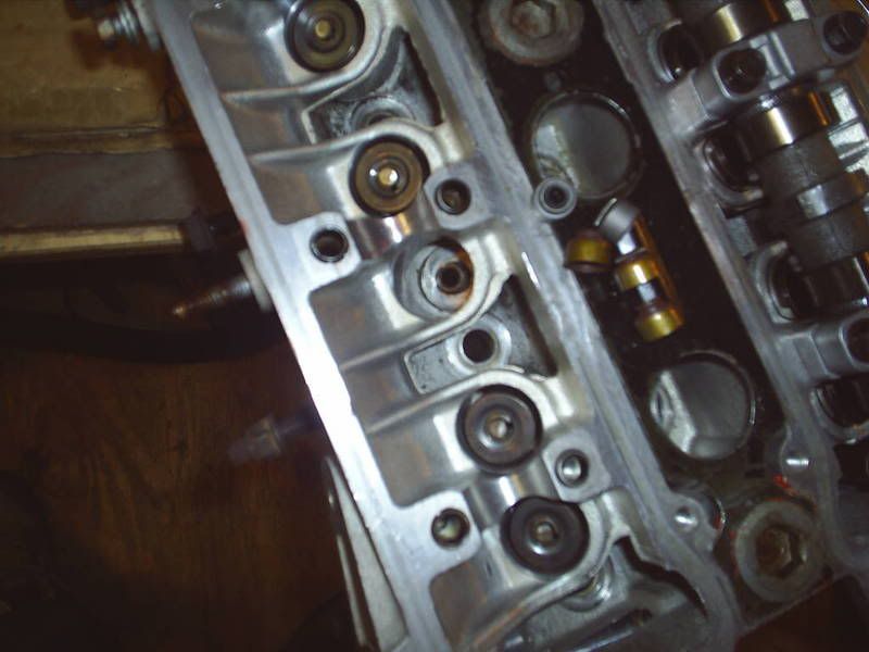

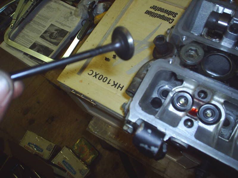

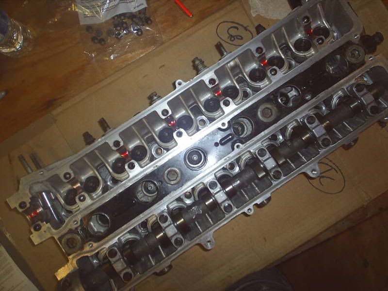

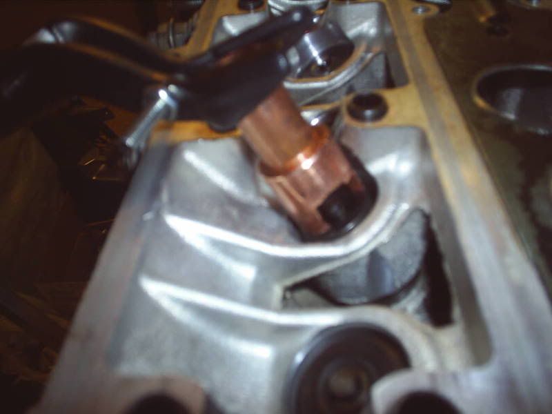

then i proceeded to just keep working on the car all night, and went buck nasty on the head. i went through and replaced the valve seals and cleaned EVERYTHING. cams and valves smooth as new asphalt.
old and new valve seals

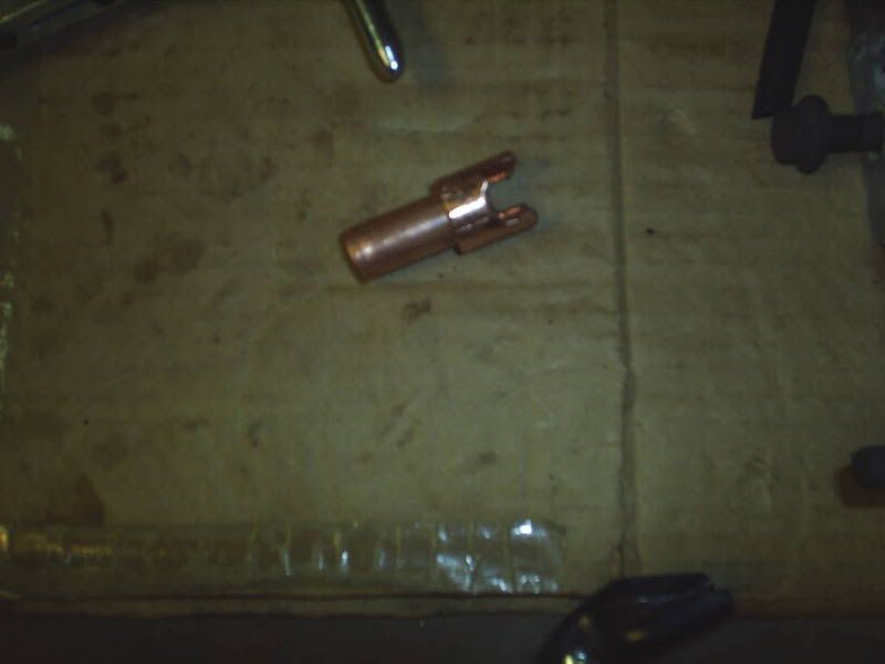

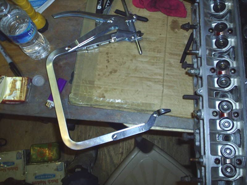

so i didn't want to buy a valve spring compressor, so i rented one and the only one i could get was the wrap around the head kind. it did'nt reach to the valves so i made a jahoosawathingamajiga to help me.
this
plus this
equals
worked really good actually. i had to use a magnet and surgical needles to do it though..........
the valves were in really good condition except the #6 from the BHG

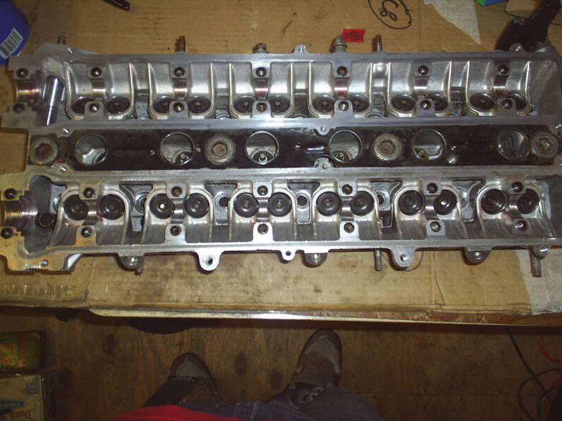

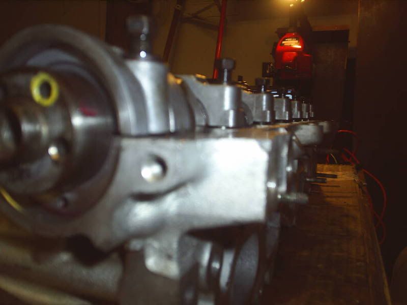

before valve job and cleanup
after the cleanup and regreasing and oiling
ready for the torque down

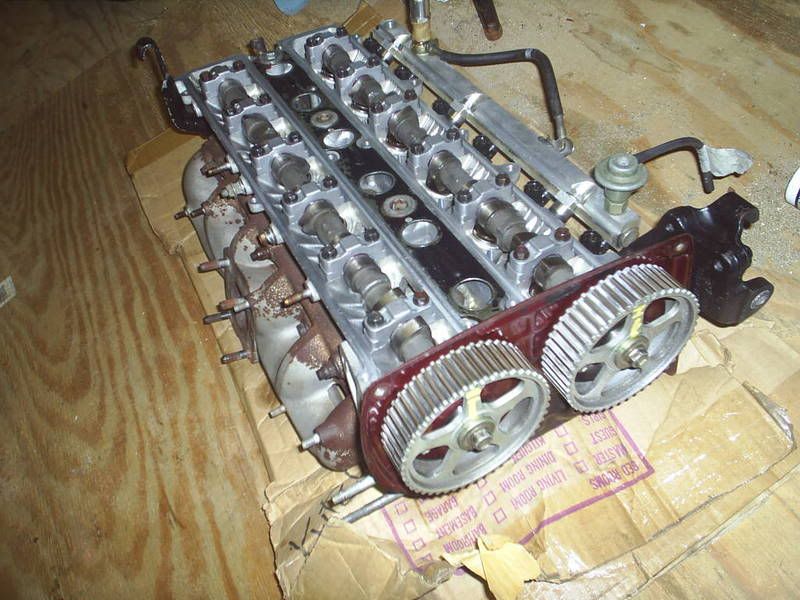

and then reassembled head

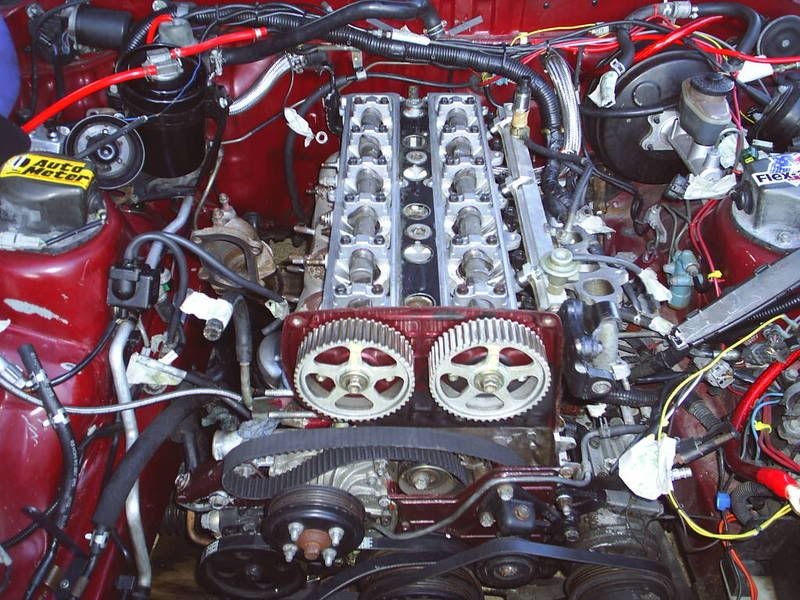

replacing the timing belt.
the block ready and some hoses installed.
old to new
mhmmmmm that looks nice
and this is the last pic of the progress so far. head isn't torqued down yet. i had to go to work. ill do that tommorow
