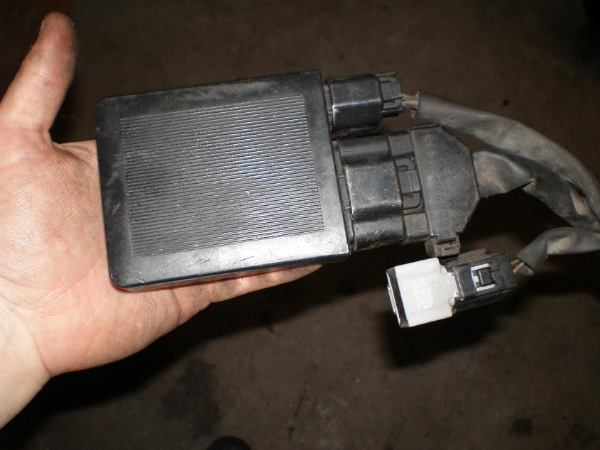

I have a question regarding this plug on the Aristo 2JZGTE harness:
The plug with the white thing in it. What is it for?
