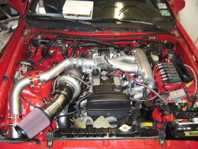

yankiwi
Aug 27, 2005
221
DFW
Here's my progress...
I have fixed my fuel injector leak, I pinched one of the o-rings on installation so I replaced it. All good now.
I initially fired it up running an earlier software version on my Maftpro, 4.40. It ran but it was stumbling and surging, with poor response. It was also lean... I spent too much time today figuring out the damn USB-serial BS and learned how to update the Maftpro and now its on version 5.00.
It runs better right away. Smoother idle and better response with just the base settings. Tuning will be next.
I have a 3in flex section on order to finish my exhaust and I will get it on the road!!!!!! Looking forward to learning the pro and making power.
Here is a pic of it completed, and a short vid of the startup, still open downpipe so it's loud.....
