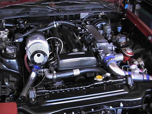

i'm kinda worried about the spool time on it. it's the T70 ebay turbo. for the price it wouldn't hurt to try it. if it fails i can put the twins back in. then save up for a SP turbo. i'll also rotate the housing today so the oil drains straight down.
i have one of those hks copy wastegates... how do i hook up the vacuum lines to it? there's one on the top and one on the side.

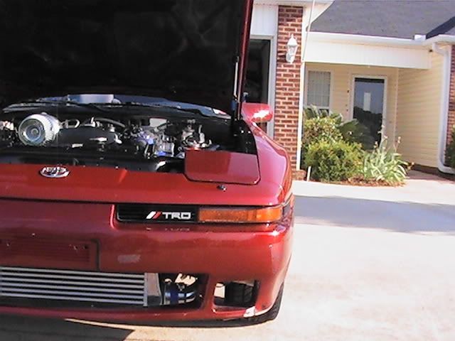

MY HOOD WON'T CLOSE NOW....i guess i need to buy a t4 turbo so i can get rid of the T3/T4 adapter.

i thought it looked like that turbo was sitting a little too high with that adapter. i had the same kinda thing happen w/ my z car when i put the pathfinder intake manifold on it but you cant just get rid of a piece and have that kind of a part work right! so i had to shim the hood in the back about 1.5", at least you dont have to do that! :D

and where the turbo is i can't just cut a hole in the hood and put on of those air vents over it.
do you think if i bought a T3 weld plate and had it welded right on top of the T4 flange on the manifold it would be alright. or i can buy a T4 flange and weld it onto the turbo T3 housing.

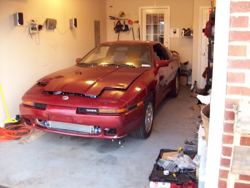

well, here's that latest and greatest.
right now i'm at apoint where the engine will crank. but i can't start it yet till i get a few more things. the wiring kicked my butt, but i won't know for sure if it's all right till i try to start it. i am so close. when i come back from tdy i'll have enough money to finish her. so now i'm expecting to get her done by the first week of june. the major part i need is a custom downpipe made.

I dont think the turbo wouldnt hit the hood if you either get the right header or had a 1jz cuz its over 1½" shorter in height.

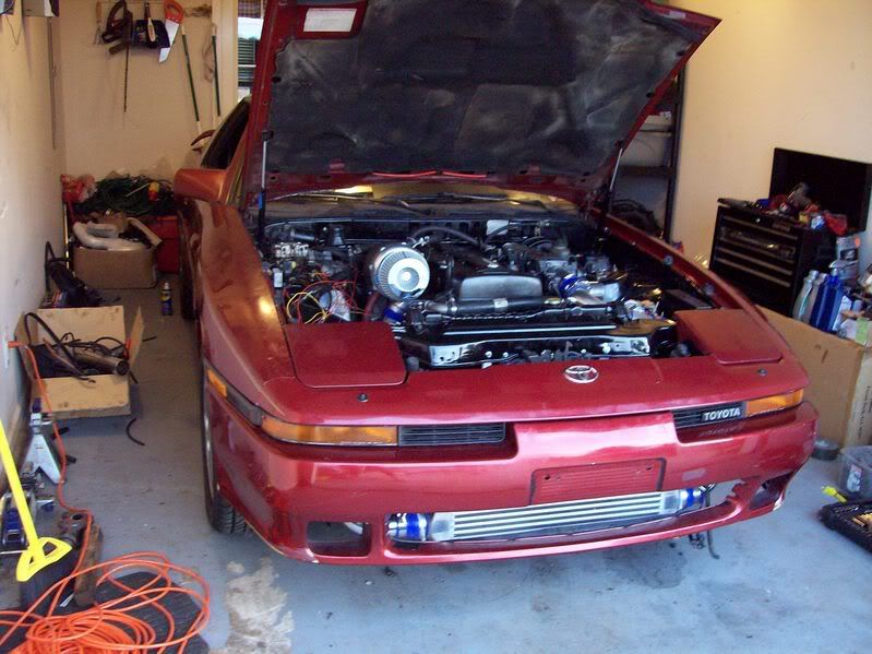

lot's more progress. the engine is running but really needs tuned.
all i have left to get is a wideband and downpipe. what tranny fluid do you guys put in your R154? i need that too.
after all the wiring headache... the only thing i messed up on was the fuel pump. i had to hard wire it with a switch. and to confirm. the mk3 fuel injector resistor does work.
car sounds badass, course i don't have any exhaust on it yet

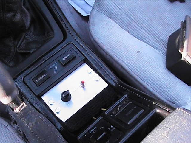

alright, so the TPS is fixed. i went into the AFC and adjusted settings in it. so now it shows 100% when WOT. but... does anybody know which signals i need to create to make TEMS work with speed and braking and all that happy stuff.

Theres only three wires from the ecu that feed into the TEMS. The other ones look to be independent. Ive been looking to see what the wires that come out of the TCCS that feed to the TEMS actually "say" but I cant find it anywhere.
http://www.cygnusx1.net/Supra/Library/TEWD/MK3/manual.aspx?Section=Main&Page=115
Thats the tems - TCCS pins 17, 18, 19 if you have a turbo. B1 connectors 2, 3, 4 Look at connector B1:
http://www.supras.nl/index.php?option=com_content&task=view&id=34&Itemid=50
You probably had that already and I havent been any help - I dont know what you are going to do to simulate the signal because I dont know what the signal actually is!

yeah this wiring is a little on the hard side, but do you know what wires to jump to make it stay in full firm mode. i've seen a thread about it before, i think on SF though. at least i can make it stay in which ever setting i want
thanks for the help though, looks like it's kicking your butt too...
