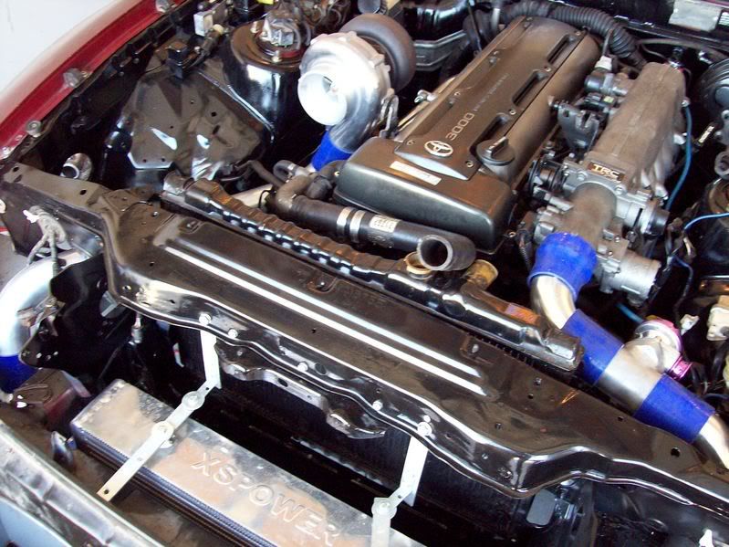

dont remove the sway bar unless you drag race the car only!
you will have an avantage on launch if you remove front rear sway bars drag only.
when you drive on the street your car will handle like crap and have insane roll.
use spacer or washers on your motormount see if you can get your whole engine to move up a little bit or get a smaller crank pully like an underdrive crank pully
tsuper92
supra addict
Apr 7, 2005
1,376
mass
if that sway bar is moving up and down near the crank pulley,it's your suspension that has a problem.the swaybar should only twist a little there,not move up and down.
bigaaron
Apr 12, 2005
4,692
49
Pomona, CA
www.driftmotion.com
You must not have a transmission on it yet, because the engine is tilted forward. The valve cover is above the lip on the firewall, that's how I can tell. Once you put the trans on and bolt it up the engine will tilt back and away from the swaybar. :wiggle:
crazysupra2JZ
Nov 16, 2006
740
Georgia
really. you're right the tranny isn't connected yet. man you're awesome. i was so worrid i'd have to spend another $500 just to get a new crank pulley... i didn't even think about that. i don't have the flywheel bolts yet. or the clutch..waiting for 935...geese. but i got the flywheel bolts from driftmotion. should be here wed... i was wondering why i couldn't find any info of other people having this problem

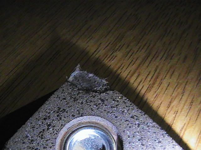

well, finally got my clutch. but i'm a little worried it might have to go back. here's a pic why. so far i'm not impressed with spec. i found 2 things i didn't like about their clutch kit. and i didn't get any paperwork with it too. i'd liked to have had documentation with it but oh well.
boostadikt
Freeway Foreplay
May 11, 2006
678
c-ville, Utah
^^^ ouch man, thats runnable and would not really give you any problems, but for buying something new i would want it to be perfect as well.
I am running that same clutch right now and honestly i have not been impressed... it has a lot of chatter and has some noise, so far it has held my power just fine, but its just not very smooth compared to other clutches. everyone that ive let drive my car has complained about the clutch as well.
in my personal opinion, send it back for the defect, get a refund and buy something else. I like the pulleys tho :)
crazysupra2JZ
Nov 16, 2006
740
Georgia
well that sucks to hear. but i'll just use it for now and once i reach the threshold of the disc i'll just buy a better clutch disc. the pressure plate seems to be good. i only paid $475 for it because of all the hassle i've delt with through 935.

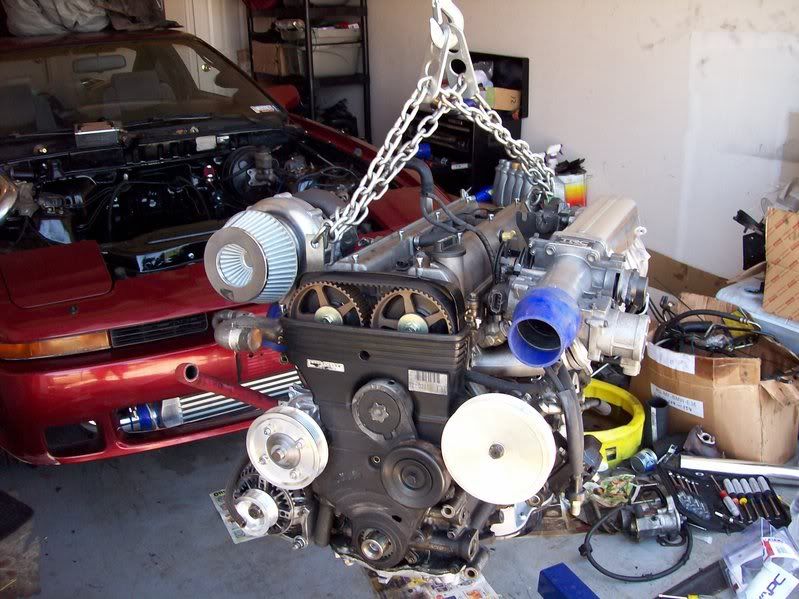

YAY more progress. I'm finally ready to put the engine in. and the guys at NAPA were kind enough to help me getting the pressure plate all setup.
