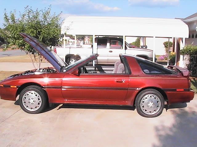

so today while i was working on getting my springs in, a group of younger kids stopped by to see what i was doing. they wanted to see the engine and as soon as i opened the hood, they're eyes opened up wide and all of them were like, man look at that. one kid asked how fast it will go, he was like 200! i said around 150. so i am glad i made their day.
i got my NGK wideband in too, still need to wire that up, and i picked up a Bosch replacement O2 for the ecu to look at
as she sits now...

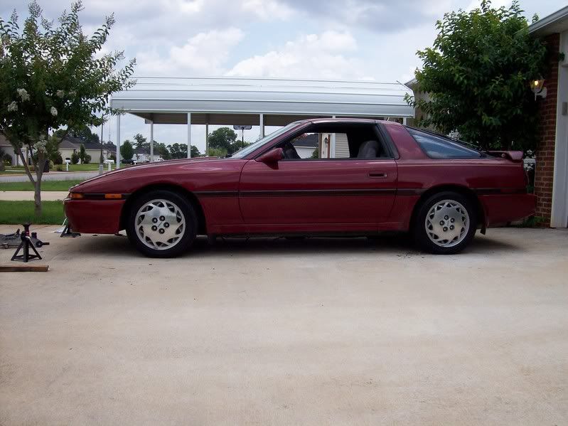

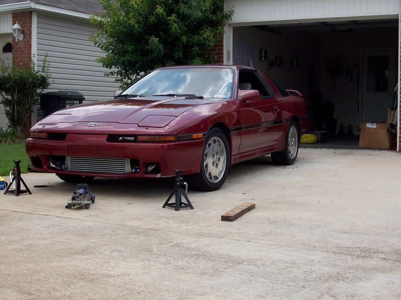

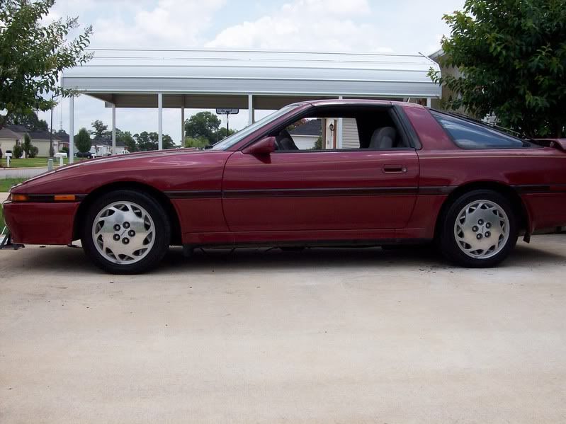

got my springs in, car looks freakin awesome, totally different. i love it
you probably can't tell, but before the front end was so freakin high, it looked like a 4X4
BEFORE
AFTER
