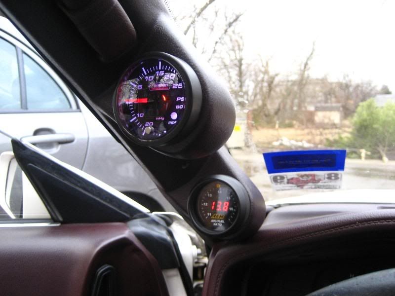

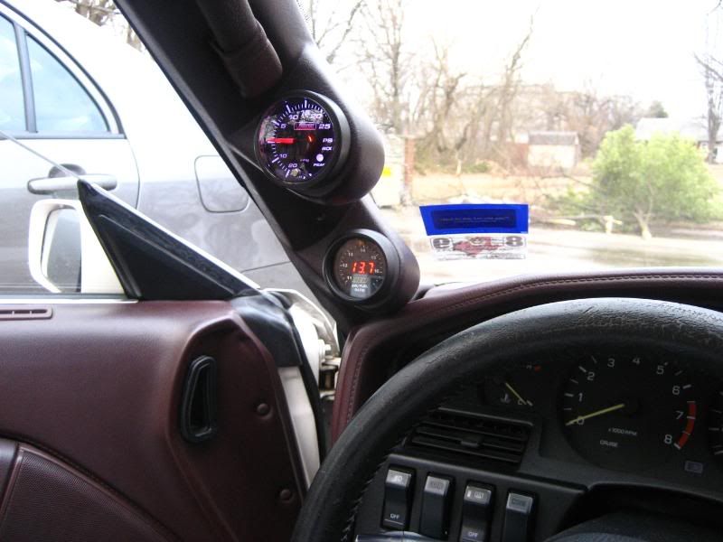

With using the Neo I've tuned for about 10 PSI max or so. I'm still messing with it because I don't go full throttle that much and I think that's my problem. I think it will be much more consistent when I go full throttle for tuning. It's strong though.
Right when I put my foot into it (about 1/2-3/4 throttle) it goes pig rich, then will lean out to about 12.5-13.5 MAX. But when I go up in boost I think it just leans out no matter how much fuel I dump in however those are not full throttle pulls...
So I'm hoping with more adjusting of the SAFC and throttle I think I can be safe around 10-12PSI ish. Max I hit on this setup was 14 but the SAFC wasn't tuned for that so the second it jumped up to about 14.3 AFR I got out of it.

I wouldn't be doing anything if you're seeing anywhere near 14.3 on the wideband. The second I see 12 I would be out of it.

14 X was only at half throttle. Full throttle it settles down to around 12.5.
I'll keep my foot out of it for the most part until I upgrade fuel.

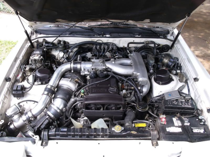

Here's a semi-current picture after I got all matching black couplers which completed the black and aluminum color scheme in my engine bay. I also bought a fan shroud which I don't have pictured... It looks so stock with the shroud on.
