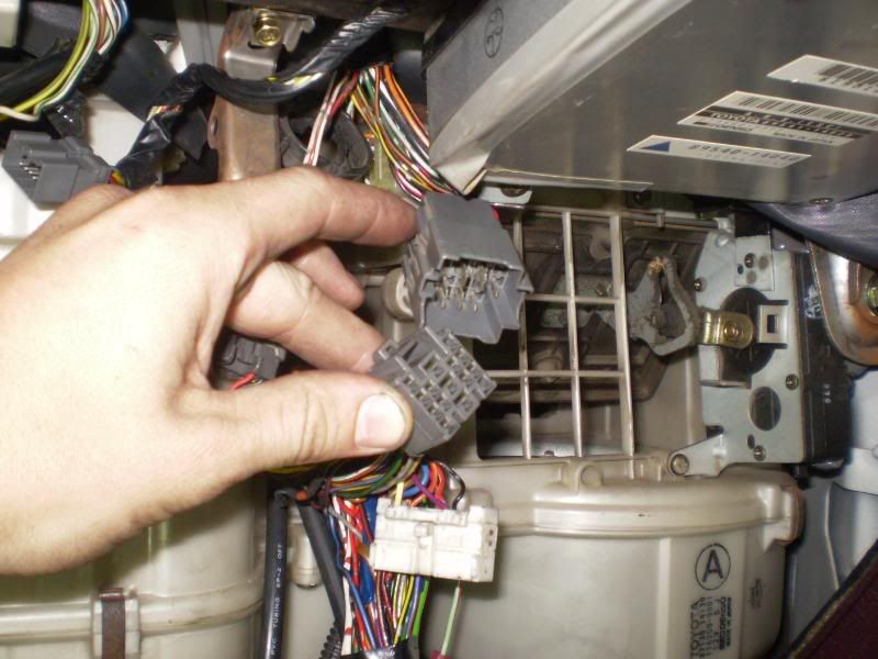

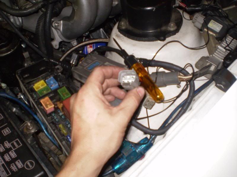

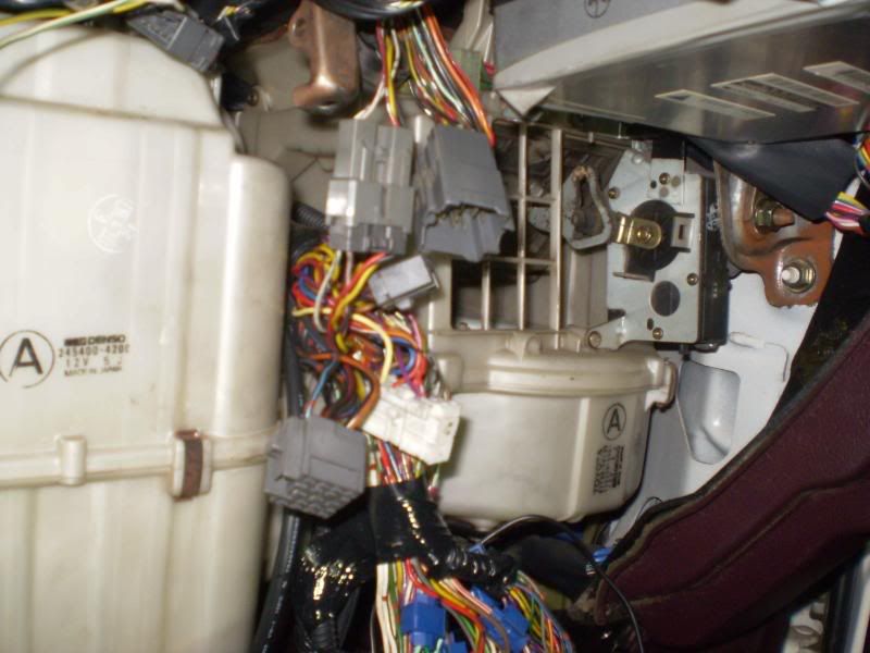

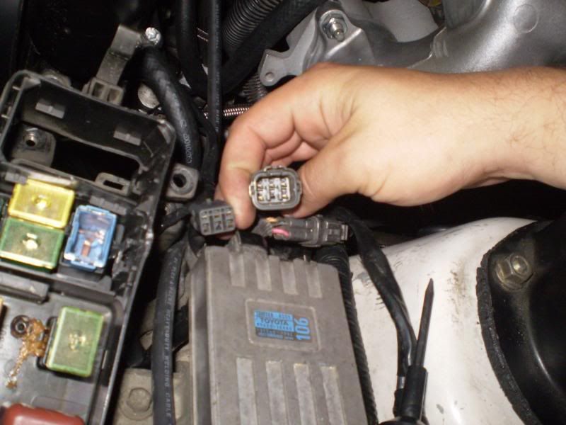

ECU doesn't have power. It might be because I was sold a 91-92 harness. That's the only thing me and Ben could come up with.
Pictures:
These are the two that do not match. Neither does the wiring. Different gauge and different color. The loose clips in there also dont have anywhere to go either.
Here is the clip I had to take off of the harness thats on the car now.
And wire in the one from my old harness. So it could fit this male end:
The O2 sensor clip was a square style as well.
Does this look like a 91-92 harness?
Could I delete the clip and hardwire them together? (that'd be a bad idea if i ever wanted to disconnect it again.) Swap dash harnesses? Or just try to find another harness and redo all the wiring work?
Please help.
