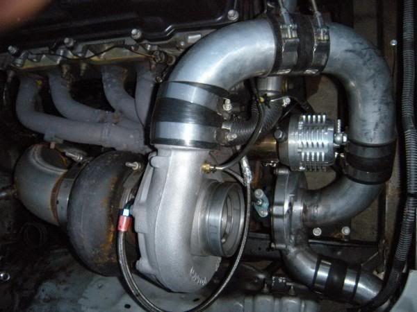

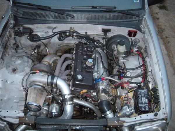

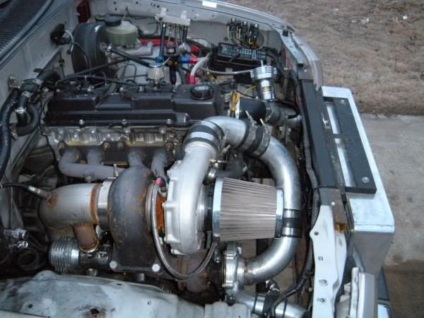

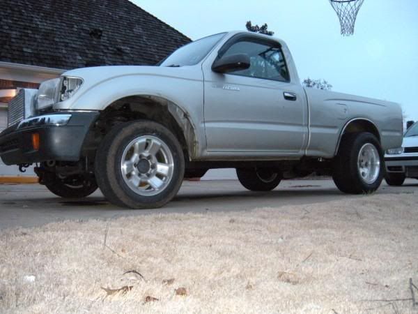

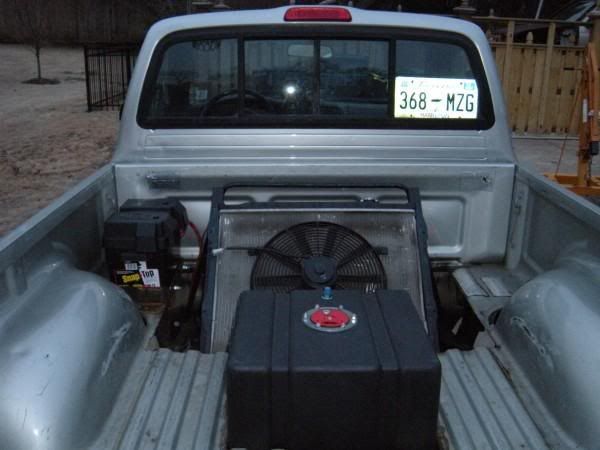

Pics as promised.

gnarkill87;1256483 said:
Pics as promised.
Wow this is one crazy set up, how's the drive on this Tacoma? must be quick as hell. :evil2:
And on the first pictures I love the set up on the 2JZ. I love when people are creative, also looks like and octopus has possession on the engine:sarcasm:
