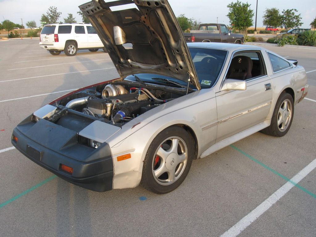

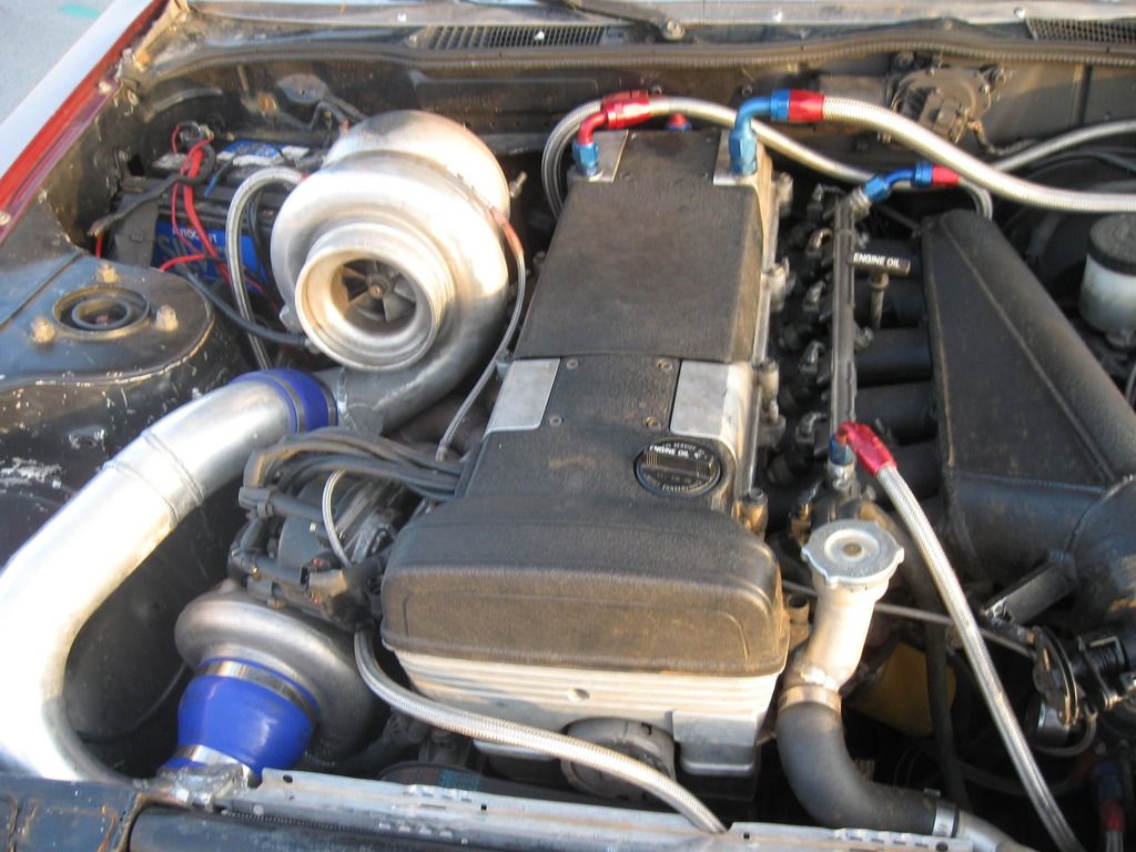

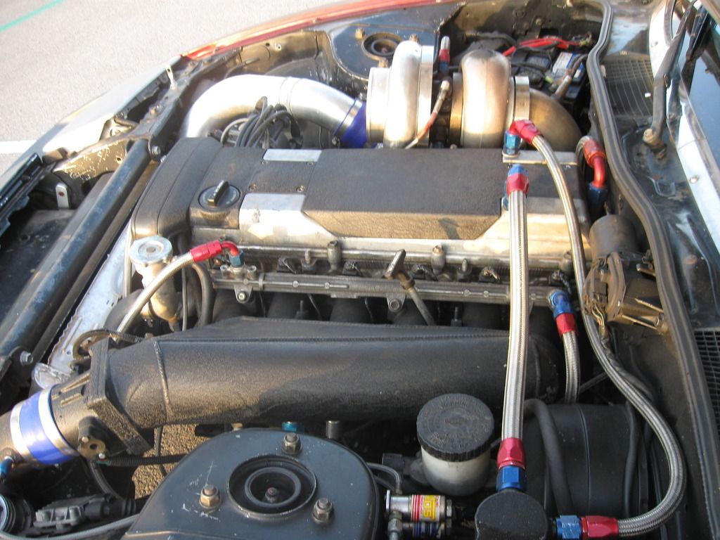

Kean and Marc at Boost Logic here in Austin built that coumpound turbo setup. It accelerates like a V8, very little lag and builds constant torque throughout the powerband. Marc is a good friend of mine, he was their in house fabricator.
This is another one that they built. This is Marc's personal toy, he built this thing out of junkyard parts and last time I saw him he was running mid 10's with slicks, without the nitrous, he was shooting for 9 second passes with it. Keep in mind, this is a junkyard 2JZ-GE. He fabricated everything after hours from everyone's scrap parts, and sure it also helps to have accessibility to Boost Logics shop. Pretty awesome, the ultimate sleeper, that shocked Vipers, Vettes, etc here on the streets!
