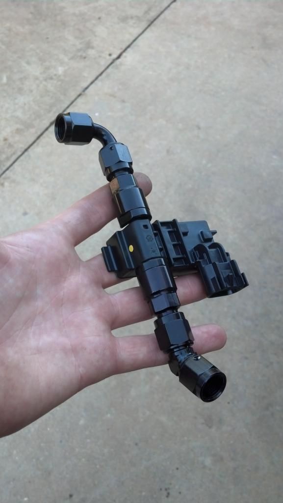

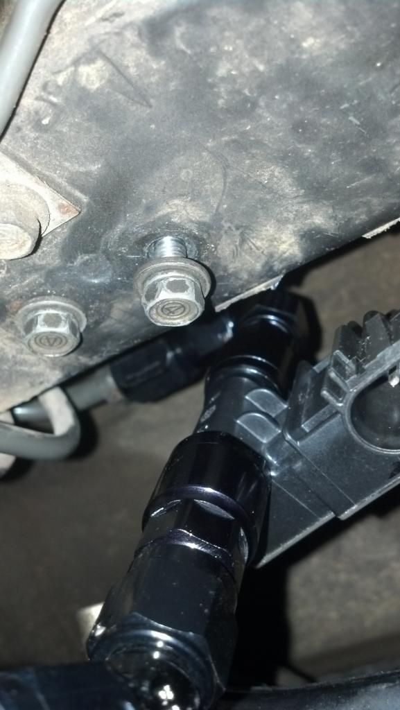

replaced factory fuel filter with flex fuel sensor.
When installing FFS uses driftmotion adapter on the flared hardline and the hardline on tank requires honda 14.5 inverted flare to -6. this inverted flare fitting will need 4-5 mm cut off. the threaded nut part is to long and does not meet the flared surfaces.

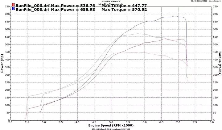

waiting on dyno now
for the tank and body side of the fittings were did you pick these up from? I want to get rid of the stock fuel filter or just punch it out.
