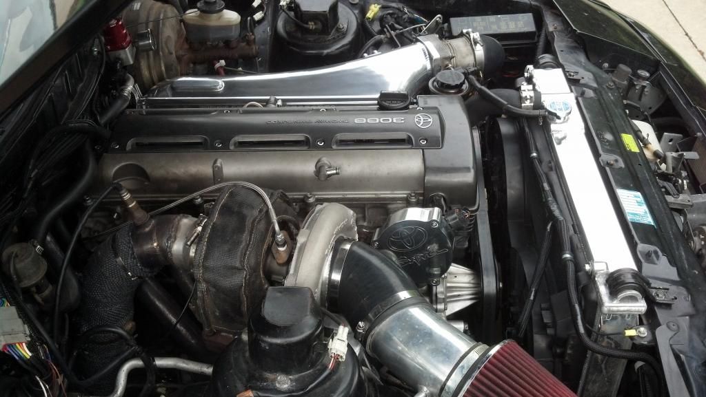

So summit got them some monies and i got some bad ass fuel lines. I have electric fans now too :D
-8 PTFE 20',-6 ptfe 6ft,flex fuel sensor,a bunch of ptfe fittings, and a magnafuel -8 24 micron SS element, some relays
junkyard find. Ford contour fan installed best $50 spent :D
Removed the tacky looking studs for SS bolts
made a harness for the fans. each one is on its own relay
AEM EMS v2 controls each fan individually
braided harness is so awesome!

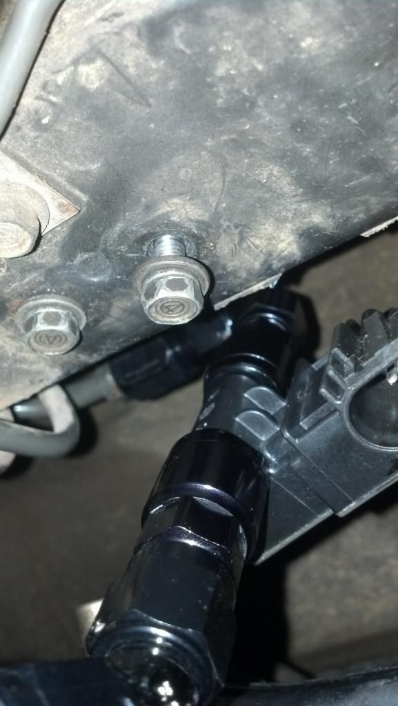

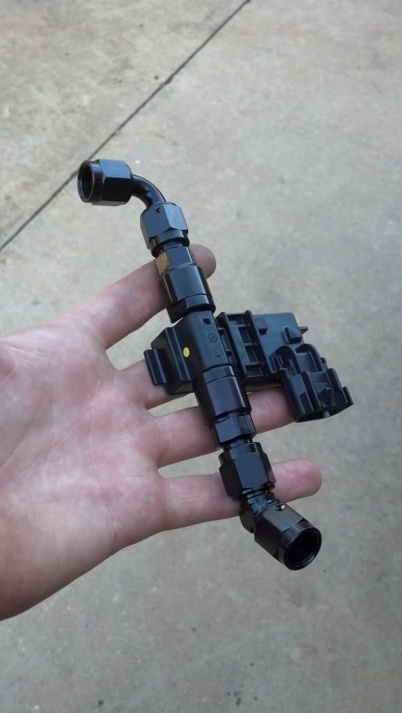

replaced factory fuel filter with flex fuel sensor.
When installing FFS uses driftmotion adapter on the flared hardline and the hardline on tank requires honda 14.5 inverted flare to -6. this inverted flare fitting will need 4-5 mm cut off. the threaded nut part is to long and does not meet the flared surfaces.

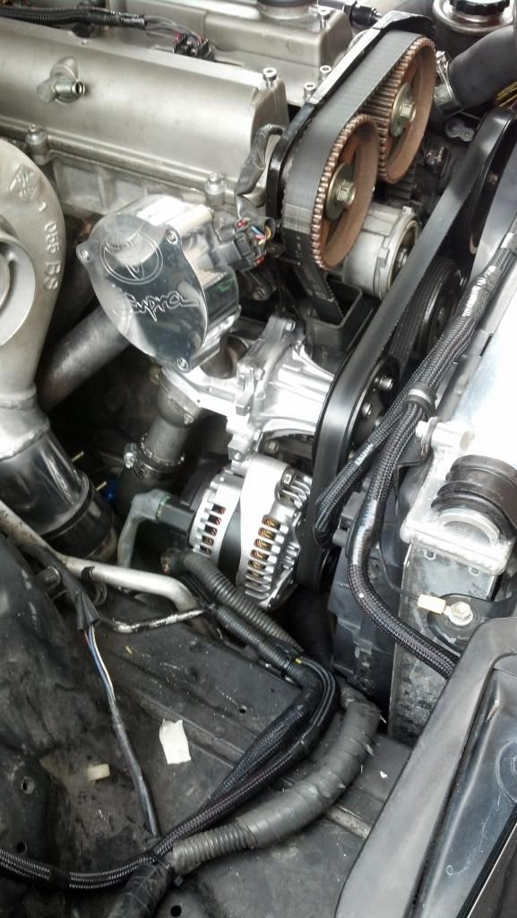

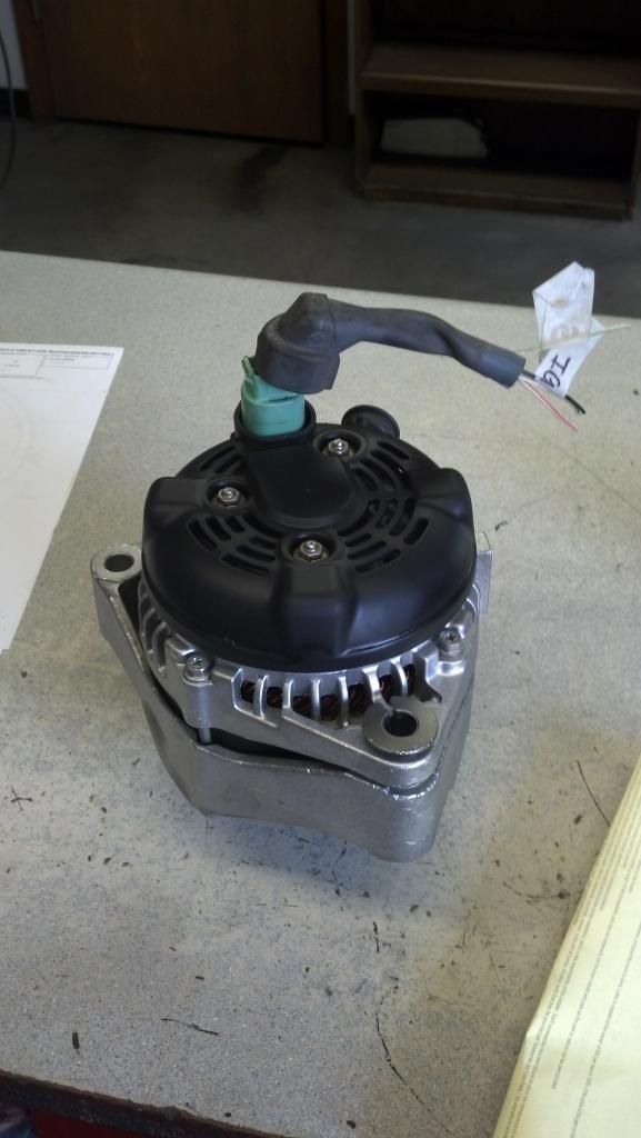

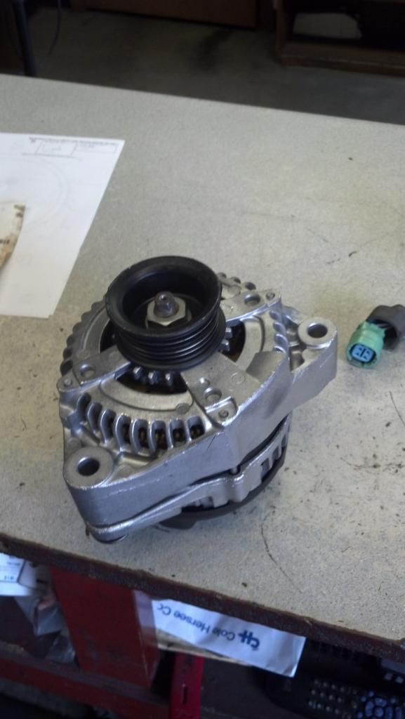

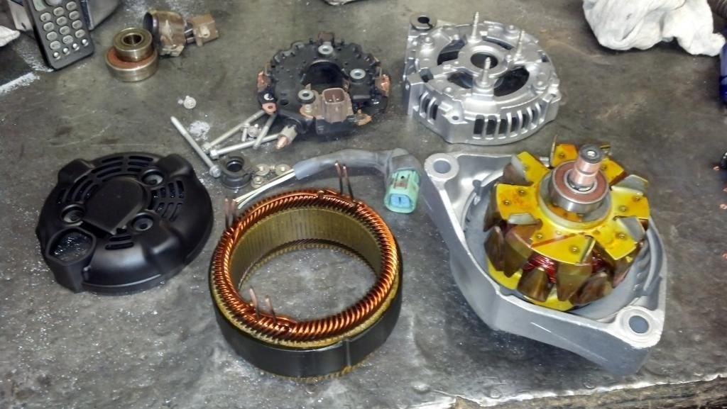

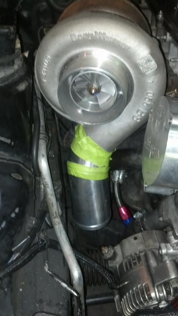

well i had a knocking sound that has gotten worse and i was like OMERGARDE ROD KNOCK jk i thought i didnt tighten the balancer down enough so i tried tightening the 240ftlb bolt and then i still had the sound so i tried the stethascope screwdriver trick and i had a "AH HA" moment. its the alternator so ill just get a junkyard tundra or sequoia 130 or 150 amp alt. i got one for $65 plus core of $48 then rebuilt it for $30 it needed brushes and the bearings where ok but i replaced them too. cut off the middle ear and trimed 4-5mm off the back of the thick ear so it lines up the pully. rewired the 4 pin plug and whala! 14.5vdc!
i had a 1992 sc300 round plug 100amp alternator
and its in and charging!
guess what....the horrendis knock sound is still there :( dont buy a proto reman water pump...... i bought the aisin toyota water pump and changed it. knock is gone. the proto water pump was less than a year old. but i do have brighter lights at idle with the contour fans running,blower fan on, head lights on :)
