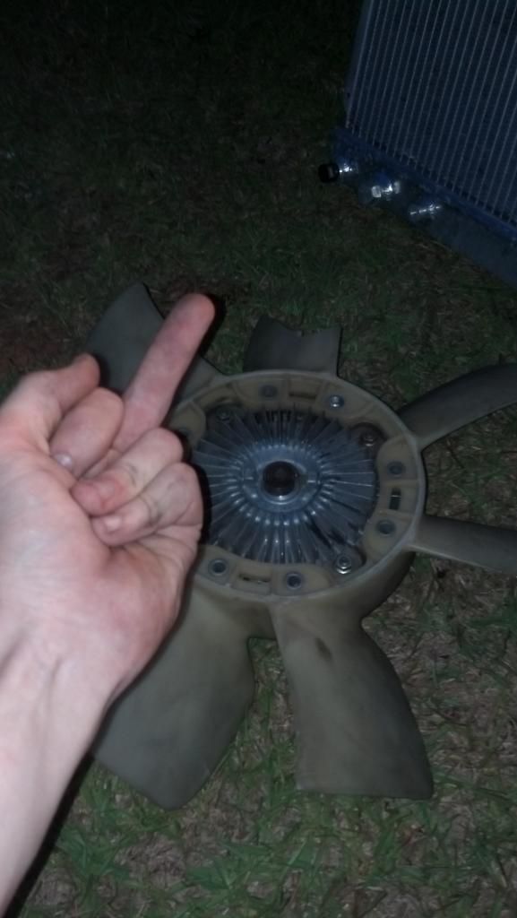

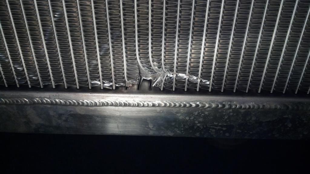

My koyo radiator was murdered by a mechanical fan.....motor got excessivily hot....had signs of BHG on a 2j and decided to tear into it before the milkshake brings all da boys to da yard. bad joke
anyhow the motor was fine. block is still true, head is true, head gasket looks fine. not sure where the air bubbles came from in my coolant system. ill look again for cracks.
radiator is now patched up. 4 tubes were pinched off and tested to 16psi $75

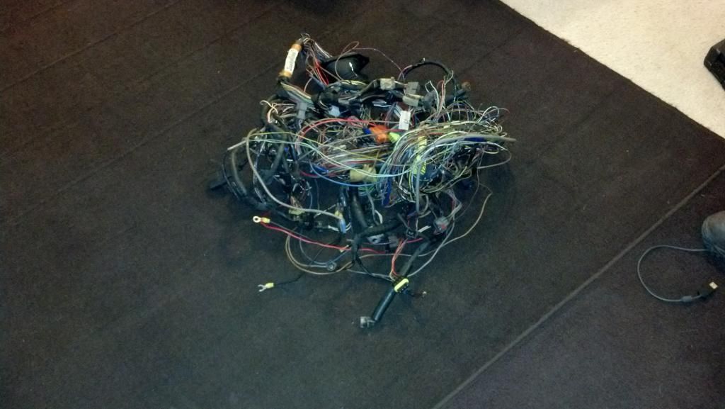

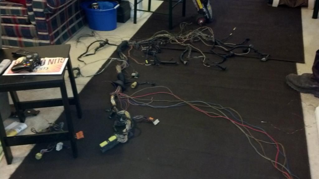

Spent more that 10 hours total on my harness i took apart to remove excess wires. in the process i became lost,scared, peed a little and cryed in the corner. i think i may have it figured out besides the C1 plug by fuse box and the ALTernator plug. the 2jzge alt wires from Regulator go into the harness, the 7m come from the fender to the alt. also signals like A/c clutch relay come from the harness then back from the relay on the fender back onto the engine harness and to pump. i have 12v memory for ecu and 12v signal to efi relay, and power from efi relay to ecu and also a haz horn wire which i havent figured out.

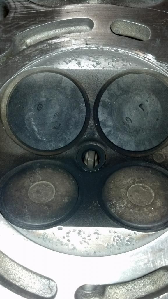

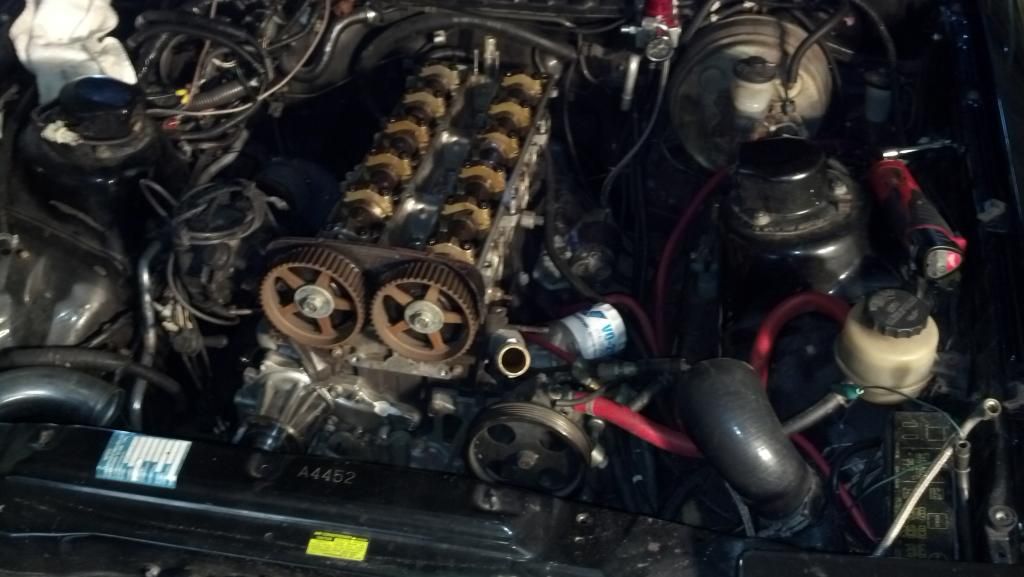

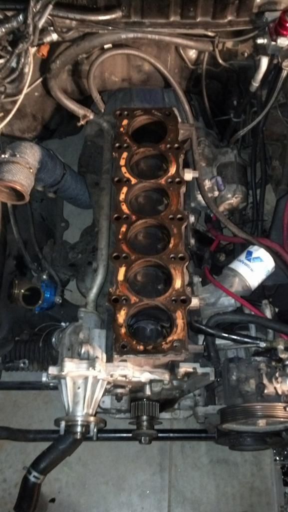

she was super hott and i had air pushing the coolant out even after getting a stock radiator and tried driving. so i assume HG or worse and do and autopsy.
pull cams to take off head
bores looked good. no serious wear. Arp washers mushroomed the head. FYI use Toyota washers!!!!
my spare head cleaned with scotch bright by hand
number 4 cyl :( i wont be using this head

then i awoke satan and pulled the sc300 harness from the supra to remove the stuff not being used. like emissions and diagonstic port
satans true form. even my camera couldnt focus on what was going on

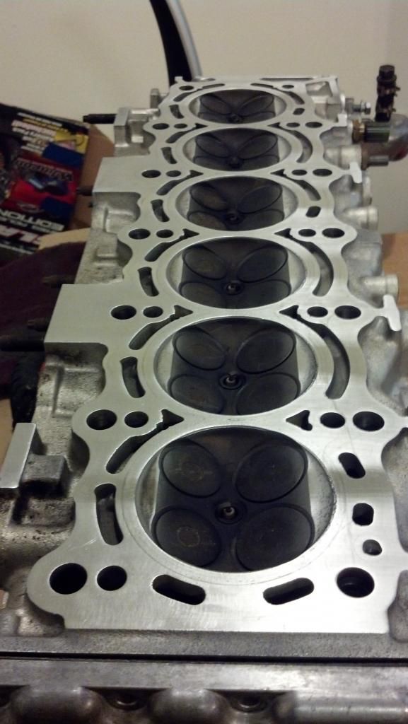

ordered a jdm head b/c no egr and lower mileage. had valve stems replaced and surfaced. the head arrived and the box was attacked by a bear. the studs were bent and the corner of the deck was mashed. ugh.... the head is on now and im finishing up installing accessories on the motor.

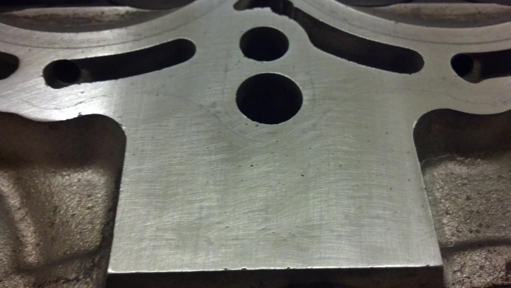

Thoughts of selling this car are on my mind. im not totally confident in the engine block surface. looked like pitting or something near cyl 6 by the water jacket. i fear another BHG b/c i didnt machine the block but i didnt have a choice. i tried razor blades to clean the surface of the HG material and then scotch brite. and a little 220 grit on the it. ill prob reget it. but its done now. ass. lube is on the cams and buckets. ready to fire when its full ass. then change oil.
i hope it doesnt blow a head gasket
