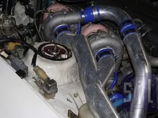

Racerxj220 has the k26 kit using Sard manifolds.
Van Diesel has the Blitz kit(like mine) on his car...
AFAIK there's only one other kit in the US. 51 Cards on SF had one way back in the day. Probably still does, I just happened to run across a pic of his setup dated back in like 04 or something.
I guess Moe is going to be making his own kit with alot more custom parts.

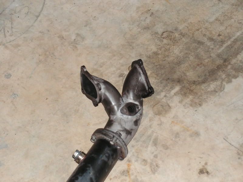

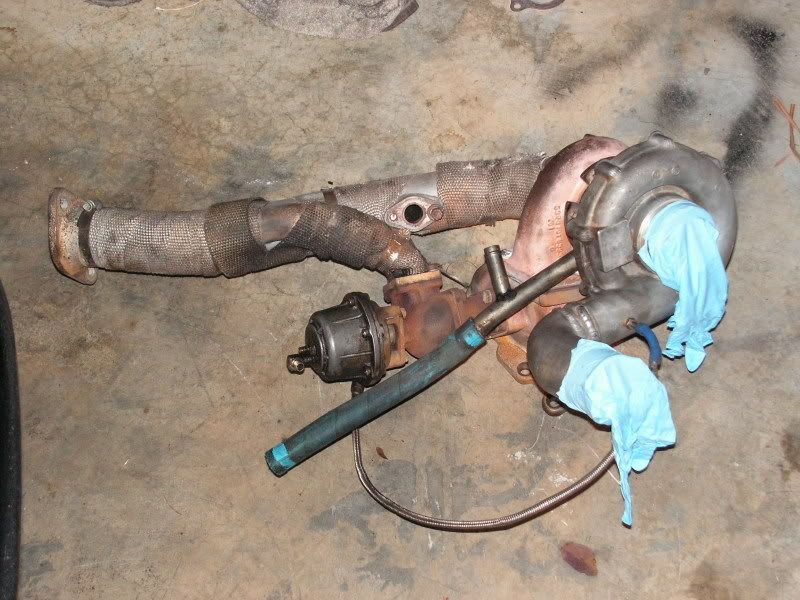

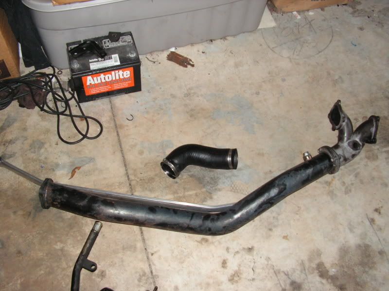

No more stock twins! Lucky for me they came off without much of a fight which is a relief. The nuts holding the stock manifolds to the head also didn't give me much trouble which was an even bigger relief. I was afraid they would just strip and I'd have to call it an early night.

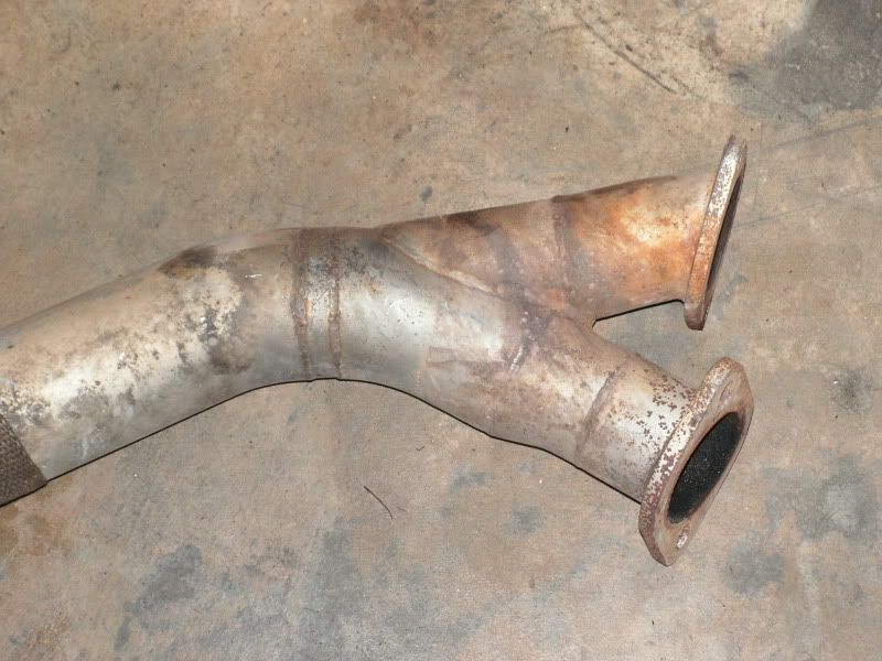

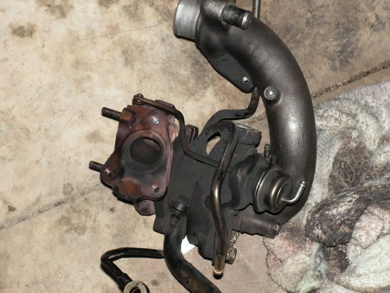

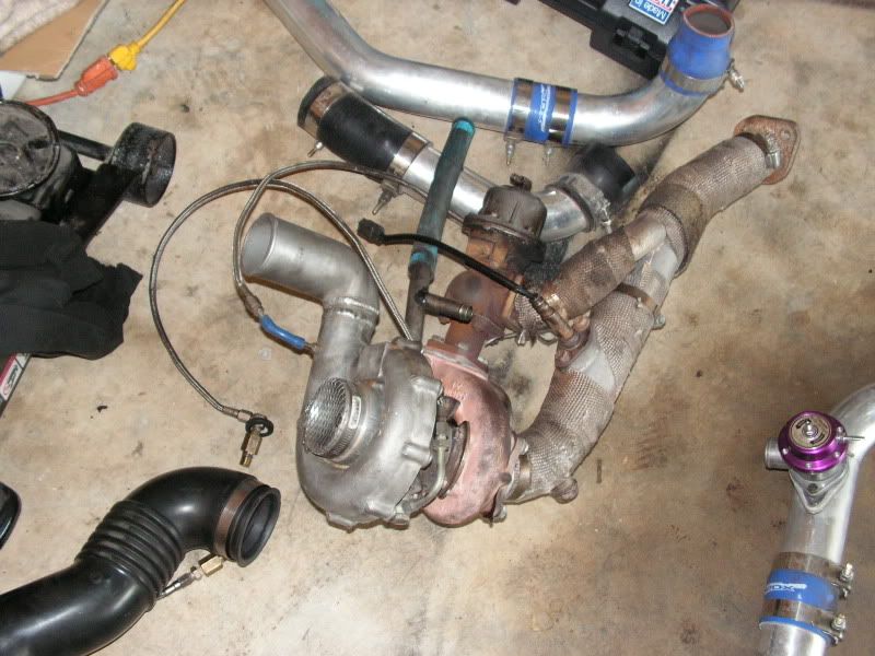

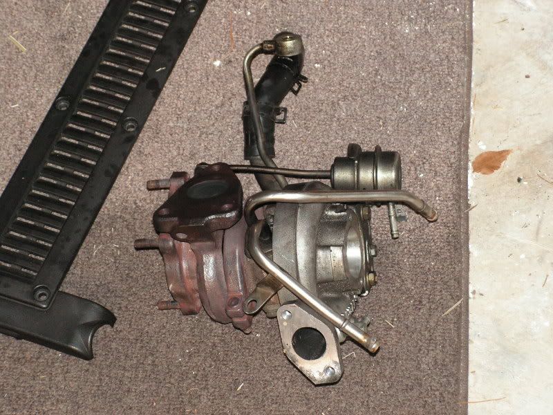

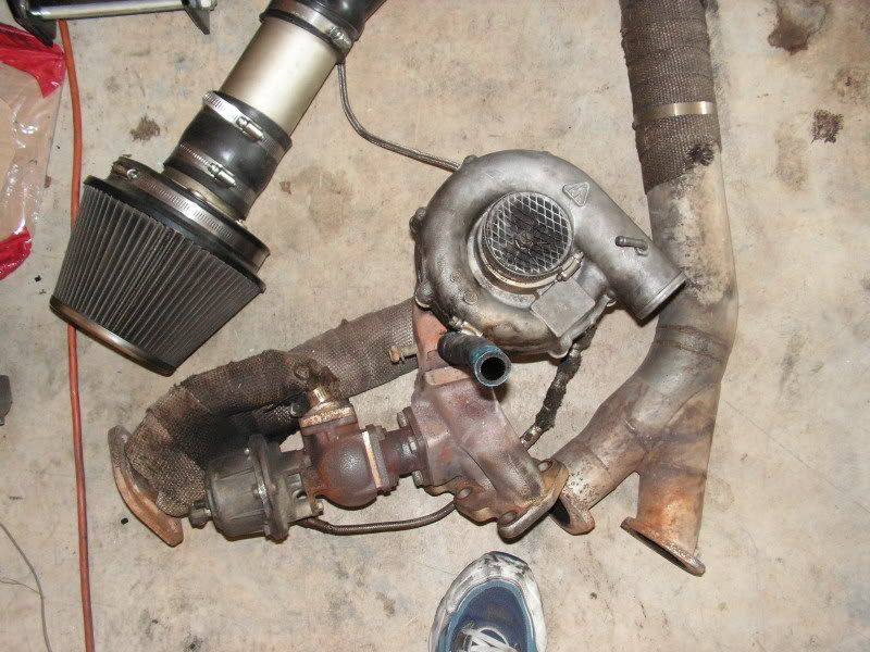

Here's a few pics of the K26 twins and the stock twins in comparison, as well as they're respective downpipe/y-pipe
And here where I left off last night. I mounted the rear turbo up. I decided to call it a night there because I didn't have any caps at the time to cap off the water lines. And I was tired...
