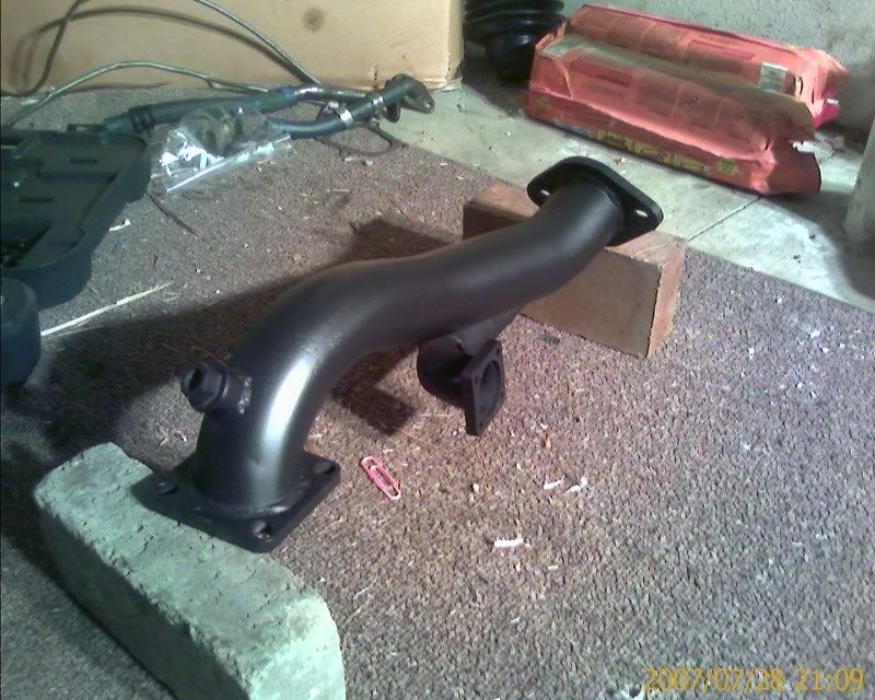

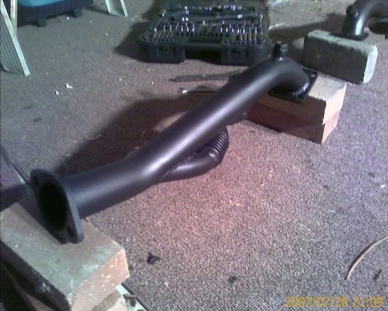

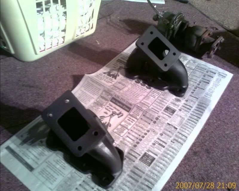

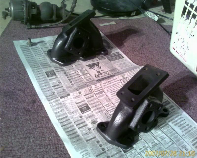

Today:
Time to start making this kit look better. I dressed up the manifolds, downpipes, and y/mid-pipe with some black high temp paint. I knocked the dirt grease off with some Simple Green first. Then I used some 80 and 180 grit sandpaper, wiped the parts clean, then shot them with a couple coats of the high temp paint.
Pics are from a friend's smart phone, so the quality is ok. My parents are out of town on vacation with the digicam so this is all I can do.

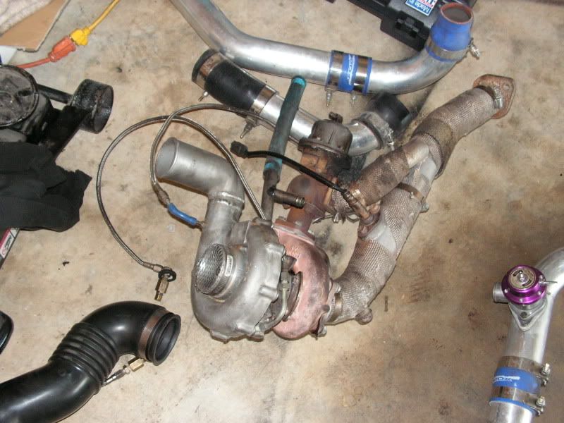

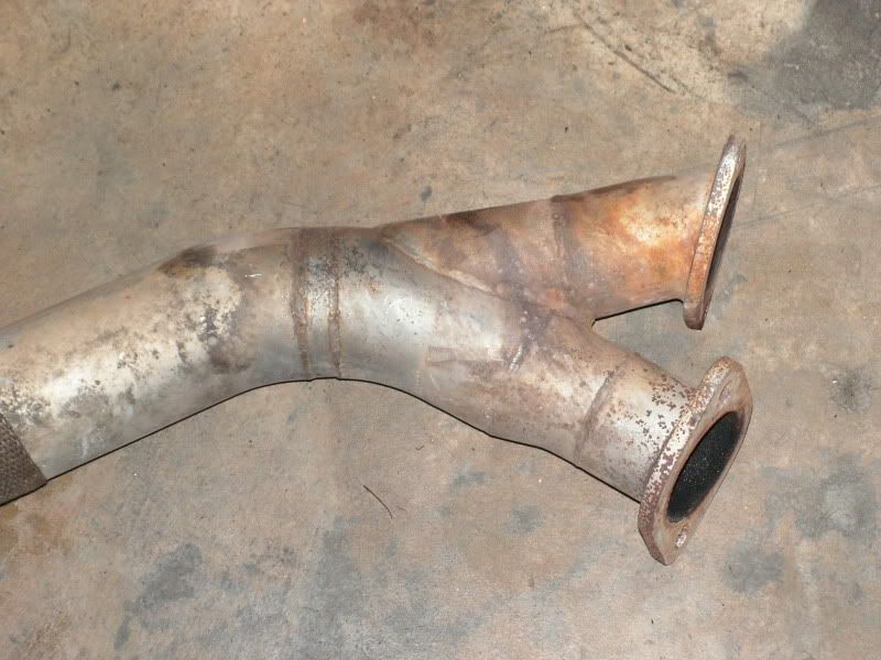

And to compare, this is what everything looked like before with the nasty old heatwrap on.
Thoughts? :)
I think this is going to look great.
AF1JZ
Almost civilian status...
Jun 26, 2006
3,109
Fredericksburg, VA
Looks pretty sweet. You should get the exhaust housings and wastegate ceramic coated and the turbine housings polished or just clean them up a bit.
BTW, what temp paint did you use. Do you think it will withstand the heat on the manifolds?

Thanks A-fon. 1200 degree is the highest I could find and what I used. We'll see if it holds up... If not, it can't look any worse than it did before.
I'm gonna leave the wastegates alone. You can barely even see them with the whole setup in the car. And I didn't feel like taking them apart to paint with the other parts.
I'd like to have the turbine housings ceramic coated. I'll see how I feel when I get the turbos back. Impatience will probably get the better of me and I'll just put them back on with just some elbow grease put into cleaning them up better. Not gonna polish the compressor housings though. I am anti-bling. :)
Next on the list is to have the IC pipes powdercoated.
And the last thing I'll do is get some black couplers once everything's back together.
