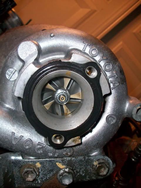

They have no markings. They have a 3 bolt flange. Ive been searching for hours and cant find any info as to which i have for sure. What are ways to tell for sure?

I was told they were usdm, but then i also read the flange for usdm is 4 bolt vs the 3 bolt jdm? I have 3 bolt, i guess ill take my heatshirld off when i get home for a better view.
http://www.turboninjas.com/pics/mk4compare.gif
According to this they are te same? The guy i bought the engine from said they had steel vs ceramic? Could be he just swapped the wheels out as well.

what is stamped on the compressor housing. Wheels cant be switched between the two types cause they are completely different turbos with different shaft sizes...
jdm are ct20
usdm are ct12
like this...this was my rear one might be easerier to read the rear turbo
