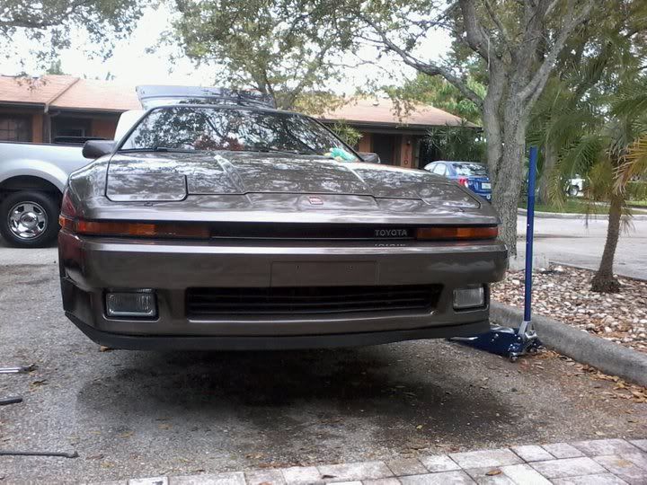

hmm... was wondering if anyone could photo shop my car with mkiv tt rims with them as gunmetal, black, and bronze. Plz and ty :]

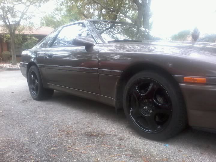

taken with crappy phone.. Just need some wheel spacers and ill be set :D
