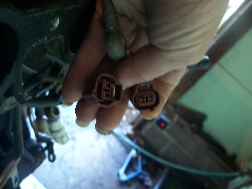

Here's those brown plugs I was talking about, any ideas people?

sparkplug619;1323306 said:
the 1 on the right looks like the 1 i was talking about as for the left???

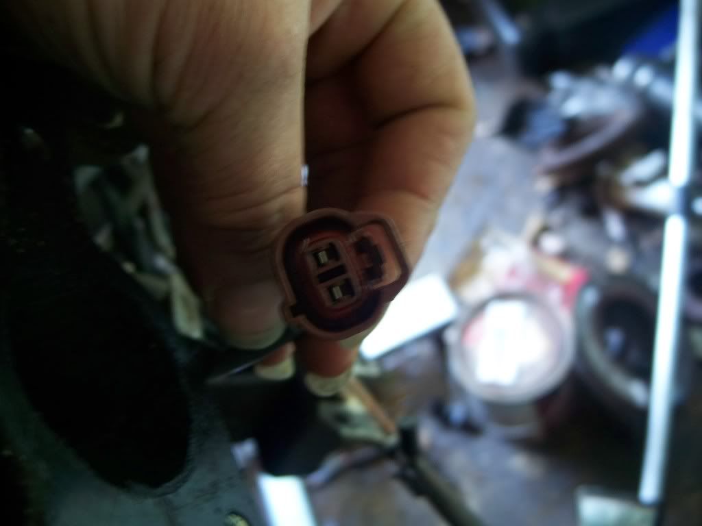

Both plugs are identical in appearance. wires on the closest are black with red stripe and red with black strip. wires on one towards back of engine is black with red strip and green with black stripe.

Well the funny thing is, I have 1 VSV on the side of the engine, but it uses a bluish/green connector (which the supra harness also has). The Cressida's harness does NOT have those 2 brown plugs, but if it's just emissons stuff, I don't really need them right?
All I have left to do, is distributor (which can be done with the engine in), fuel line (which I'm paying someone else to do), put tranny back on engine, take the upper cat off the exhaust, and drop it in. Then I'll sort out the dash harnesses after the engine is in.

Yes, new engine is N/A. Guess I don't have the VSV's, hell I dunno wtf half the crap on this engine is as far as emissions is concerned. I'll wheel the stand out in the daylight and snap some pictures a little later when I have some free time.

alloyguitar;1324354 said:
As previously mentioned, they're for the vsv's, and they're not needed. I went as far as to seperate the wires from my harness and completely remove them.
So is anything else needed other than just not plugging them in? I'm not really looking to do anything with this engine, just get it in and running.
Not really. I didn't see the point in having them, so I just ran my car (which is a turbo car, if that matters) with them unplugged for a while to see, then when we installed my FFIM, we just went ahead and got rid of them.
I'm sure someone on here will tell you that there's a reason why they're there and they should be kept on and so on and so forth, but, in my particular experience they were not needed and I did away with them.
