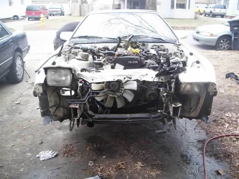

Also we were told "the engine started knocking and then spilled all of the oil". Due to this we are ripping out the engine and transmission, going to go through the engine and see how stuff is stacking up and whatnot. She says she doesn't want the turbo, so I will be converting the car to an N/A using my Cressida's 7M-GE, I also have access to a N/A auto MKIII in a local junkyard to get the proper ECU and harness for the conversion, along with the MKIII y-pipe setup.

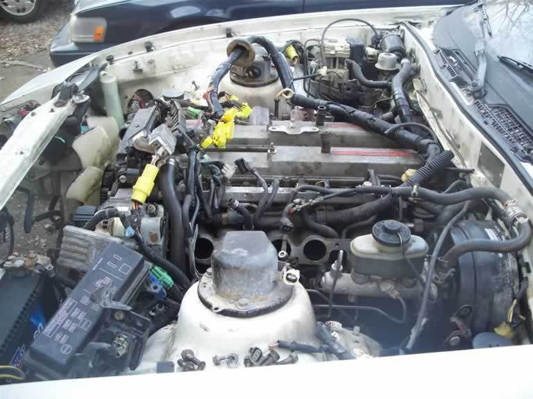

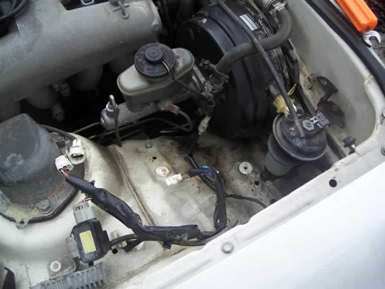

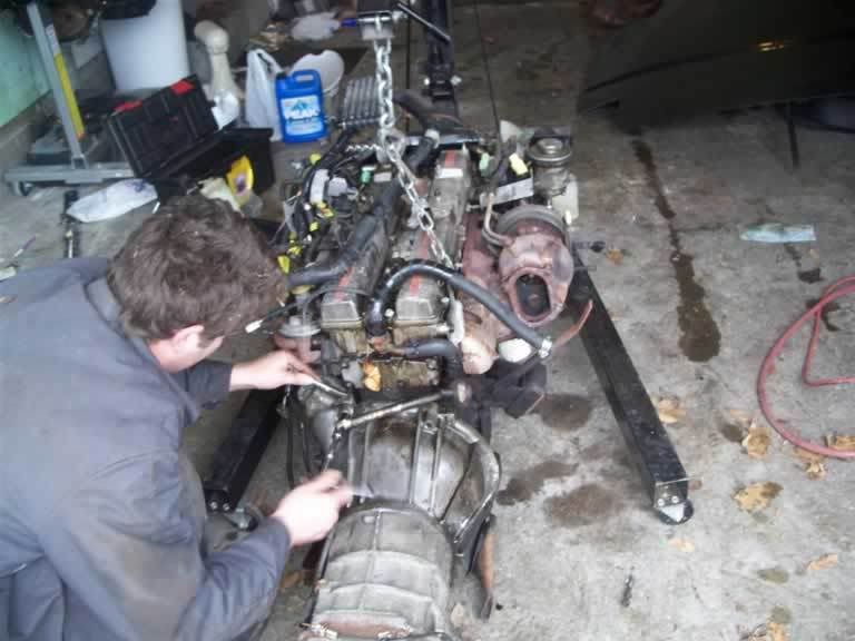

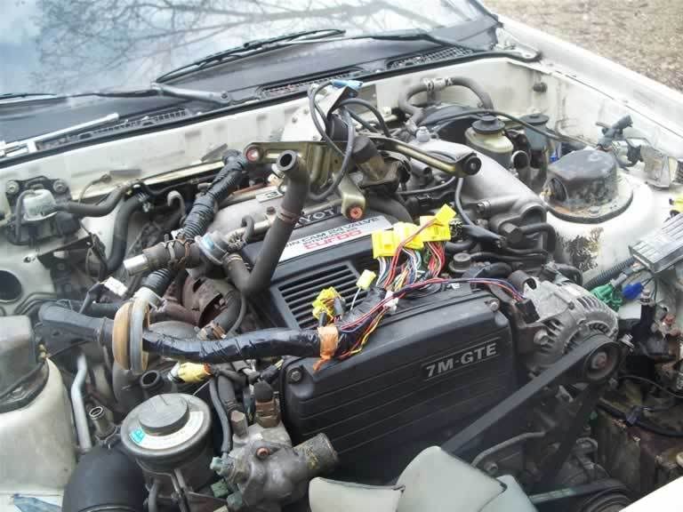

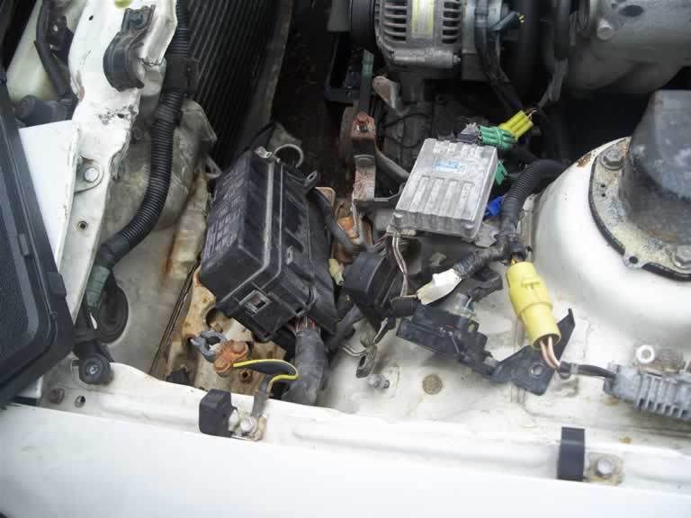

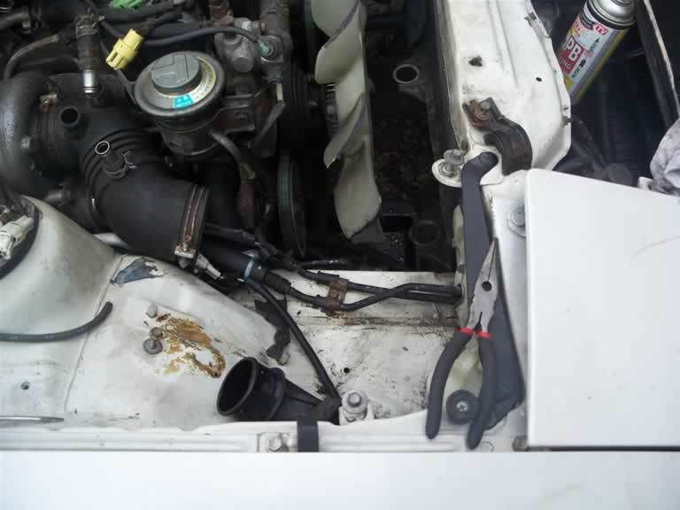

Well after getting up and taking a bunch of pictures (while I'm walking around the car in my pajamas), she decides that it's time to get the "dead" engine out of there. So armed with a decent amount of tools, and 1/2 the day, we start tearing apart the car.

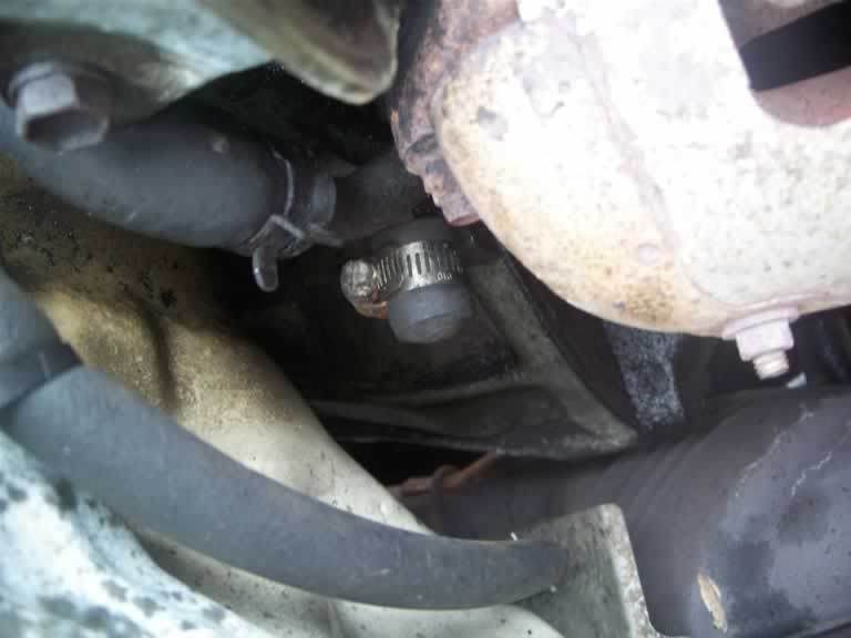

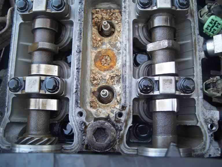

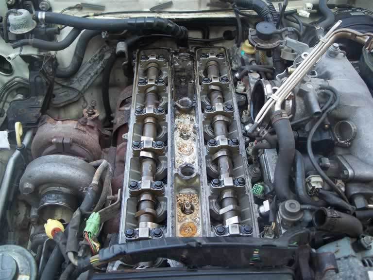

At the end of the day, we were left with a couple of weird questions. First of all WTF is that capped off coolant line below the exhaust manifold? Why is the OIL in the intake system? And WTF is that cottage cheese looking crap in the plug valley? BUT the cams and such look to be in pretty good shape, will be pulling the head after we get the engine out to check out the head for damage, then flipping the engine and checking out the bearings for scoring. I don't know about the "spilling all the oil out" that the seller told me, as the engine was less than 1/2 quart low on oil, and we haven't noticed any oil leaks under the car. Will know more when the engine is out and we can get a better look around the engine.

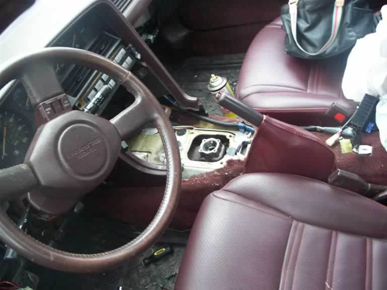

When weather lets up some, we'll pull the supra back out and get back to work on it, hopefully I can get the 2 stripped bolts out of the tranny mount and get the rest of the engine out of the car, then start tearing out the interior to better guage where rust is.

The capped off coolant line is on every USDM Supra. It's used as a heater core hose on RHD models. The cottage cheese looking crap is probably corrosion or leaves that have seen better days. I can't really tell from the pics.
The cams look fantastic, but the lobes usually do. It's the journals that you've gotta watch out for. ;) When you pull the cam caps, you'll see if they're truly in great shape.
The oil in the intake is probably from the PCV system. You might want to really look into that. Check that turbo, too. Looks like a pretty decent score!

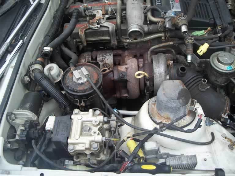

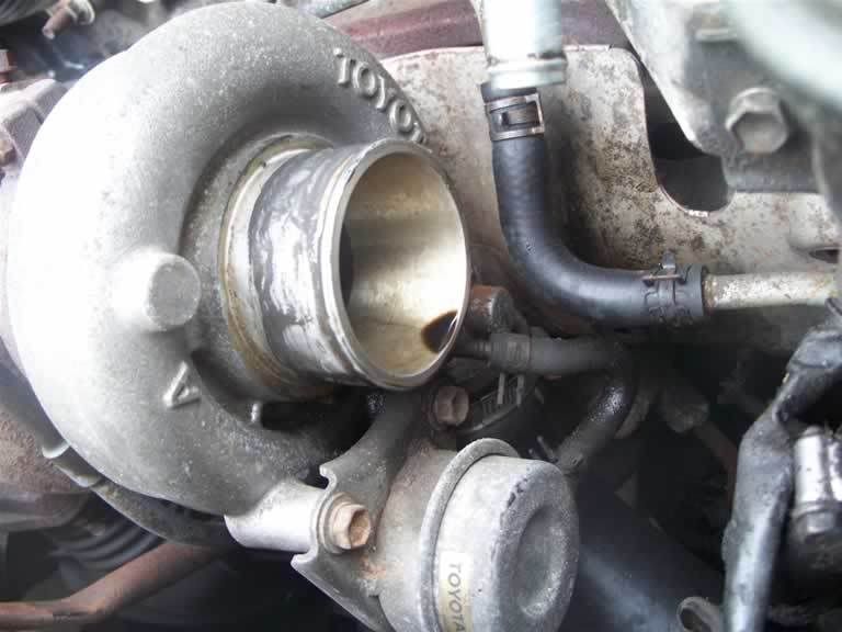

Can you get a shot of the wheel in that turbo? It almost looks like it's milled out or something...
The "cottage cheese" stuff is probably decomposing acorns and chipmonk piss... I'm pretty familiar with the rodents hanging out in that valley and snacking away!:cry:
-crisp
Good eye. It does look like the housing has been bored out. :)

Providing weather is decent tomorrow afternoon, I'll roll the car back out and get some more pictures. We found with all the rain we're having that the passenger window and targa are both letting water into the cabin, so we dropped it off the stands and quickly moved around stuff in the garage and crammed it in there. I will get a picture of the impeller for the turbo, also pull the plugs and get a picture of those and try to get the damned engine + tranny out so I can inspect stuff.

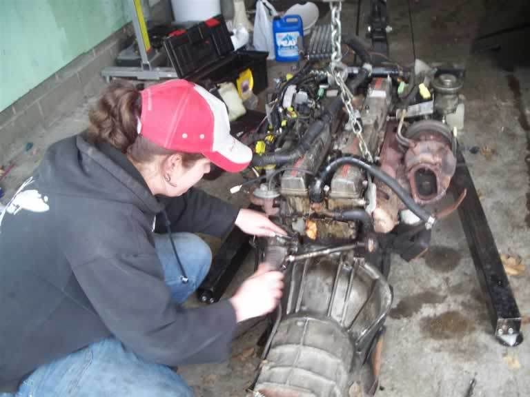

I got told last night, that I am not allowed to work on the car while she's at work, and that I am manning the camera next to get some pictures of HER working on the car, instead of me doing 90% of the work. Just checked the weather, and it looks like it's going to rain again tomorrow, so more work will probably be delayed on her car, as my garage is getting very very cramped with parts for 3 vehicles + 1 car in the 1 car garage.

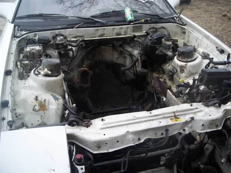

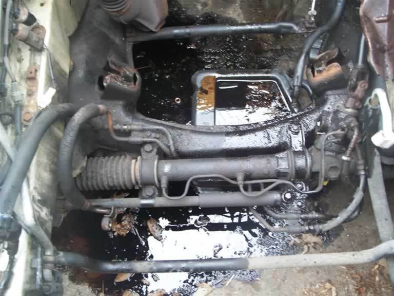

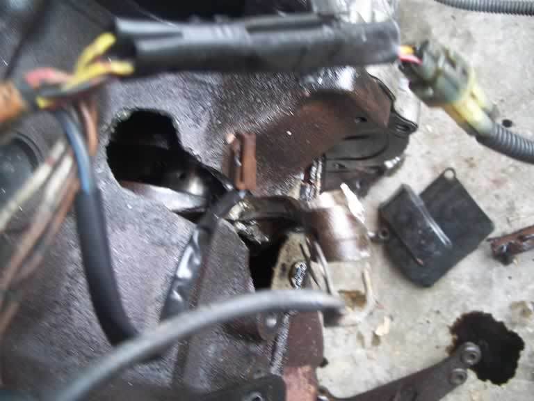

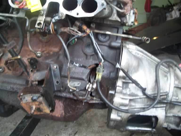

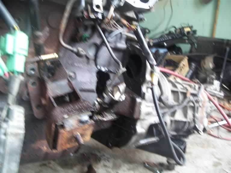

ENGINE IS OUT! And the block is dead, big old hole in the side at cylinder 6, rod about 90% out, I'm sure if I tried to I could pull it out the side of the engine. Looks like I'll have be having a "For Sale" thread here soon, selling off some of the parts from the turbo engine, but I think I'll use some of the GTE electronics on my 2jzge-t project. I'll get some pictures of "Day 2" up here in a little while after dinner and a little relaxing.
