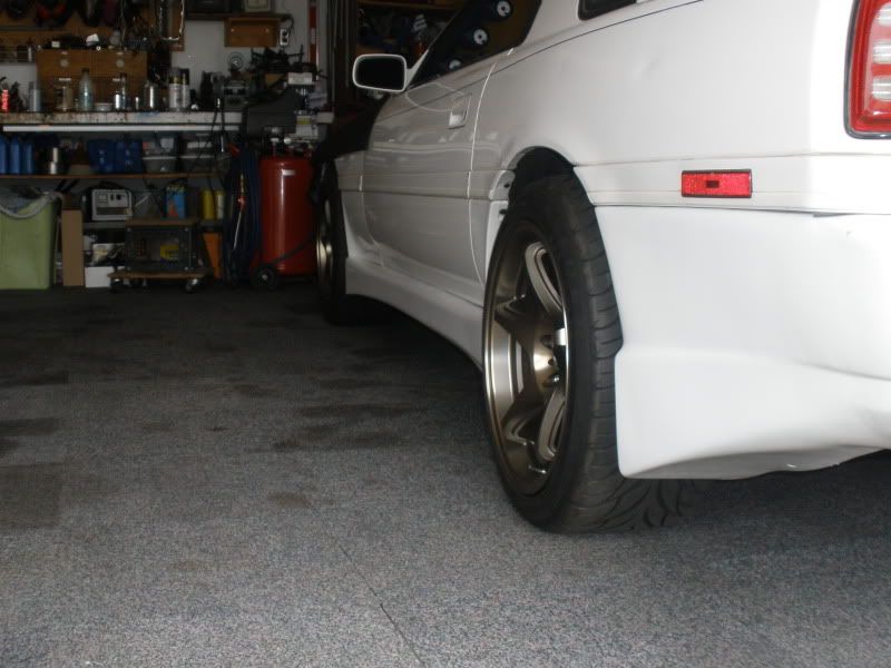

if you run a 9+ 15 up front you absolutely will have to roll the fenders and run camber. im running those very same specs with a 245/40 (in 18s which is irrelevant) and its barely do-able...take a peek
you'll have no chance with a 255.
a 10+25 on the rear will need a roll with a 275/35 also, im running 10 +22 (275/35) and here's how it sits
