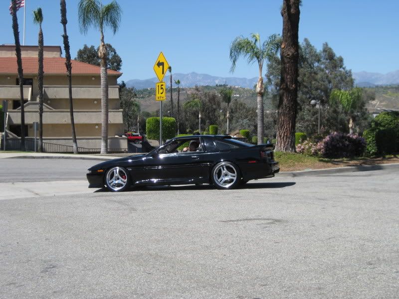

projectsupra;1463689 said:
Almost everyone has made three spokes, WORK, VOLK, Advan, etc. Just depends what style, size, and weight you want.
These racing harts made by work are for sale
