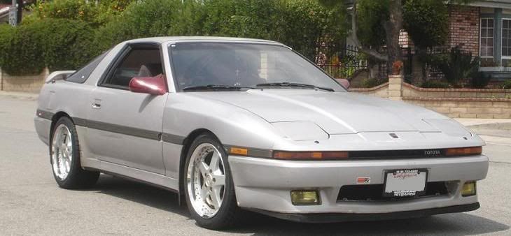

Hey BorHor, i want it to look flushed, what size spacers do i need F/R? and tires.
im on GR-2's n Eibach. thanks alot. :)
