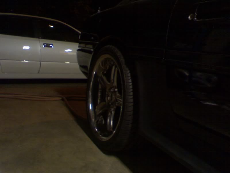

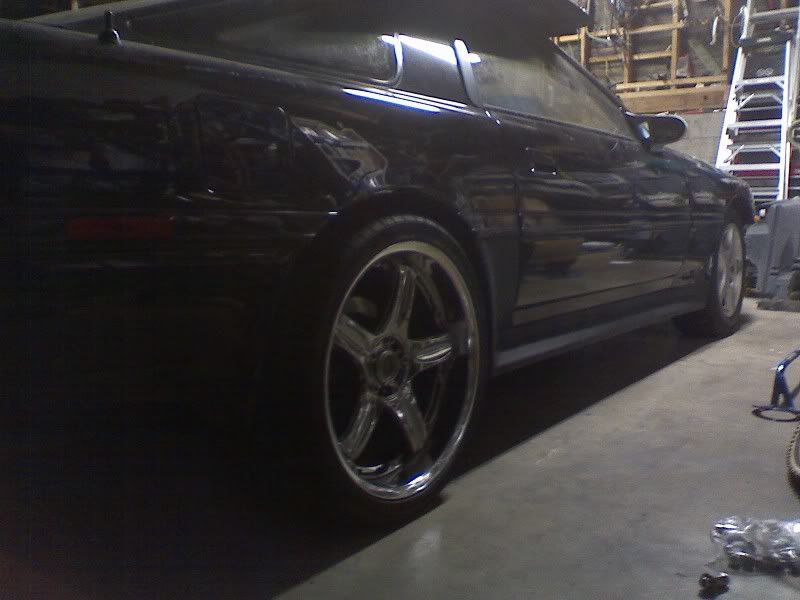

Test fitted my GS rims.
Volk Racing GT-C - Special edition RMC finish (black chrome)
19x9.5+24, high type, concave center
275/30/19
The fender has to be pulled about 1/2 inch and the tire may have to be 255/35, 265 max, so that it tucks in.
