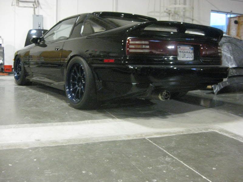

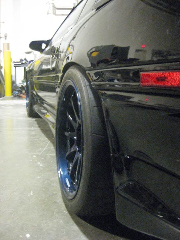

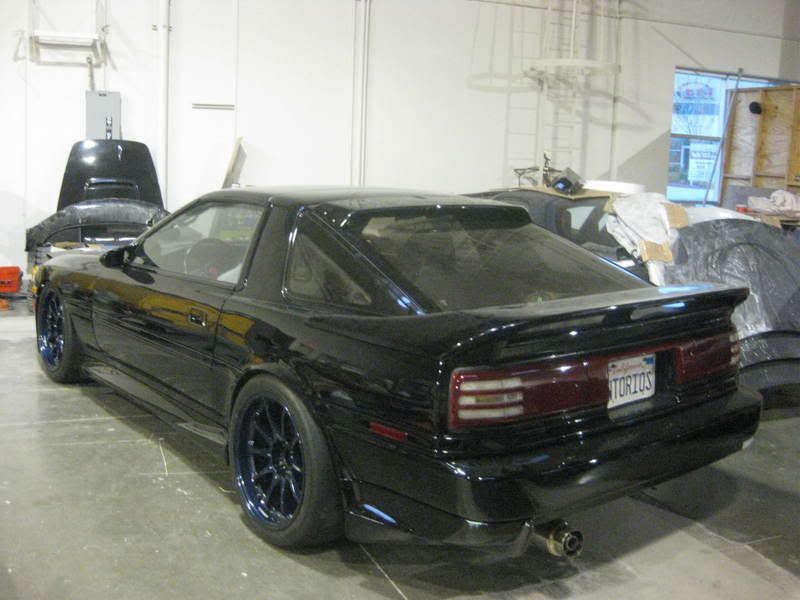

gsxr141
Oct 24, 2010
1,158
10
rochester
this. most wheels will be in the +10 to +30 range. as rodel said, you'd need to have some made to order to get that size and offset...... and that's gonna cost you. lol
i planned on 18x11 + 40ish, but i couldn't find ANYTHING. i ended up with 18x10 +25 all around, with 265-35's. i could probably do a 285-30 out back the way it sits.
