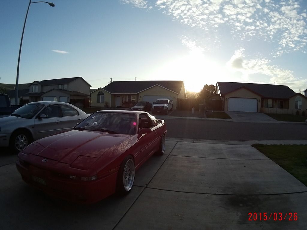

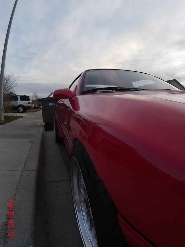

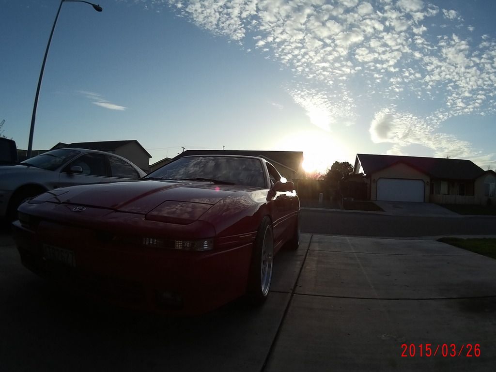

i think youd like this setup. does require rolling front and rear flat along with pulling the front but they sure look good after that
the tires are slightly stretched as well, but not much at all
i dont really have any good pics of the back right now though
18x9.5 +12 245/45-18
18x10.5 +22 275/35-18

Sheedy126.....yes, that looks good
I ran 275's on mk4 TT rims with no spacers. No issues. Problem is there seems to be no more TT rims for sale anymore.
