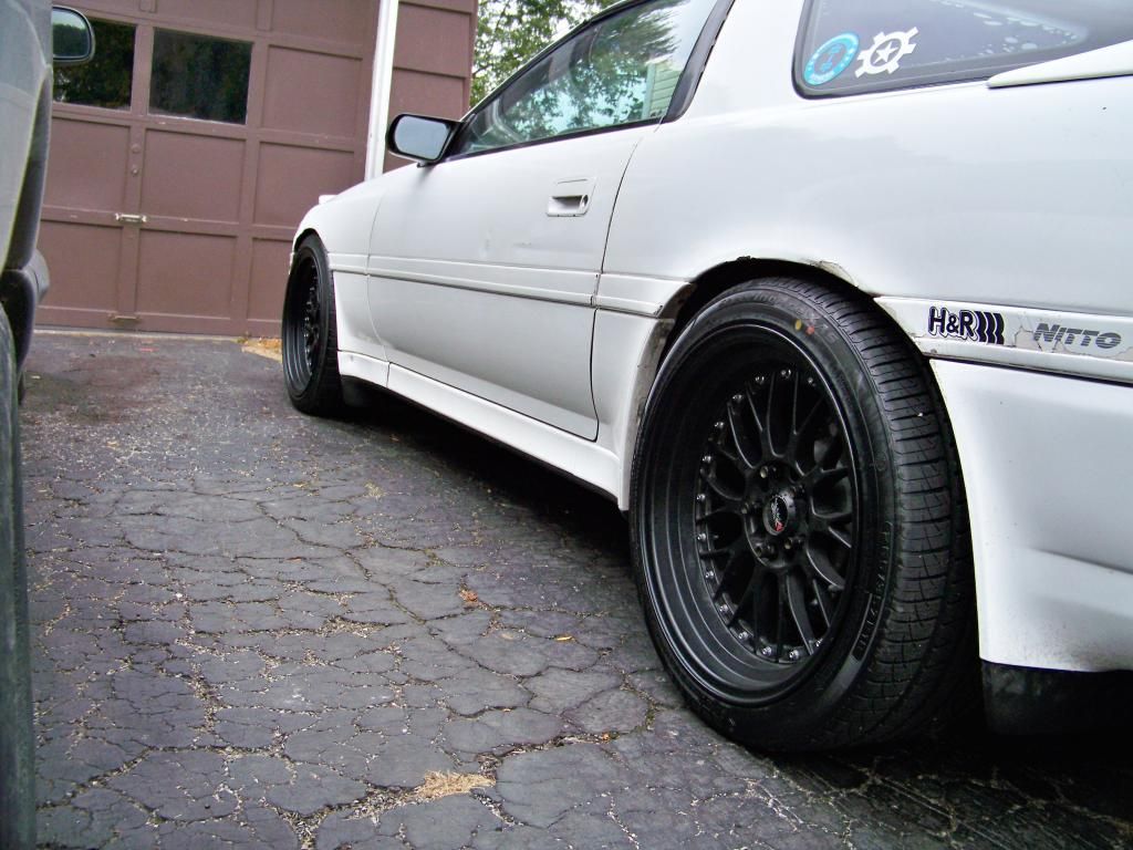

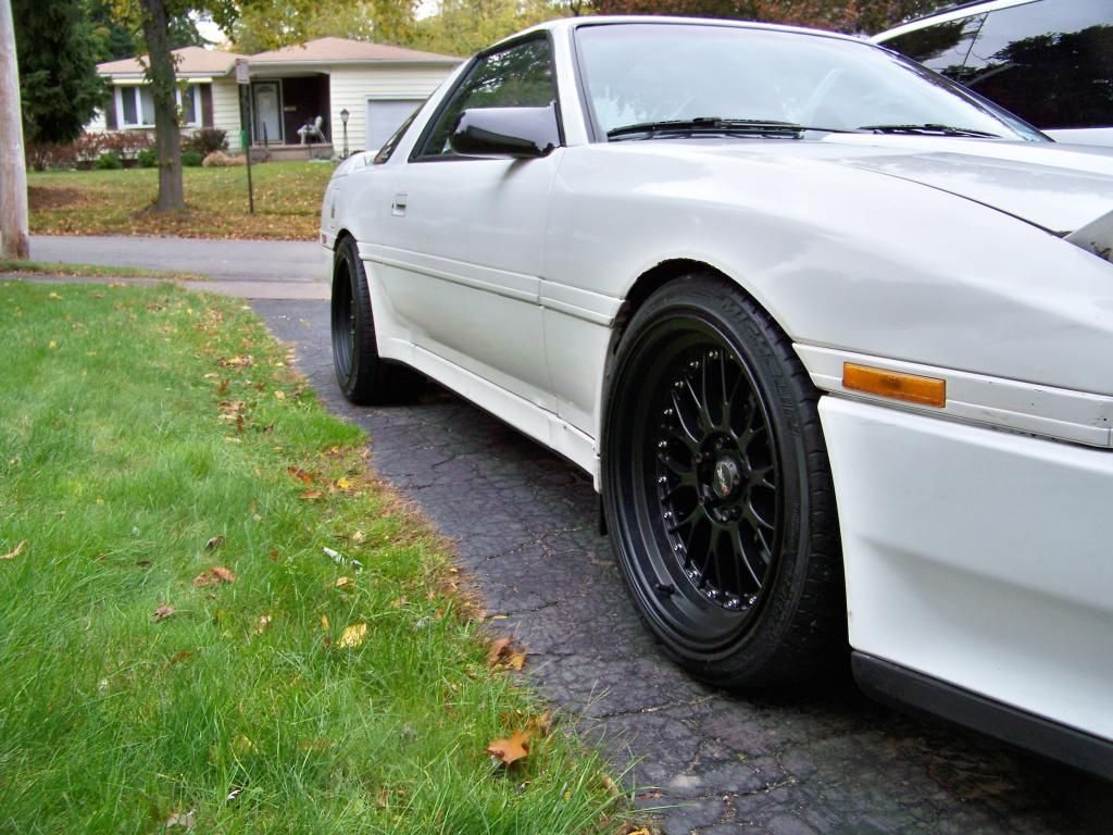

just got my new wheels on. xxr 521's. 18x10 +25 all around. :) 265-35's, but i'm going to do 285 30's in back this spring.
h&r race springs, kyb's, slight roll and a tiny pull. plenty of room.....
