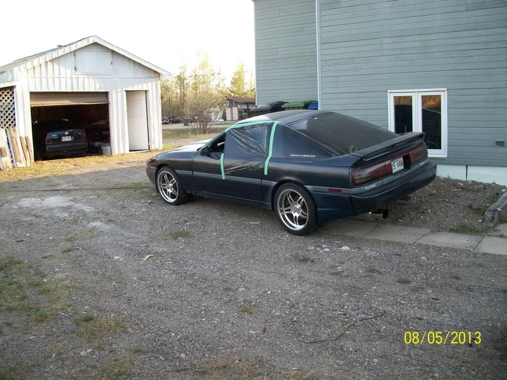

Tysan;1937316 said:Can someone tell me what size wheels these may be? I want car to sit just like this. View attachment 67098
Grandavi;1937351 said:Just ask Rodel, he's a member here and that's his beauty
This is the link to his build thread.. I think it lists his wheel sizes...
http://www.supramania.com/forums/showthread.php?128771-Notorious-M.K.3.
I think he rolled and pulled the fenders though.
