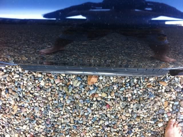

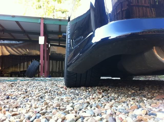

cool i was worried because i only have about 2.5 to 3 inches of ground clearance from the lowest point on the carSupraRzTT;1789898 said:Should fit alright with a roll. Maybe a lil pull up front.

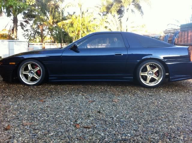

spiller;1788746 said:People say upt to 3 degrees negative at the front and 2.5 negative at the rear but you're car would have to be pretty low to achieve this with the stock control arms. What offsets are your 11 inch wheels at the back? You'll be cutting it pretty fine on the inside.
xzeror;1790588 said:pics ^?

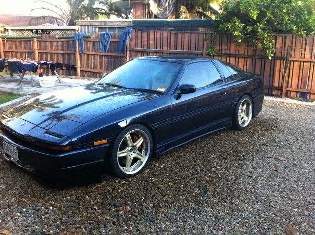

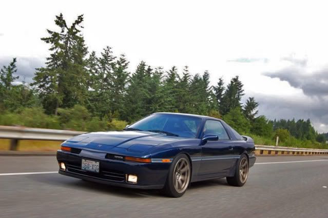

wobssorc;1771096 said:Test fit from a mates JZA80.
Volk GTC Gold.
Front - 18 x 10 +36 265/35 Tyres
Rear - 18 x 11 +35 295/30 Tyres (awesome for a70s!)

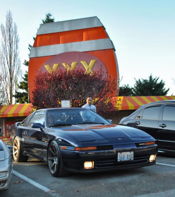

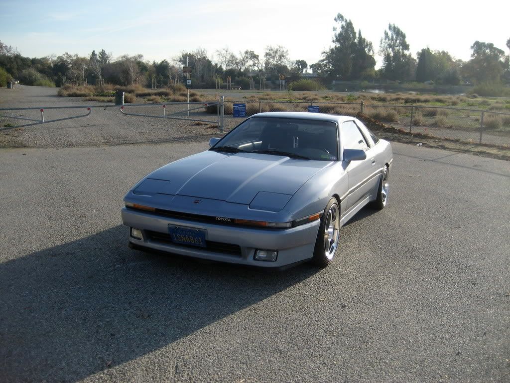

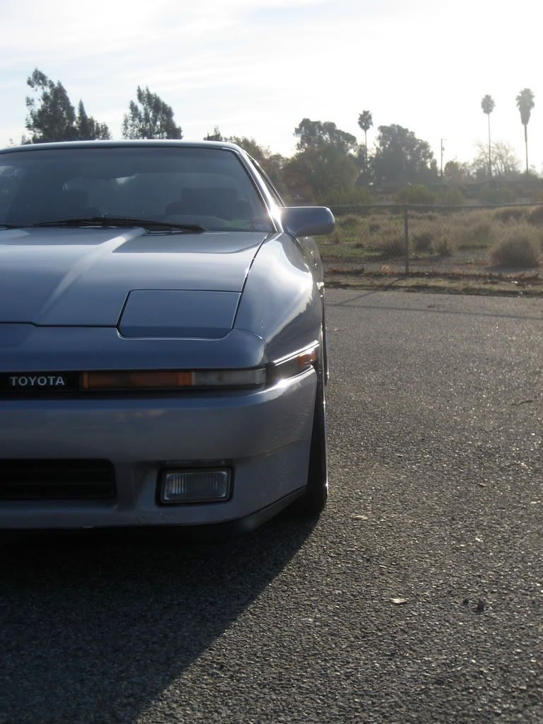

BorHor;855167 said:![]()
17x9+15 225/45/17 17x10+25 245/40/17
xzeror;1798429 said:Hey bor do u have more pics of this setup? or any aggresive setups with 17 inch rimsw?

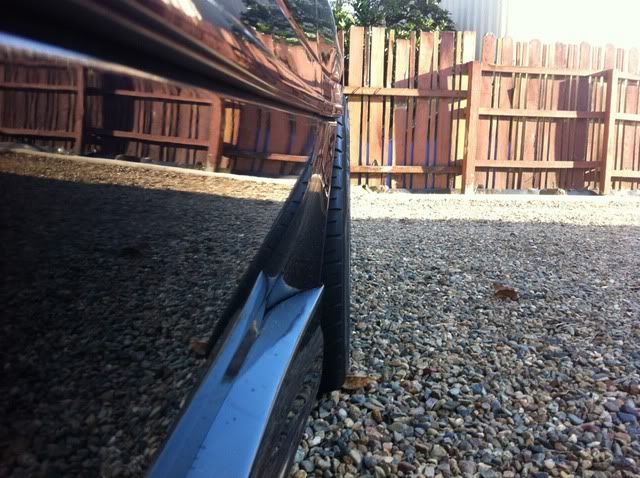

eltorodebull;1789811 said:
