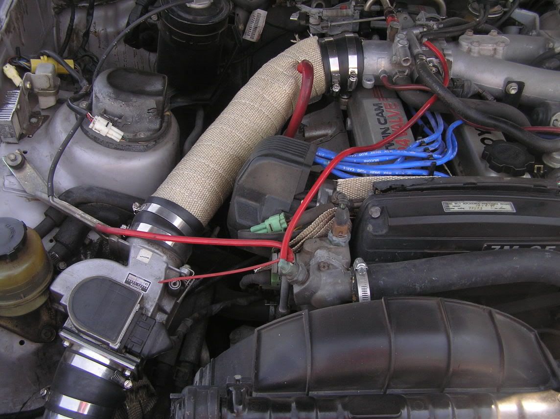

IMG]http://i71.photobucket.com/albums/i158/87soup/P8090048.jpg[/IMG]
:evil2:

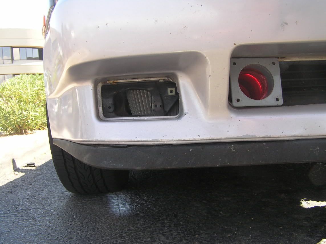

I am so glad this shit was put here, because I was thinking the exact same thing. Now...., i'm not. The filter has to be taken to the air or the air has to be ported to the filter. I def. want to keep my fog lamps. I just don't want to run them if I'm off the leash.

Sl1dewaysSupra said:
^^^Looks good, what did you use to attach the hardpipe to the AFM? I was going to do that setup, but I had to use the stock rubber part because of the vaccum line running to it.

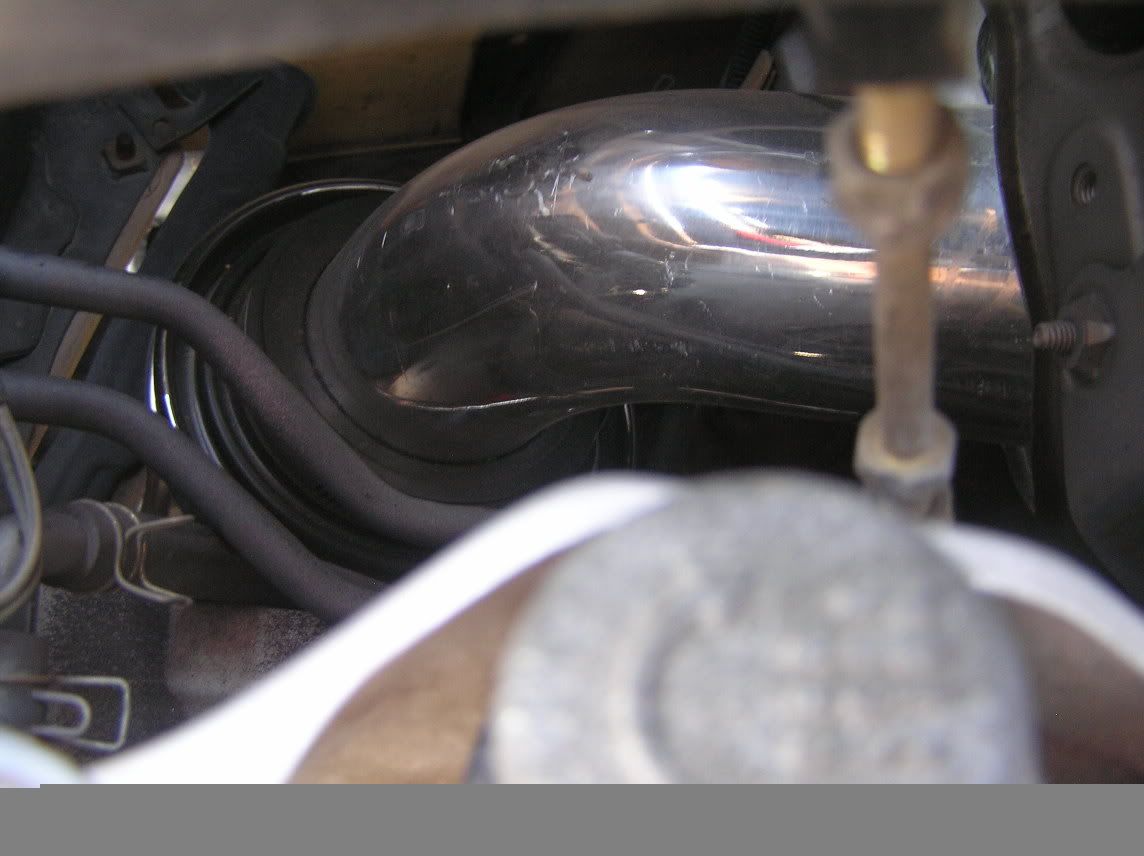

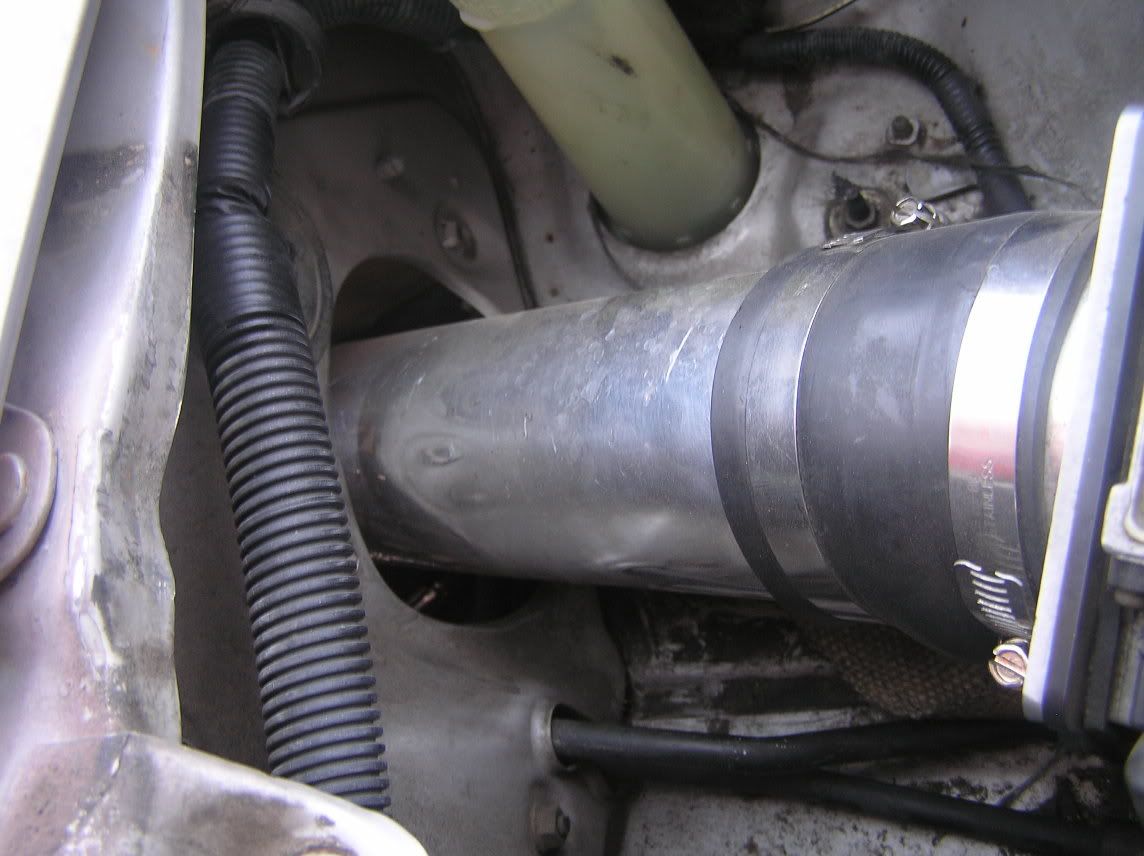

When I did the FIPK of coures I got rid of the airbox completley. I made a heat/water sheild around the filter. If you look through the hole where the snorkel was you can see directly to the plastic gaurd on the under side of the car. I removed that and cut out the section by the towing brackets( If you are laying under the front of the car and towards the middle of the car, look to your right and you'll see the towing brakets. The plastic gaurd is flat until it comes towards the middle of the car then it slopes up I cut that whole up-slopping section out.) I went to the hardware store and bought 4" dryer ducting(the shiney silver flexable stuff) and a floor register w/ a 4" outlet. I ran the dryer ducting through the hole where the snorkel was and ran it under the headlight(make sure to be careful and don't snag it on screws etc. it WILL TEAR easily if you don't pay attention to what you are doing) and cut it CLOSE to the size I needed. I shortend the floor register so it would fit between the grill and radiator. I mounted the register to the lower grill and pulled the dryer duct as straight as I could, trimmed it and attached it to the outlet of the register w/ a 4" hose clamp. It is kinda ghetto but it is simple and cheap to replace anything that breaks. It isn't nearly as complicated as it sounds, once you get under the car and start looking around you'll see what I'm talking about if you don't already. Whew that was longer than I thought.
