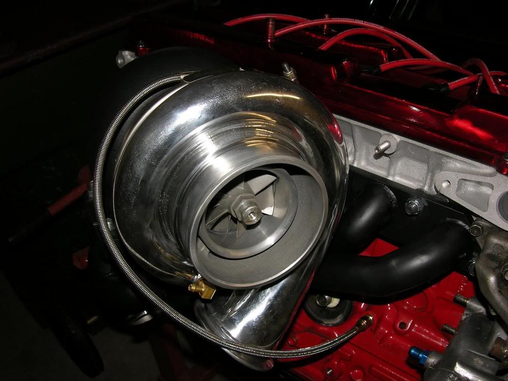

i have been holding this for quite some time. Beside BCG04 and IJ. knowing, no one else did.
so without further adieu, the beast in all of its glory :)
http://i27.photobucket.com/albums/c1...othedblock.jpg
http://i27.photobucket.com/albums/c1...uwx/Tial44.jpg
http://i27.photobucket.com/albums/c1...2jge_plugs.jpg
http://i27.photobucket.com/albums/c1...4202R_Rear.jpg
underneath all that paint (which mind you block prepping alone was nearly 12 hours of sanding and polishing. Yes you heard right polishing. I used http://www.sa-motorsports.com/blkdiy.aspx as my guide :) )
Stroked Crank which is knife edged and zero balanced
Pauter custom Rods
Ross pistons with a 9.0:1 comp ratio.
Oil pump was shimmed and the oil pick up was dropped by .25" inch.
Sound Performance turbo kit with a Garrett GT42RS (or better known as GT4202R or GT4576R)
4 inch Downpipne and midpipe.
Ron Ramirez Front Facing Intake with Mustang TB mount
2006 Corvette LS2 DBW 90mm throttle body and pedal assembly
Motec M800 (for those keeping tab I was 2nd then came Duane and finally IJ.)
Motec CDI-8 (yes the cream of the crop in CDI world)
Mercury Marine Thunderbolt coils X 6 (Only the CDI-8, M&W and Autronic can push these, anything else gets fried ;)
ATI custom made 7m damper (Yep I was the one that got this ball rolling for all you 7m fanatics ;)
PowerHouse Racing custom fuel rail (-08 in on both sides, no return as the return is located about an inch from the fuel pump in the back ;) ).
880 cc/min PTE injectors x 6(have to go to 1600cc/min because of the E85 requirements)
Weldon 2345 Fuel pump (2000 hp on gasoline, 1000 on alcohol)
Weldon 2040 regulator
Carbon Fiber TitanMotorsports Driveshaft
SouthBend Feramic 6 pucker on a Unorthodox Al Flywheel with steel insert.
Fuel = E85 daily.
body, still a crap shoot but one thing at a time ;)

forgot to mention. This is a 3.2L engine. Me and adjuster ordered at the same time :)
This head is still stock. There is ANOTHER head that I am doing the figgie treatment to (ie OCD on everything, lol).

within 15 minutes of starting, power will be produced. break it in the only way.... ;)
btw
those red wires. Magnecore (another fine aussie product) that were based on the 2jzge na plug wires. The end without a fitting on them is to connect them to the Mercury Marine coils.

still a bit. Need to clean the engine bay and do a FOD check (make sure no screws or anything is left in the engine bay).
Once that is done I am custom making my own hose from XRP HS-79. Which I bought all the crimpers and crap to do. That means if someone needs hose, I can get you them but they are not cheap!!
http://www.jdaent.com/desktopdefault.aspx?tabID=5546&pCatID=812&CatID=1020
that gives you a rough idea on hose alone ;)

PTFE smooth bore. state of the art. light as a feather (.4 lbs per foot for the -06 stuff)
THis is no longer a Toyota Supra. Nothing except the shell and the physical block is from toyota ;)
Forgot to also mention.
Megan coilovers right now with the stock megan springs. Getting some softer ones for taking it to the track here.
